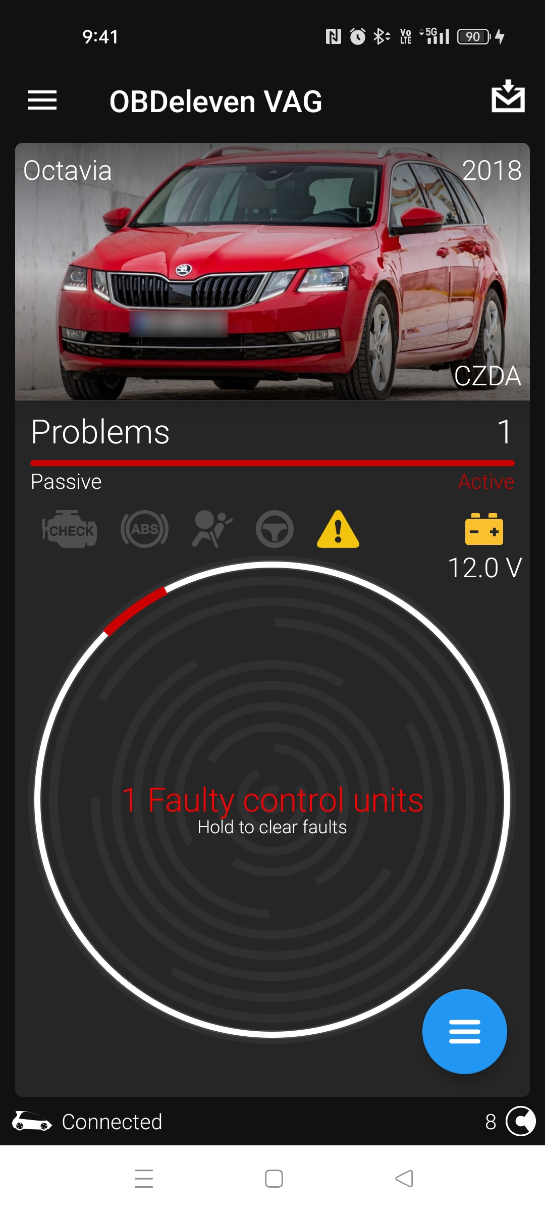

OBDeleven is not connecting with the device from today. I tried to rescan to delete the error of misfireings which wasn't deleting yesterday. I sent email to the custoemr care dept for OBDEleven. anyways, I tried everything, I mean my ac/fan/mobline charging everything was off, but still it didn't work for start-stop. yesterday the fault was not even deleting about misfires...so I was guessing if the misfire is genuine or not and if it is the case for start-stop being not working!
NB: I forgot to add something. As i had my dash cam connected with the mains in the house, i never saw it switched off which is not the case in the car..in the car if it is long drive, i can see the dash cam goes off. so does it mean my alternator is not charging the battery and therefore dash cam can not have enough power supply. The halfords guy said alternator kicks in after 1-2 hrs long drive.

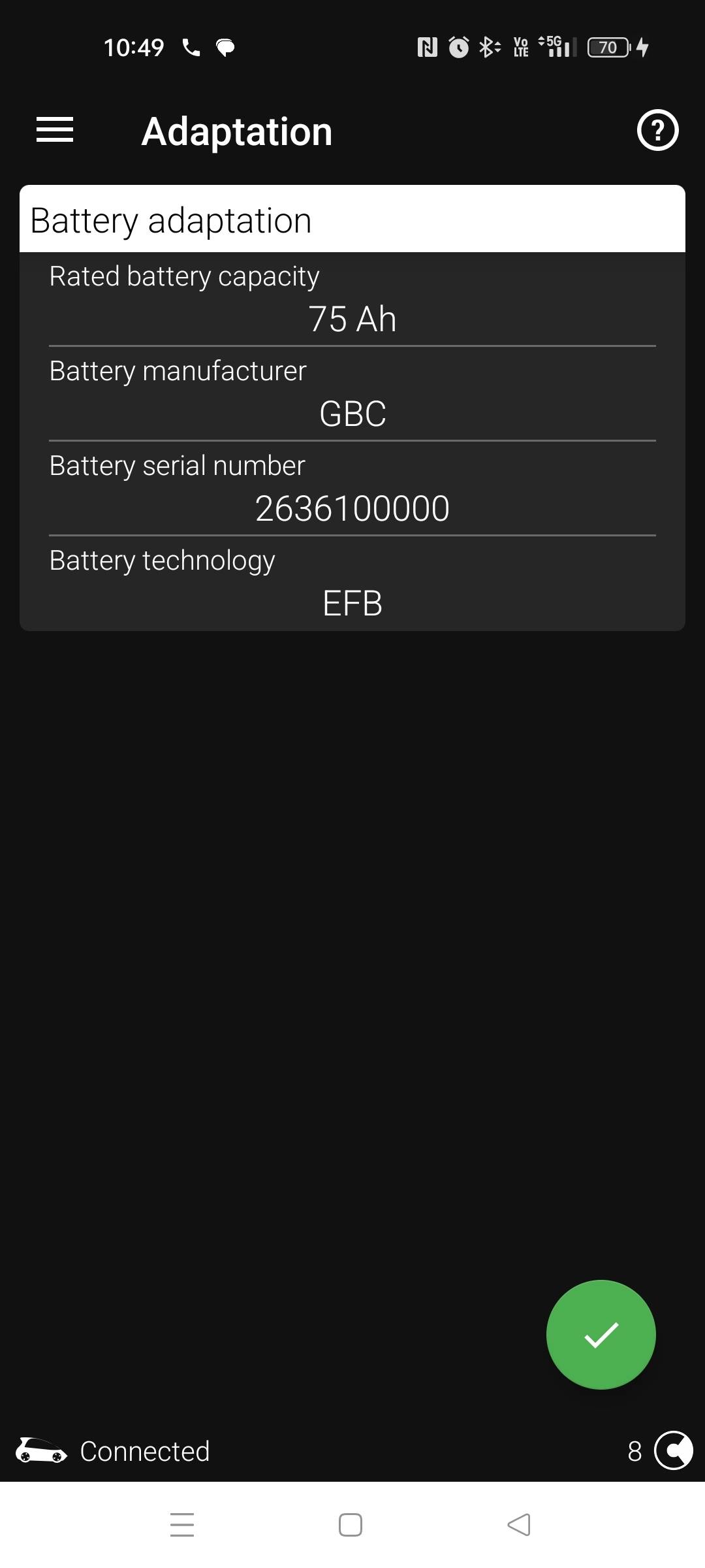

Screenshot_2023-08-31-09-33-16-36_e12f25f1a1eef3fba9ad2471f7cb9c73.thumb.jpg.4a59a99a19aec38571a2adab048cc335.jpgI have found how to code battery by OBDeleven. Information there I can see, seems wrong to me.

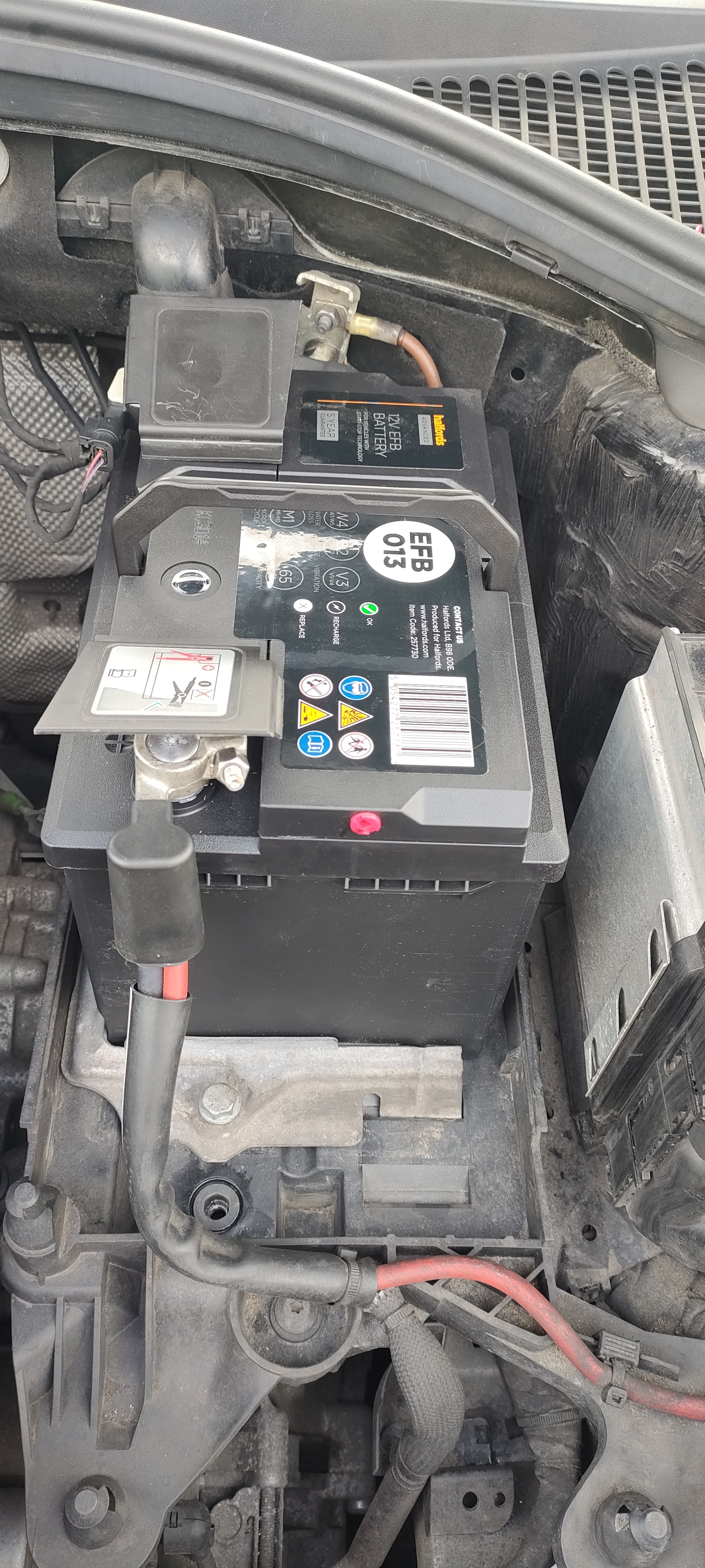

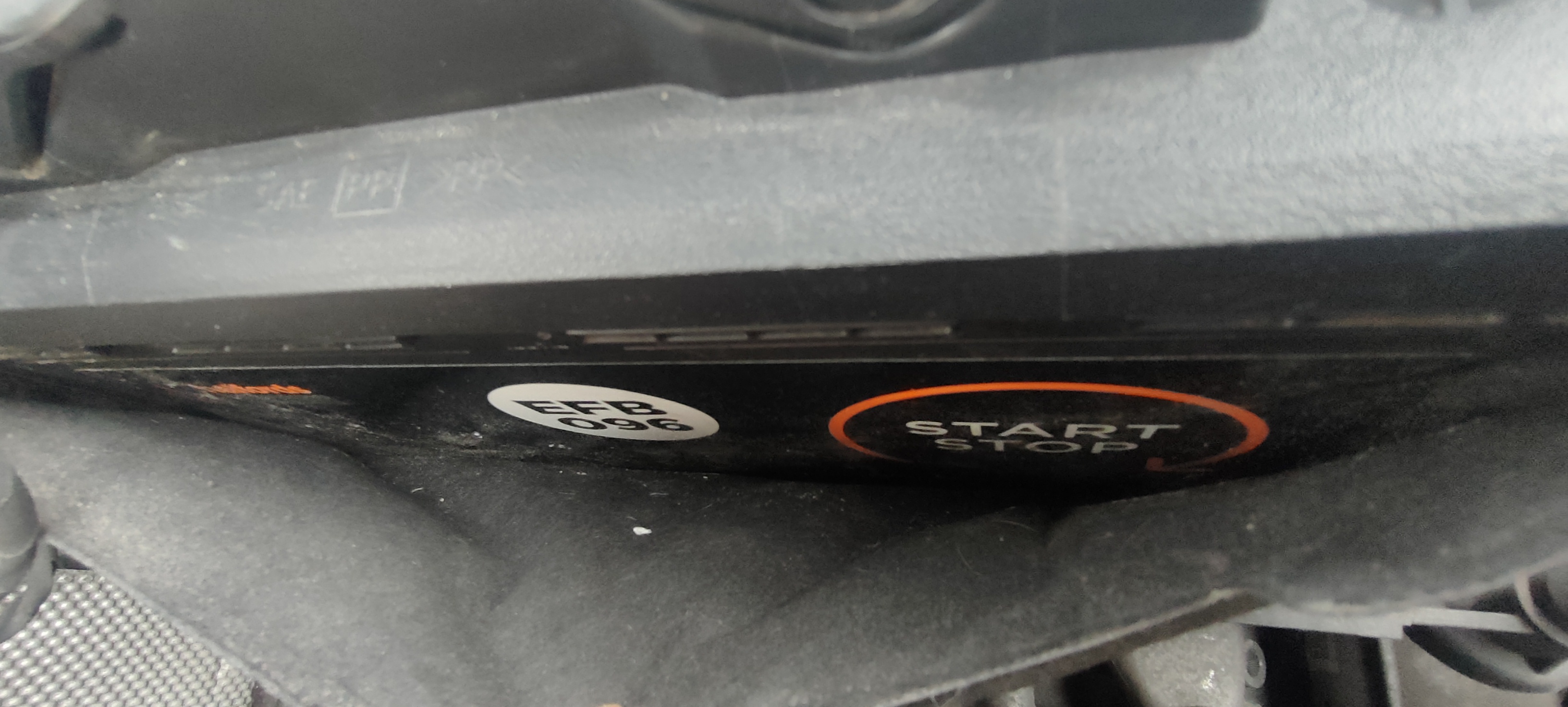

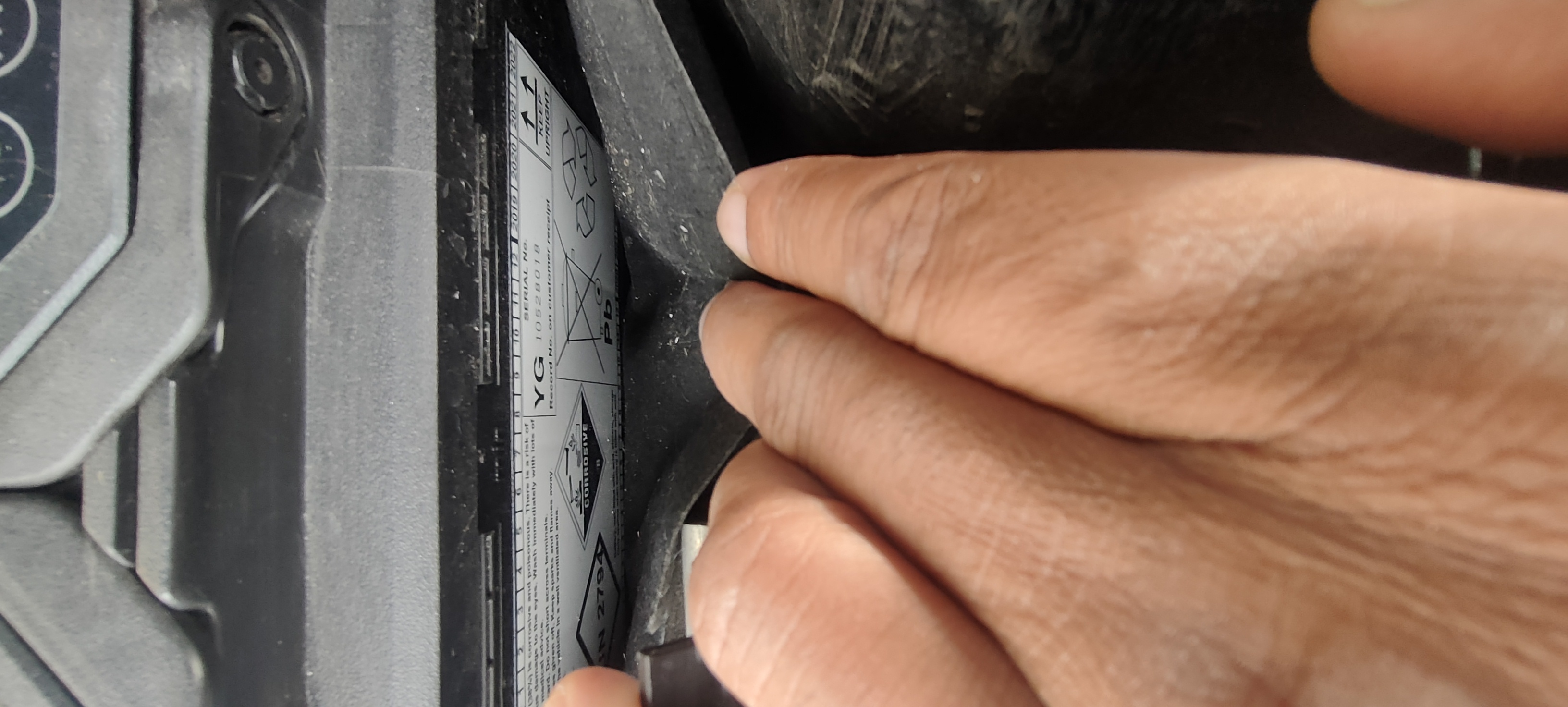

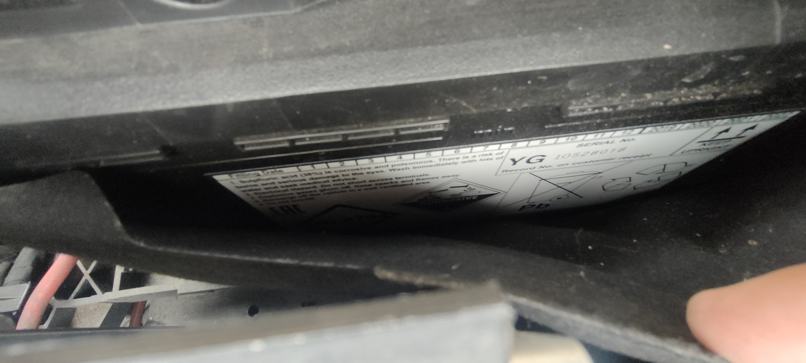

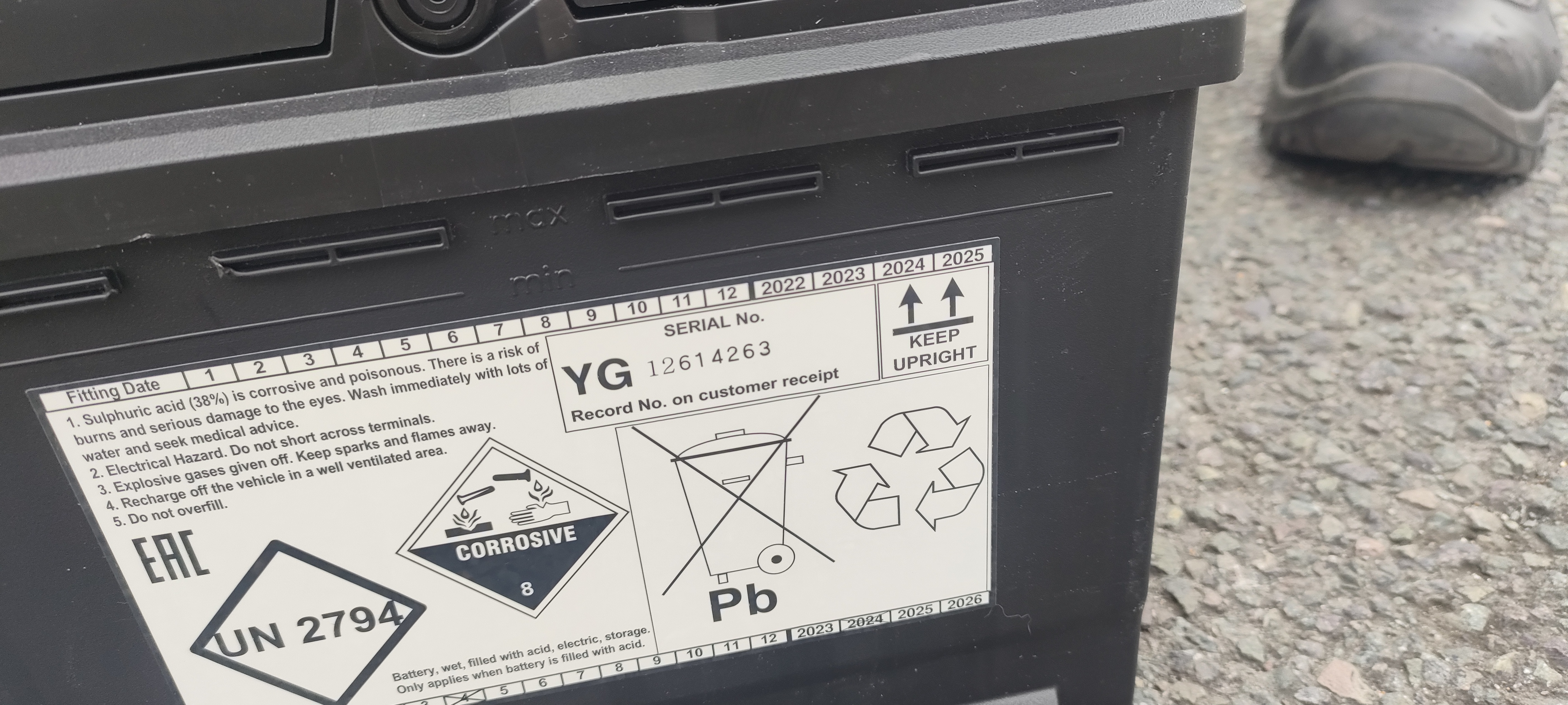

Especially Rated battery capacity..it says 69Ah, but my battery capacity is 75Ah, Serial number i managed to check from the side of the battery is 10528018, but in the coding is totally different. battery manufacturer i am not sure. Could someone check if the coding/info is right or wring.
The battery i bought was EFB096 from halfords .

If you can't find the makers details etc, just change the last 2 digits of the existing code number and input the correct Ah rating and save the settings. The digit change is enough to make the system understand the battery has been changed.
Edited by Graham Butcher
So, do you think battery coding is wrong or somehow it went back to original battery coding i had previously?
It clearly was not saved to the systems memory.

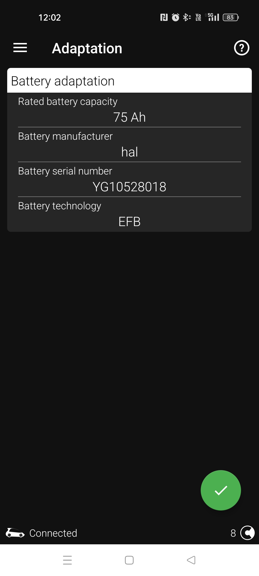

Screenshot_2023-08-31-12-02-32-12_e12f25f1a1eef3fba9ad2471f7cb9c73.thumb.jpg.226208b71d076b1706af950536ac4d00.jpg
2 minutes ago, automass said:
New code has been accepted.
I'd check it after a day or so that it's still showing the correct details.
If the system thinks it's got a 69Ah battery, then it's possible your 75Ah would never be charged enough.
It seems start-stop working perfectly fine now and checked the coding couple of times after restarting the car each time. Coding is not changed. I think during the jump start coding has been changed as someone said in this thread that negative terminal has not to be connected with battery instead in metal in the car.(I'll remember this for the next time). or may have been halfords guy didn't do it properly.
I also scanned the car, no fault code was detected (cyl 3, random cyl misfire etc).

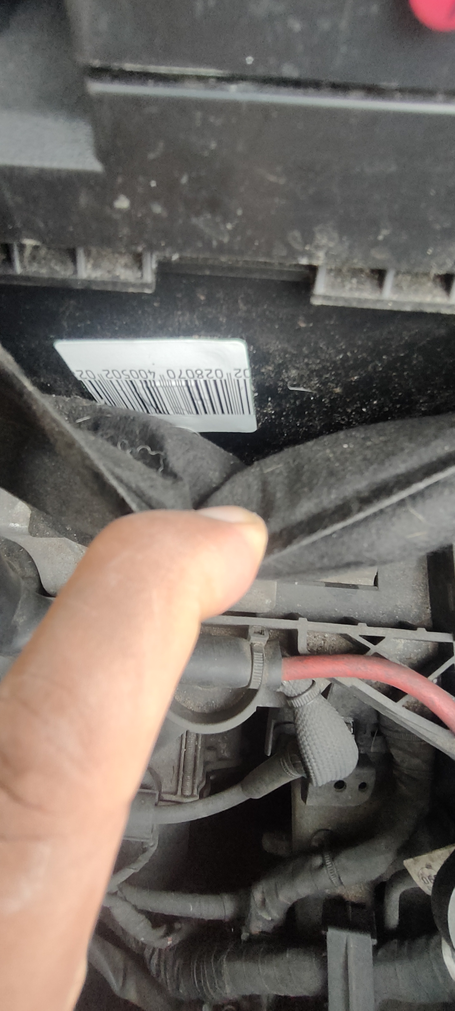

Unplug the shunt resistor and revert to a standard alternator charging profile which will also disable start/stop and all the regenerative charging Bravo Sugar.
