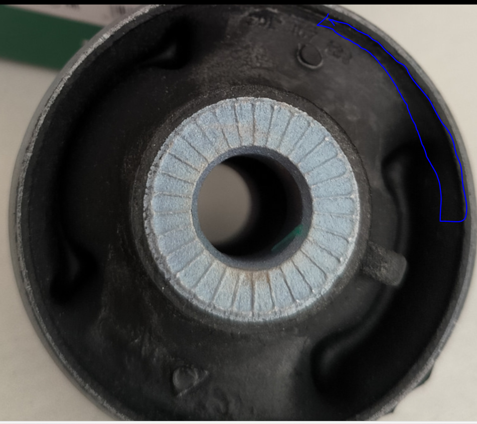

Screengrab of the clearest shot of one of the bushes:

Don't think that vulcanized & pressed-in bush can simply "come out". Outer metal casing still sits normally in control arm.
Maybe it's just a strip of rubber (nearest to outer edge) which crawled out? It's not main meat of rubber which holds the load.
But this can indicate beginning of end of bush indeed. Photo below, blue marking.
If there's no extra movement with pry bar then main vulcanized part of rubber should be plusminus ok.
As per noise, those bushes squeaks and (if it bothers driver too much) there's Technical Bulletin about greasing of void places of bush.
150'000 km / 6,5 years on nasty Latvian roads: my bushes still are ok and with no reason I don't even look at them.
And yes, they squeaks when driving on speed bumps.

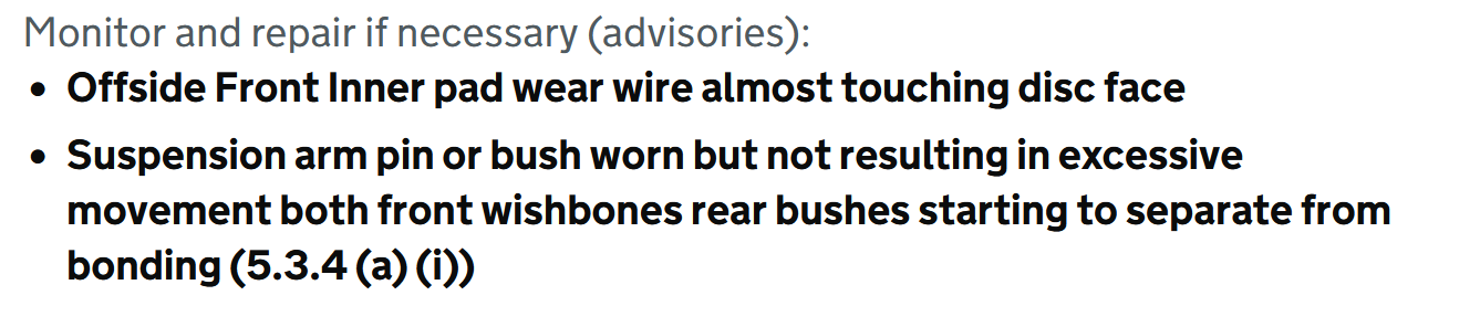

Thought I'd resurrect this as I had the car MOT'd earlier. I did indeed get an advisory for the bushes along with exactly the same advisory for front pads I got last year. Which is odd as they were only 30% worn at the service in September 🤷‍♀️
Dealer (Marshall's - wouldn't normally go there for a MOT but its included in the service plan) was quite chill about it, blaming potholes. Didn't try to sell me new wishbones or anything.
I don't think that's warning you the pads are low.
To me, it suggests the wire which connects to the pad wear sensor is very close to the brake disc. This means it may occasionally touch and get damaged, might be worth taking a quick look and seeing if it can be zip-tied away from the brake disc :)
Oh yeah, that makes more sense 🤣
That's the problem with taking it to the dealer who takes it to the MOT garage. I don't get to talk to the tester. Odd they never mentioned it / sorted it at the last service. I guess that's what you get when everything's on a checklist 🙄
I can't edit the previous post but it turns out that's exactly what it is. Whipped the wheel off earlier. There is nothing where it shouldn't be but the wear sensor on the inner edge on the inner pad is actually almost touching the disk face .You can barely see it, amazed the tester reported it, twice. I guess that's because the pads are almost actually due for replacement. They're down to 3 or 4mm so maybe the dealer meant there was 30% left at the last service 🤣
