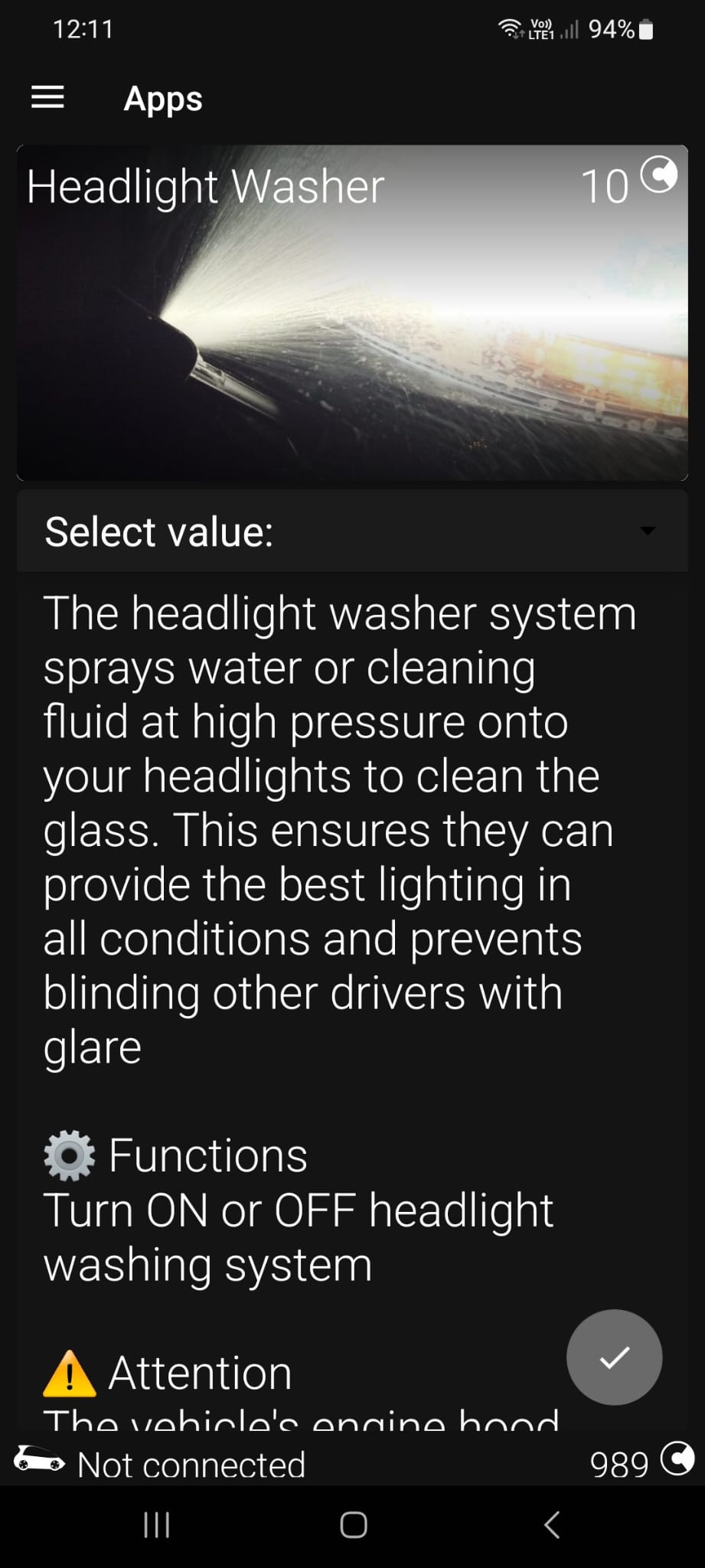

There's an App in OBDeleven alowing you to turn off the headlight washing.
There's also another topic around here (coding-related) where someone was posting that it is possible to code some DELAY for the headlight washing system - so it will only start if you wash the windscreen for more than several seconds...
Yes, it was certainly possible on the Mk3 to set a delay of up to 2 seconds before the headlight washer activated.  I’ve done it myself. Never changed anything on a Mk4 so can’t say how to do it but I’d imagine it’s possible.

Thanks everyone!
Going to try to the OBDeleven option on the weekend and see what happens. It kind of sucks that you need to buy credits to actually use the device you already bought… but 10 credits are only $5 so I can live with that.
