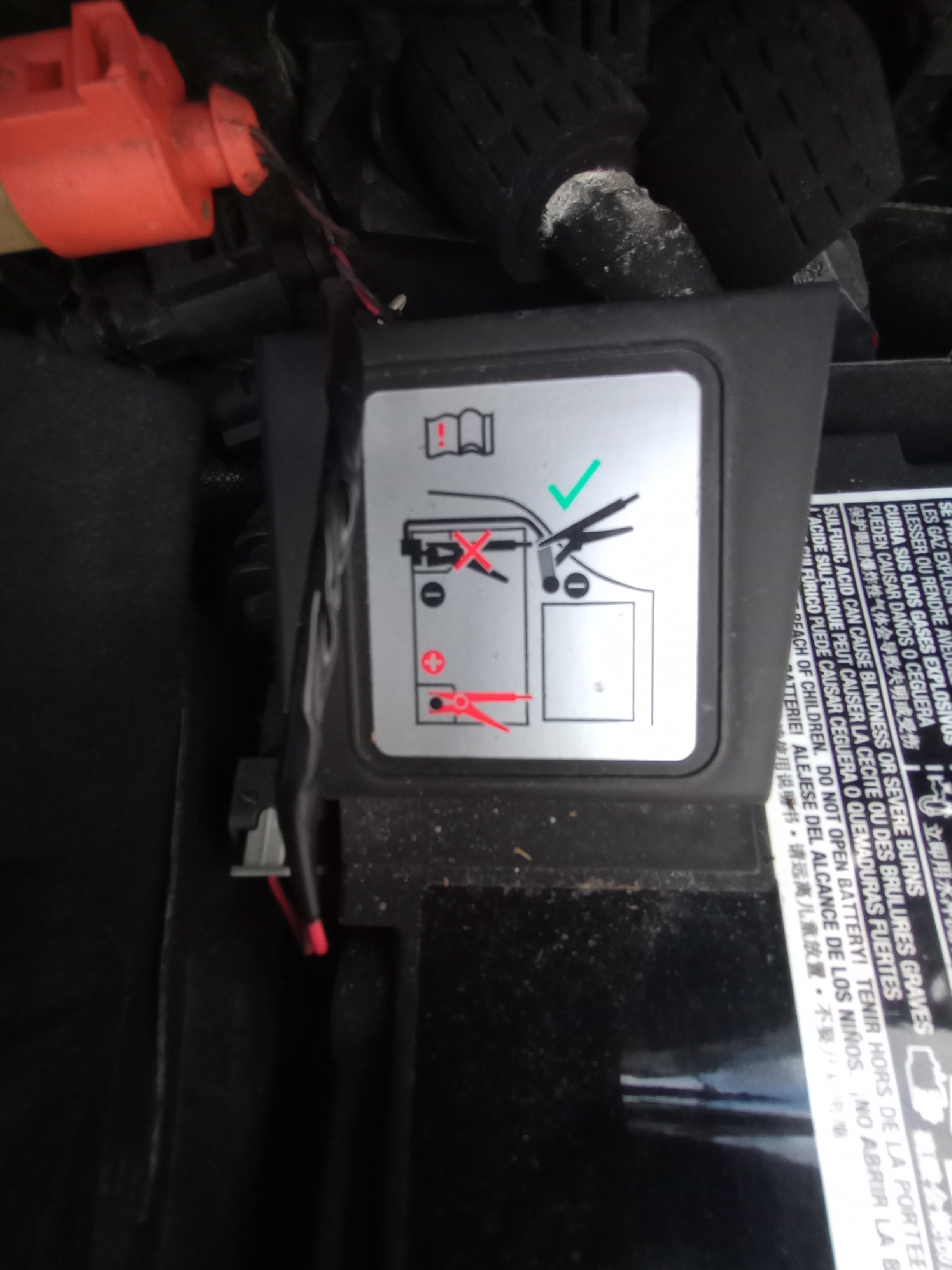

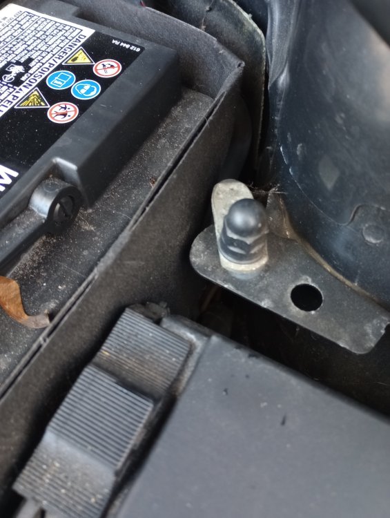

Both French PSA group vehicles, both had inaccessible battery negative terminals and battery covers that can not be removed because of having fuseboxes integrated and wiring looms  with no give, I have no idea how you could ever get the battery out, neither of them had a connection point for the negative jump lead other than flimsy bits of tin that were not even grounded.
Anyway the first started after a charge and I drove to where the the first one was abandones returning from town and got it started with jump leads attached to the exposed +ve terminal and the top engine mounting bolt, I then returned to pick her up and drive her to recover the vehicle.
It wouldn't start again so out with the jump leads again and of course it started raining, got it started and she complained that the power steering was heavy, normal I guess with a flat battery and perhaps the alternator was gone, then the electric handbrake refused to release so having got the car running there was no way it could be driven.

Ps. Later type cars will not let you use the -negative terminal for jump starting.
You need to go to a part of the engine or chassis.

Plastic casings over everything other than flimsy ungrounded pieces of tin, only possibility was a bolt on the engine mount in front of the cam belt at the other side of the engine bay.
Been thinking about how to recover it today, I suspect alternator failure because the power steering and handbrake release would not function even after it had been revving for a few minutes, I think we will have to remove the battery, charge it fully and refit it for the 5km journey, trouble is it looks virtually impossible to remove all the plastic crap and circuit protection enclosing it without dismantling half the vehicle.
Many many ways to get the vehicle home even without the engine running but with the handbrake locked on its a recovery truck job and even then it can be winched on but getting it off will be a real challenge.
