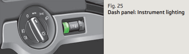

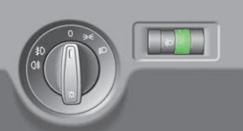

My manual writes about setting the brightness in the "lighting and visibility" chapter, no idea how this chapter is actually called in the English manual. Page 60.
It says "When the lights are on (excluding DRLs), dashboard lighting brightness can be adjusted in the "Infotainment" system (and then has a direction to the infotainment manual).

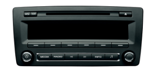

Assuming the radio is this style of Swing:
I wouldn't expect it won't have any settings to adjust the brightness.
If anywhere, I'd expect the adjustment to be next to the headlight switch on this age/platform:
However, as the 2013 owners manual doesn't mention anything. I expect it's 'automatic' and no user adjustment can be performed 😞

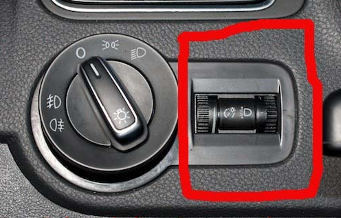

Pretty sure that will only effect the headunit brightness and not the instrument cluster etc.
The switch alongside the light switch is to adjust headlamp height when carrying a load
Yes - I am aware of that ;)
I was just saying that if anywhere - that's where I'd expect,. For example on this VW Polo:
You can probably retrofit it but you'll likely need to add three wires to the BCM and possibly recode it.
