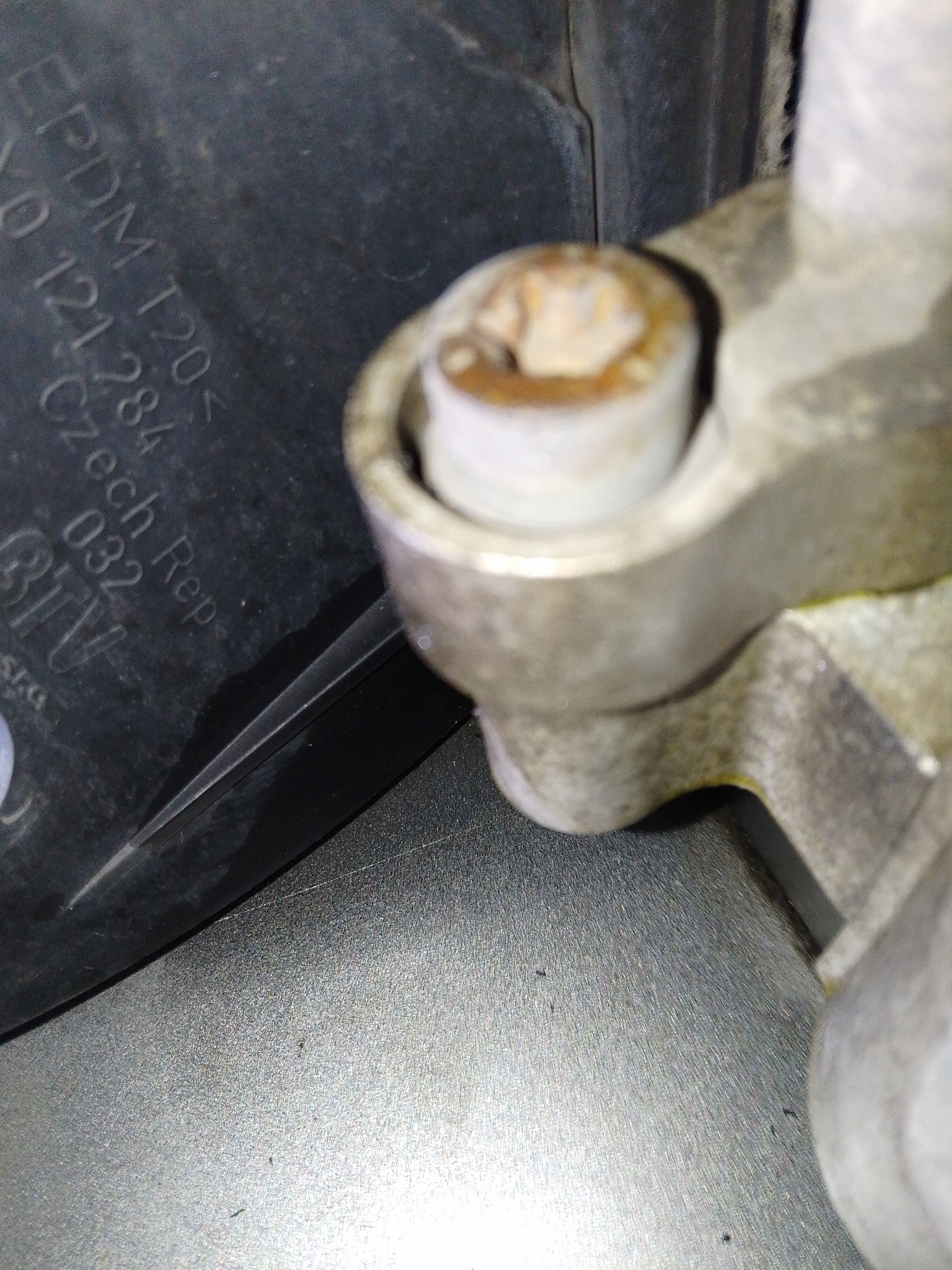

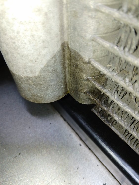

I have noticed some green fluid on garage floor. A bit guey too. I had a look under car and there are green drips under front bumper. Condenser looks ok (no exterior holes) other than it is wet at bottom front right of it (driver's side, UK). The union at bottom seem suspect.

New condenser and new o ring seals? Anything else to pamper the car withIMG_20231112_105733.thumb.jpg.901b2cc2aee187abca1bac07bfdb9603.jpgIMG_20231112_105714.thumb.jpg.6639a2701594c79cb5f5dda148f21ff4.jpg? I found a lot of bolts, brackets were rusted and 'obsolete'. Even a radiator hose (most common fail one out of thermostat was a 2 week wait).

I had a read of post below. Pete you mention the dryer unit should be replaced. I understand a new condenser comes with a new dryer? Given I have leak on the union, could it be that the dryer dessicant in need of some TLC, ie replacement and a new union o ring? I think the condenser is not leaking itself.

Your leak looks to be near the pipe join, but the dryer seal is at the top of that side 'tank' bit, I believe.

Hi Pete. I have had a look and the black frame around the engine bay can be removed (held by torx fasteners) to access the large torx fitting vertically? This sits top of the condenser, front right side / UK driver's side. Is this the location of the dryer?

I would just replace whole condenser.
