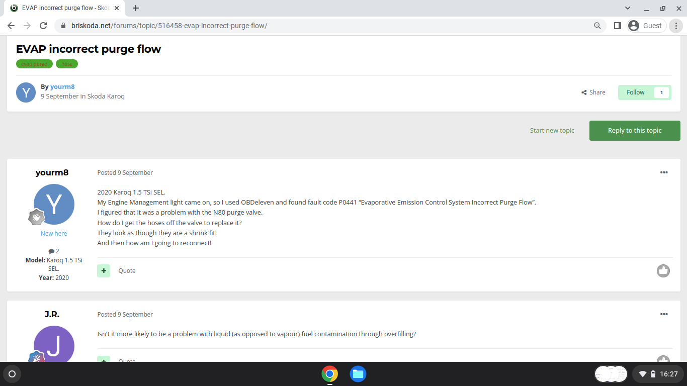

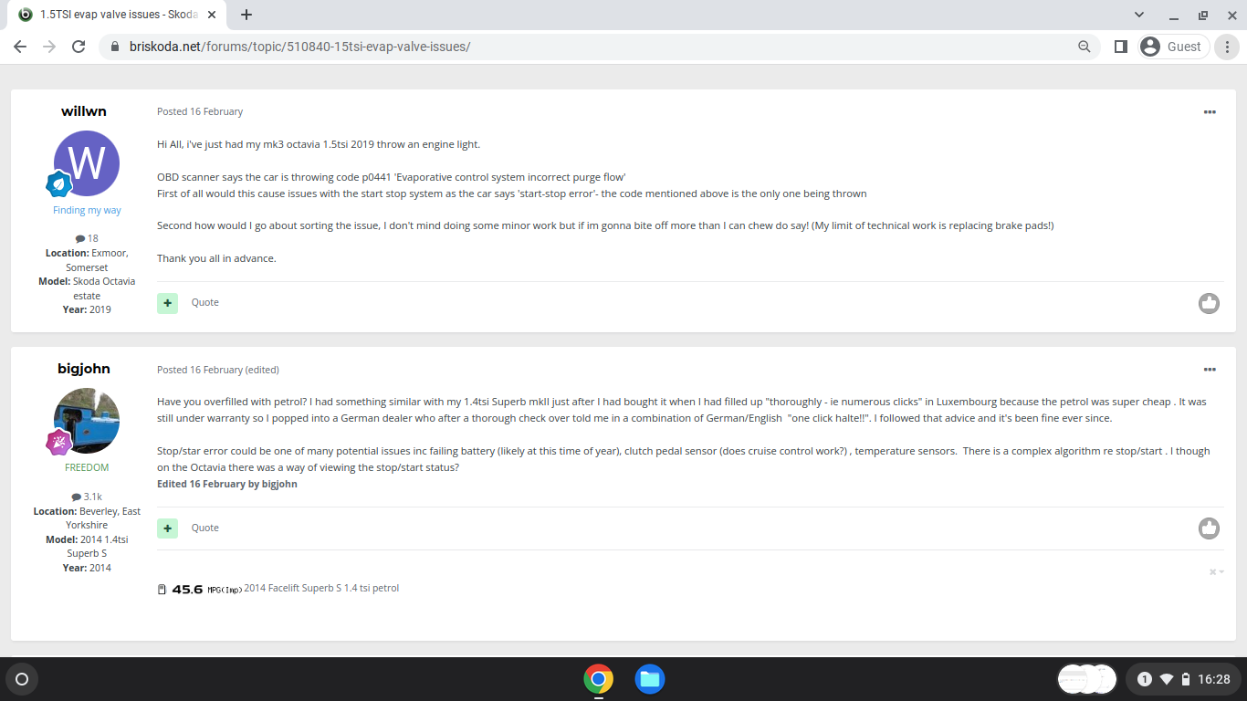

The various other threads seem to be the same thing.   About half a dozen no various models.
So was the tank brimmed and as simple as that.
