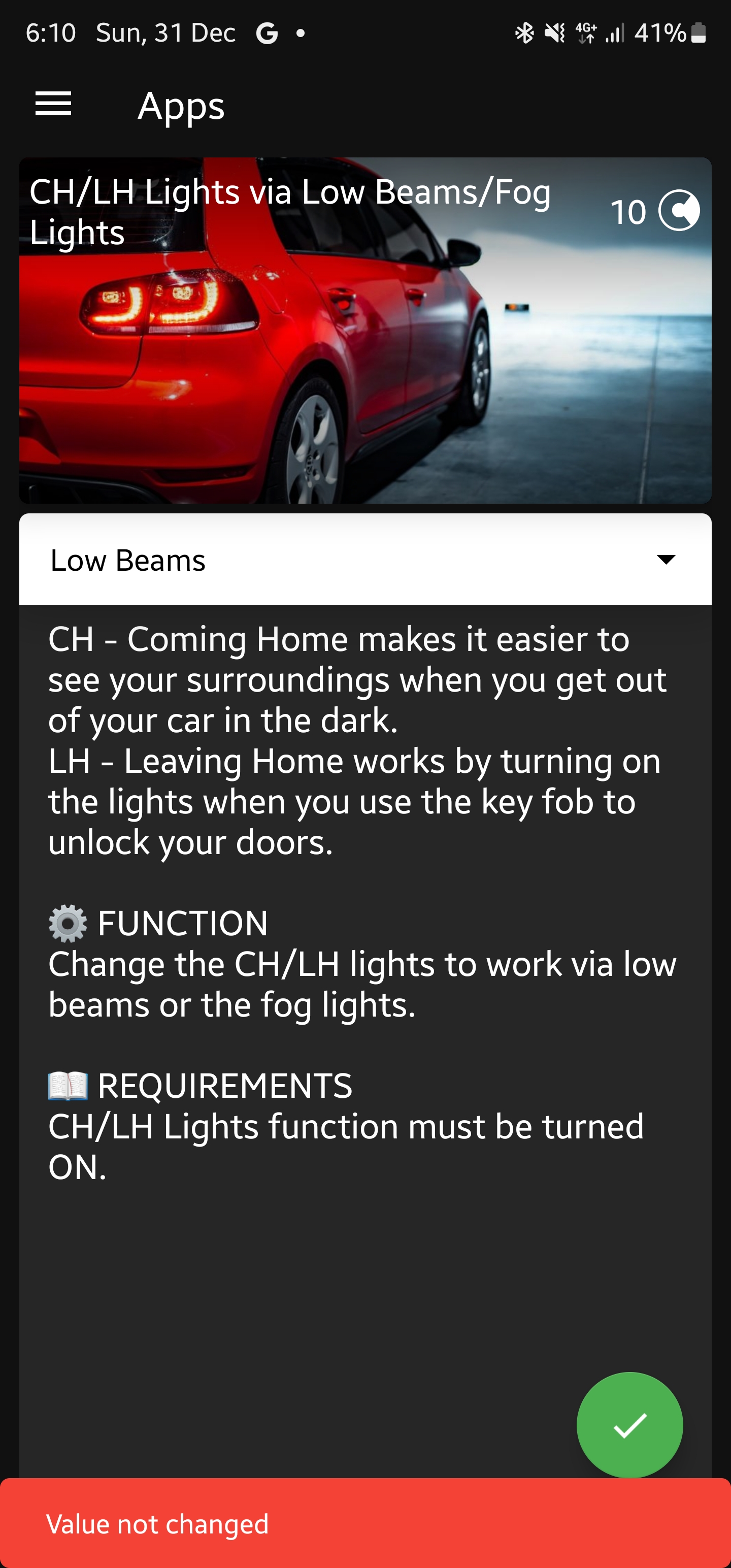

Maybe this can help?
I think that's exactly what I'm looking for! will check it out when I'm in the car later. Thanks for your help!
I had a look earlier but it says I have my low beams already enabled.
I don't have fog lights installed in my car so I wonder if I select that will it work?
Yes normally you should select the low beams function.
The other one should not work even if showing any info message for not having installed fogs.
