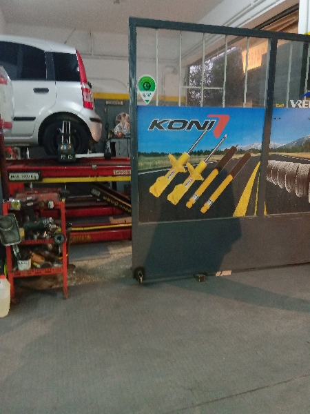

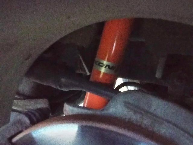

The Koni were on the 3rd (last) scale,i pass the MOT few months ago with no problems but wasn't happy no matter if it was in City (potholes-small rails) or in Highway (after 130 Km) so it was to for a change or total repair.
I choose the 2nd and i went to the official Koni Service here which uses original Koni parts and gives 1 year Warranty.
Example from Uk
https://www.koniuk.co.uk/about/service-repair
According to the mechanic: pistons, teflon, O-rings, oils plus gaskets (especially those in rear were in not good condition) plus Alignment, the total cost was 250 euro or 217 £ (nice price because i am nice guy).
It's too early for impressions, of course there is a huge improvement in City roads plus on emergency traffic brake but the speeds are low.
I am a bit cautious, the real test in few days with Highway and Mountain Roads turns that i love.
Sorry no photos from the step-by-step work.
