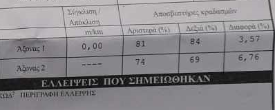

These ARE THE RESULTS OF AN 8 YEAR OLD STOCK suspension, which costs 1/4 of the price of the (s)koni  offers greater comfort, maximum safety, while not altering the originally engineered design kinematics.
The test was done (YESTERDAY)
KYB EXCEL-G dampers (F+R)

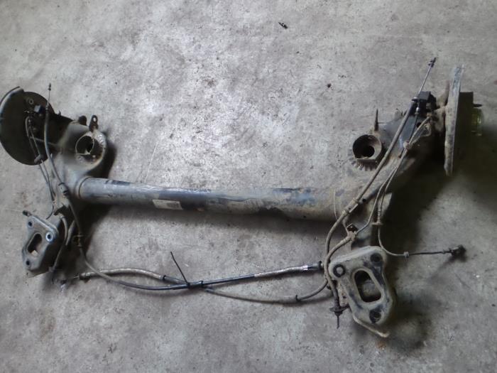

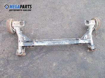

If you see the mounting location of the rear dampers you can easily notice they are th furthest away from the pivot axis sooo to give the maximum effective spring rate with the least actual spring rate, so save money, very clever and in fact very modern engineering as a combined coilover type design.
6 hours ago, Papez said:
More like barely working, but expressive and relatively safe. There's reason why track vehicles were based around Pickup with its stiffer rear axle.
The biggest drawback of the felicia rear axle geometry is the position of the mounts which are placed totally perpendicular to the direction of travel (parallel to the twist beam) meaning you have trailing arm kinematics alas no toe recovery.
Modern twist beam axles have semi trailing arm geometries to offer better kinematics and it's achieved my placing the mounts at an angle.
