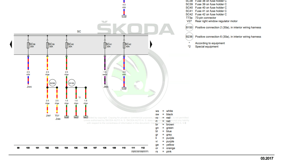

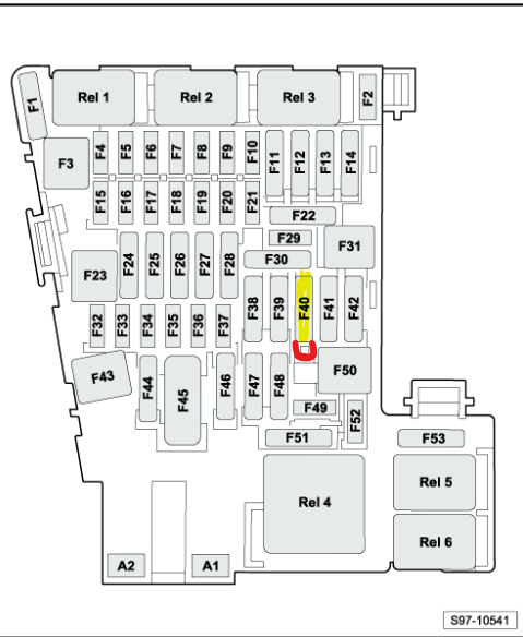

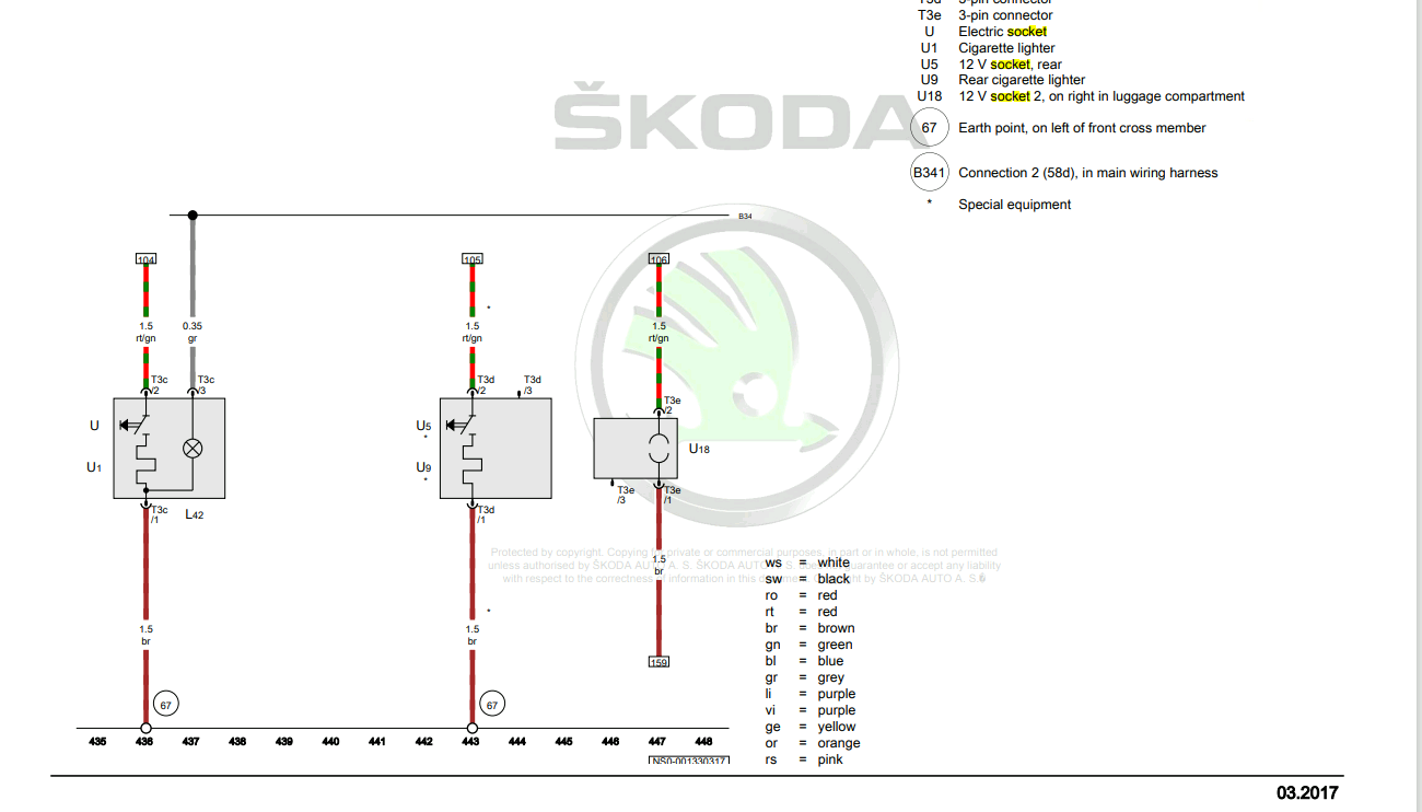

Look at the fuse box behind the glove compartment..  The fuse for the lighter circuits (can't remember the number).  You'll see this fuse holder position is slightly different than the nearby ones, there is a 2nd position where you can move it halfway down.  The lower position will make the sockets switched (terminal 15), the upper position is always on (terminal 30).
You speak of lighter circuits, does this apply to the accessory socket in the luggage area? IE are both on the same fused circuit?
This would have been a better solution to the increased standby battery drain from my towing relay powered from the boot socket than the switch I installed which has brought problems of its own.
Your explanation was an excellent one by the way, I had read of this before, about a lower fuse position but your mention of "halfway down" and the description of the two supply circuits made it all make sense 💡
