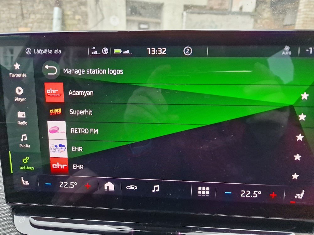

17 hours ago, Bap33 said:
I think it's also possible from the same Skoda Website
Wrong, That is completely different story -
1.
content of these archives stopped refreshing several years ago.
i checked them regularly for my previous 2016. Superb Mk3
20160609; 20161020; 20171123; 20180509; 20181213; 20200331;  no more new releases
2.
they are useless for Mib3 and all newer head unit devices,
only Mib2 and Mib2H had functionality to upload logos individually for each favorite station.
example of single logo update procedure:
3.
upload procedure were different, for each station individually,
this thread is about update whole built in database at once
4.
individually uploaded by user were displayed smaller than from internal head unit database
even identical files
-> https://www.briskoda.net/forums/topic/415291-columbus-radio-icons/
5.
one were better -
individually upload method gave ability use whatever logo picture, even selfmade
Edited by MartiniB

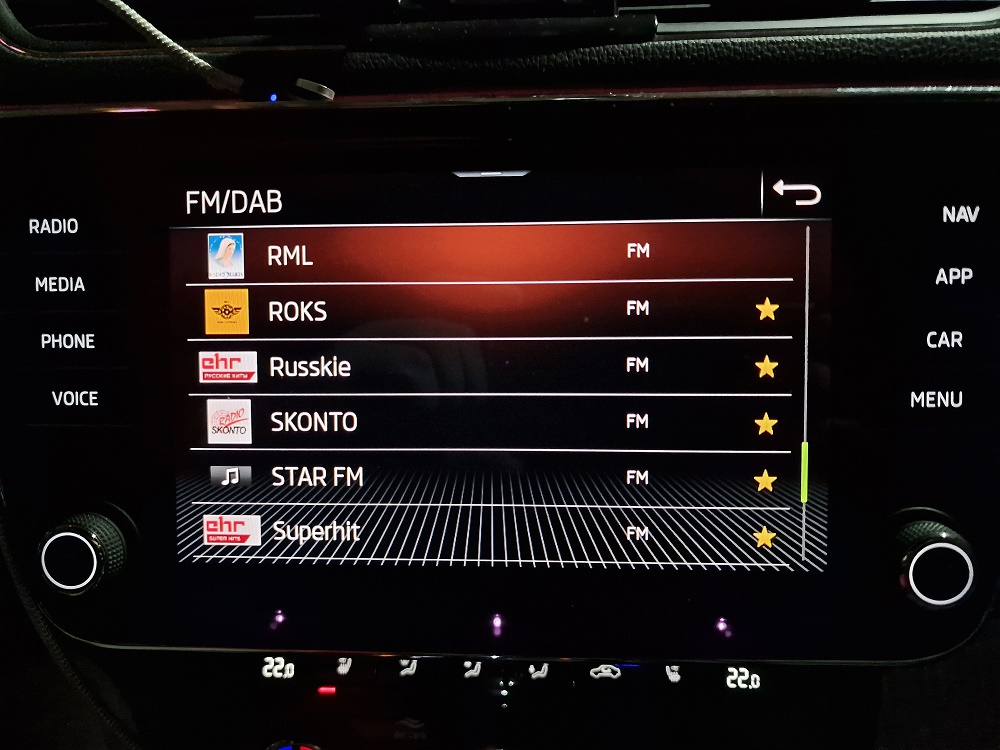

I tested today Mib2 database in my colleague's Kodiaq Amundsen
factory loaded v1.10.18 had 4:3 aspect ratio logos,
while latest v1.10.48 1:1, looks terrible, white edges from all four sides
(last one is manually loaded 4:3)
