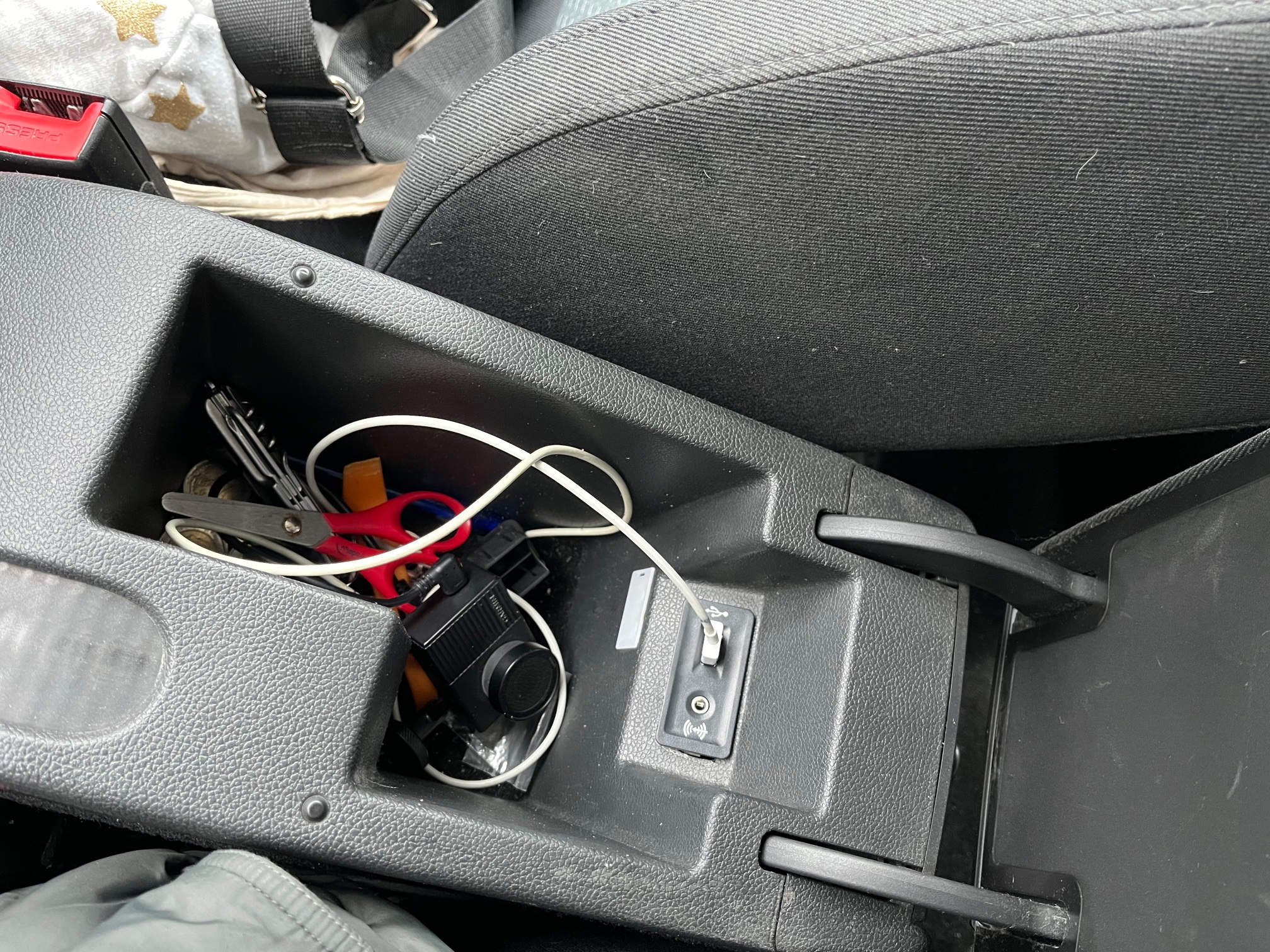

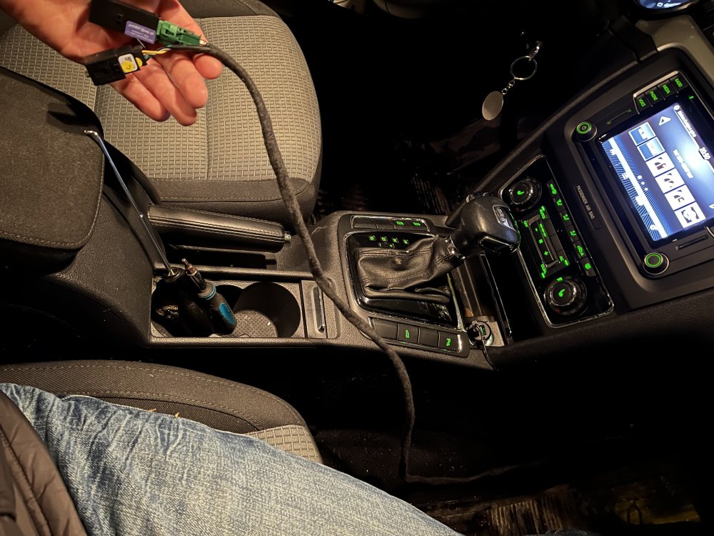

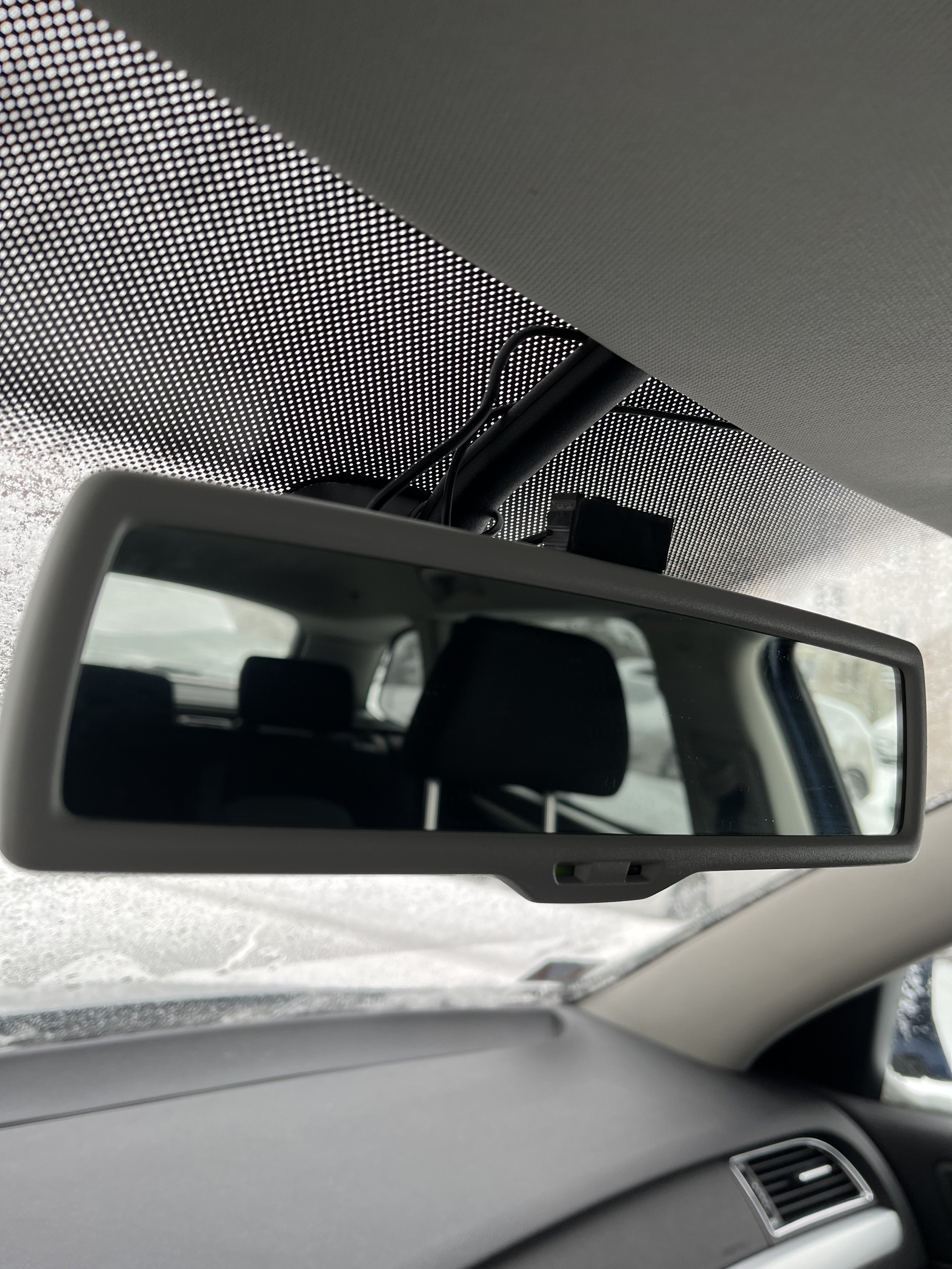

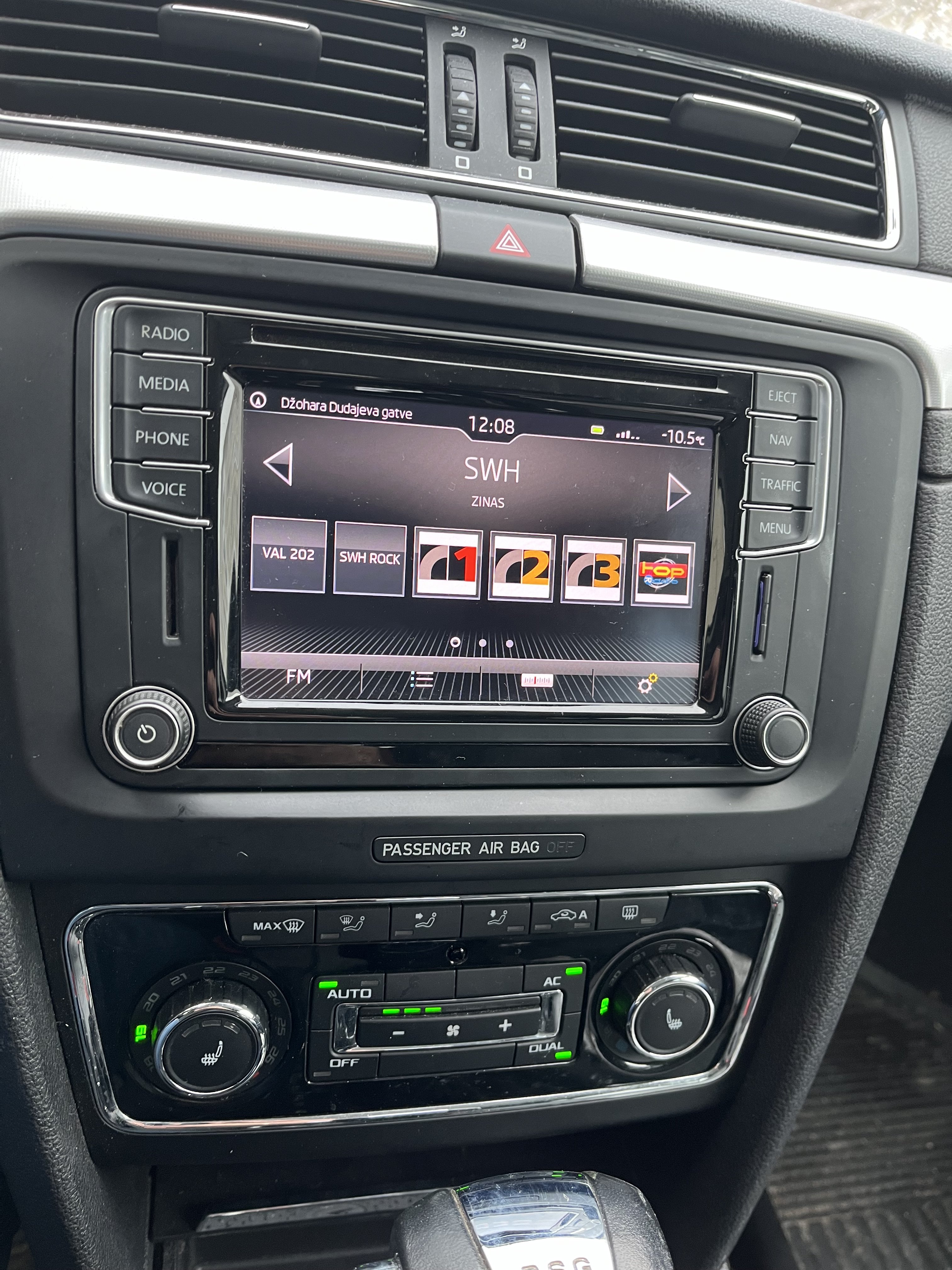

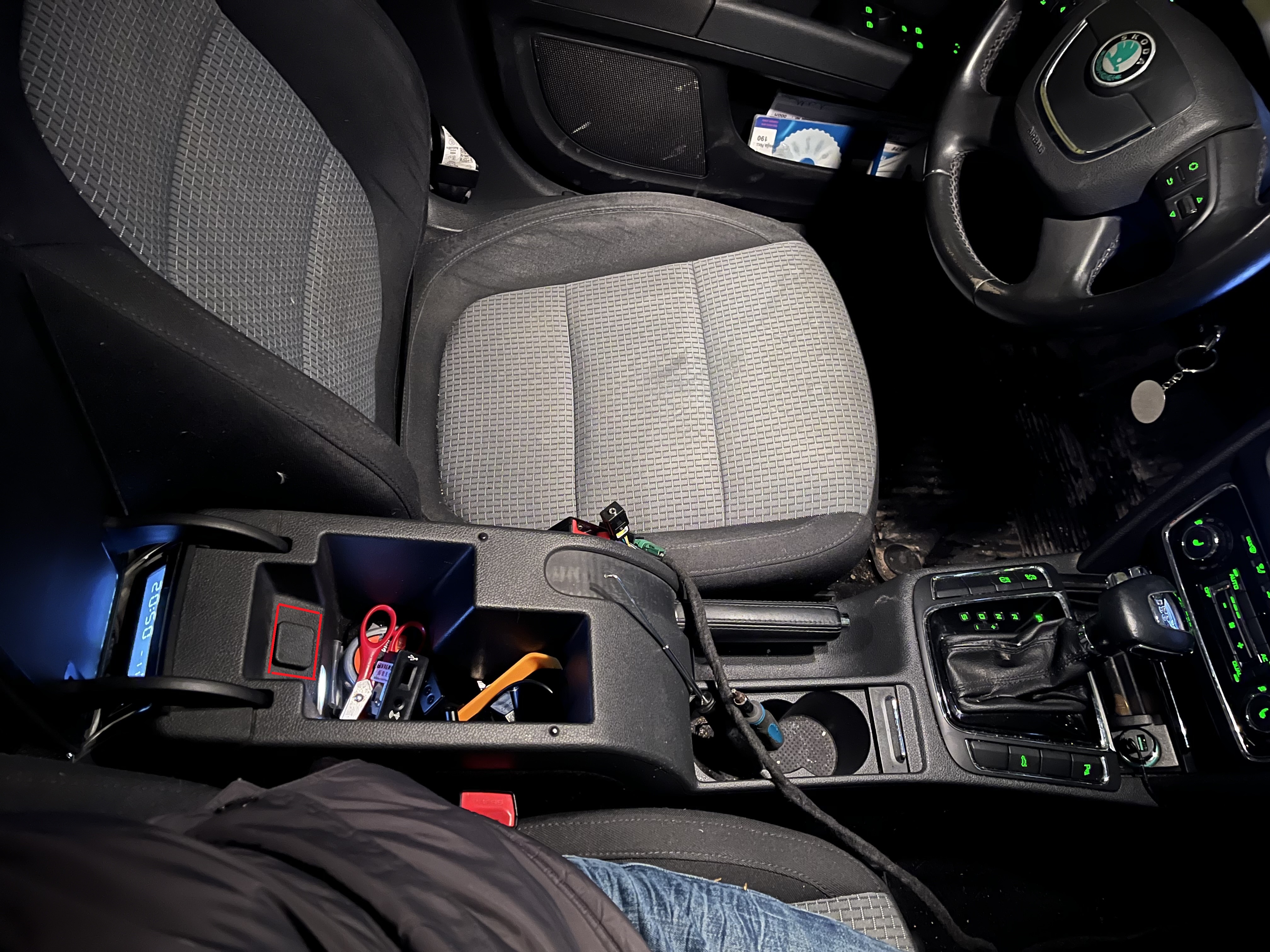

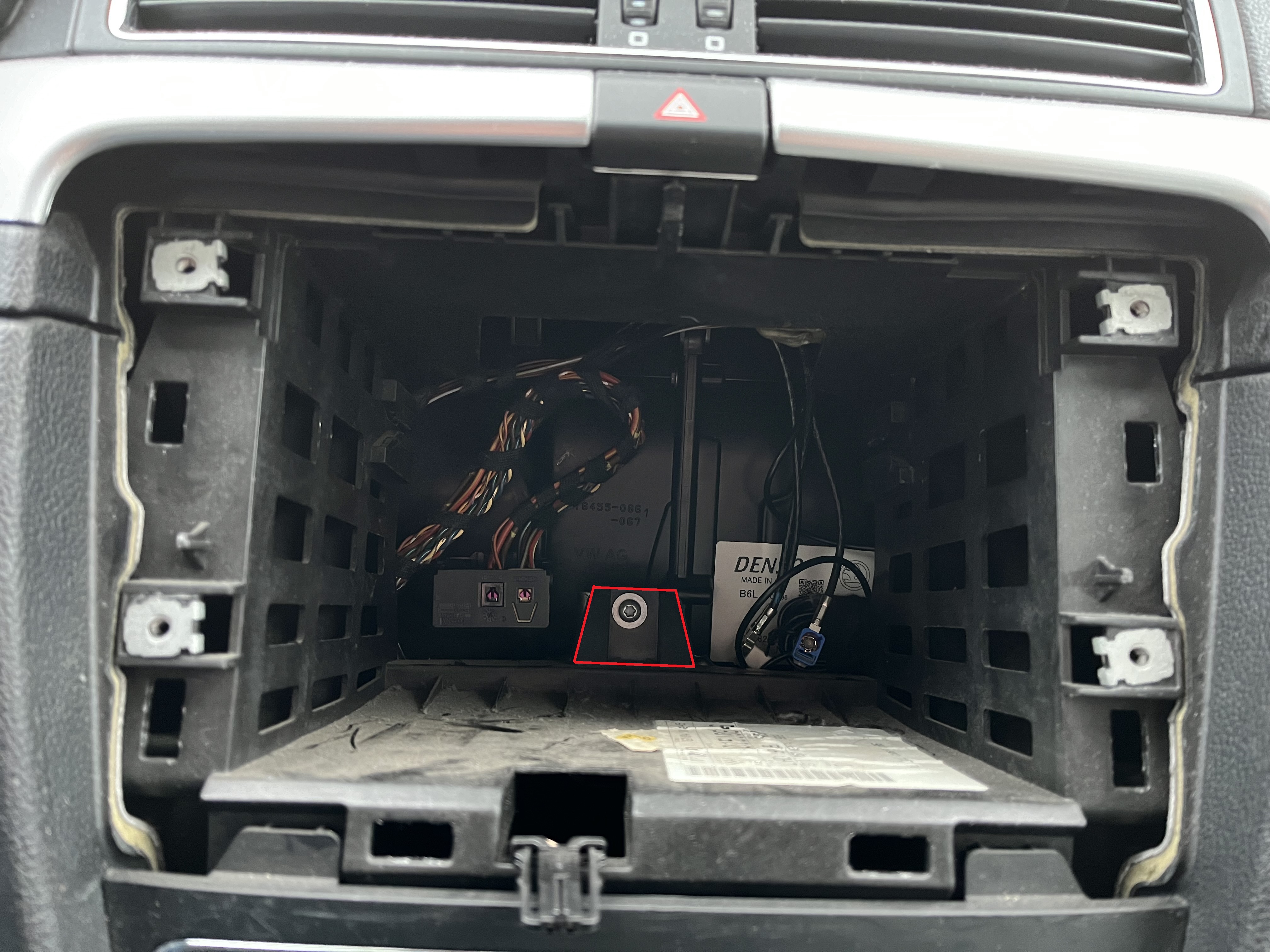

Hi, i have 2010 superb. I have replaced my rns310 with mib std2 pq 5C0035680C. Got it from vw tiguan 2014, and got it converted to Skoda buttons & software. All the work was done by Pawel (pab567). Shipped it to him, he patched it and prepared all the cables and connectors for easy swap. Only fabrication on my side was to cut plastic ribbon deep in headunit bay and route the microphone and phone cables. Here are some photos. Really happy with the results. It cost me all together around 700€. Initial reactions:
0) plug & play. OEM experience. Since Pawel set up everything. Just connect cables and all works!
1) radio signal is better
2) audio quality is better
3) UI is not laggy, its good
4) can play spotify through bluetooth
5) apple carplay/android auto through wire at headrest
6) built navigation is much better
7) no other module was neeeded to be replaced. No need for coding. All just works, no need for vagcom.
8 ) Pawel supported and answered any question I had
next steps:
1) clean the messy interrior
2) buy & install camera
3) cleanup final locations for microphone and phone connector in hand rest.
I live in Latvia so it cost me around 35€ shipping to poland for every direction.

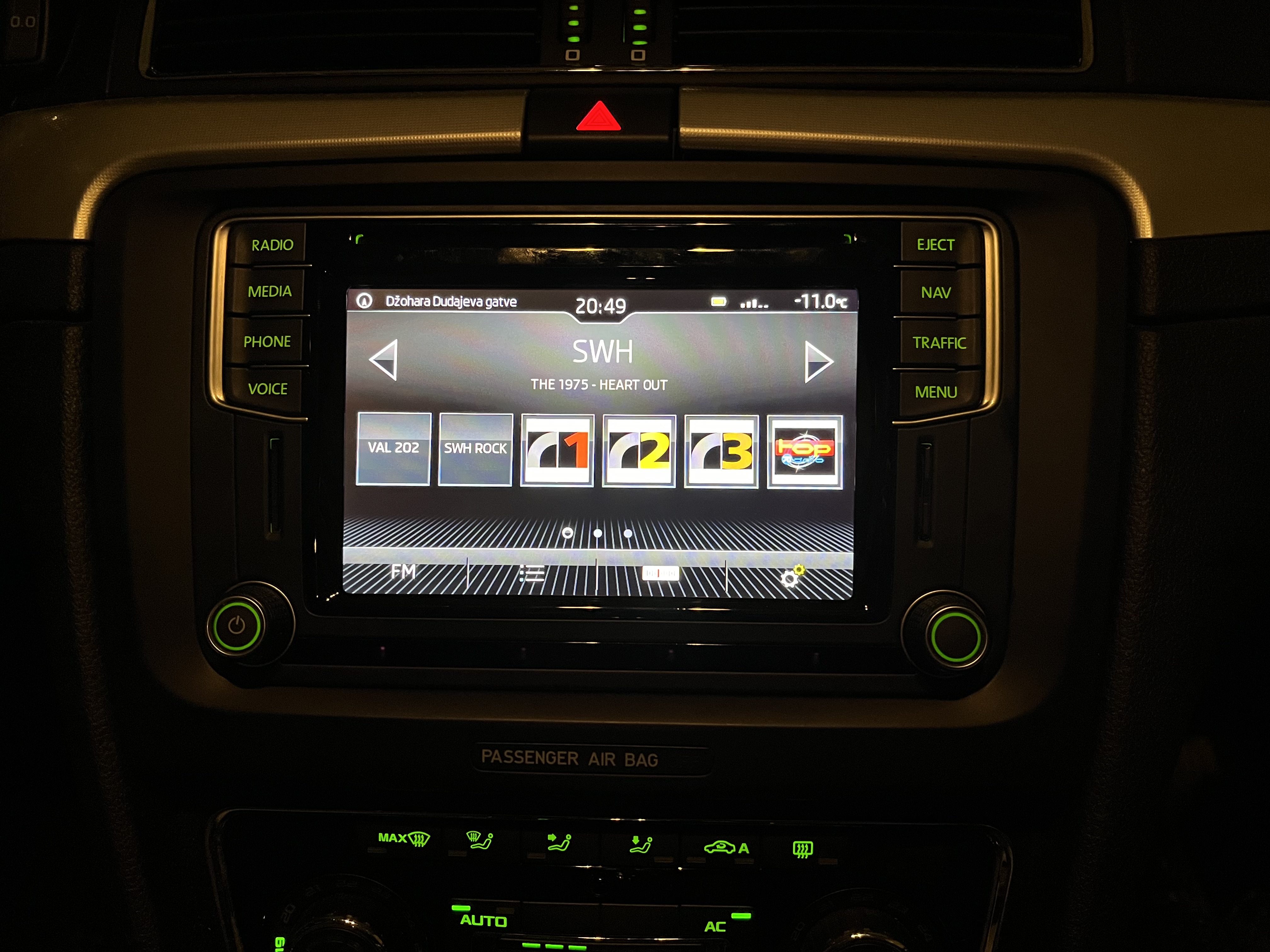

Couple more photos
That looks fantastic. I really want to do this as well👀
