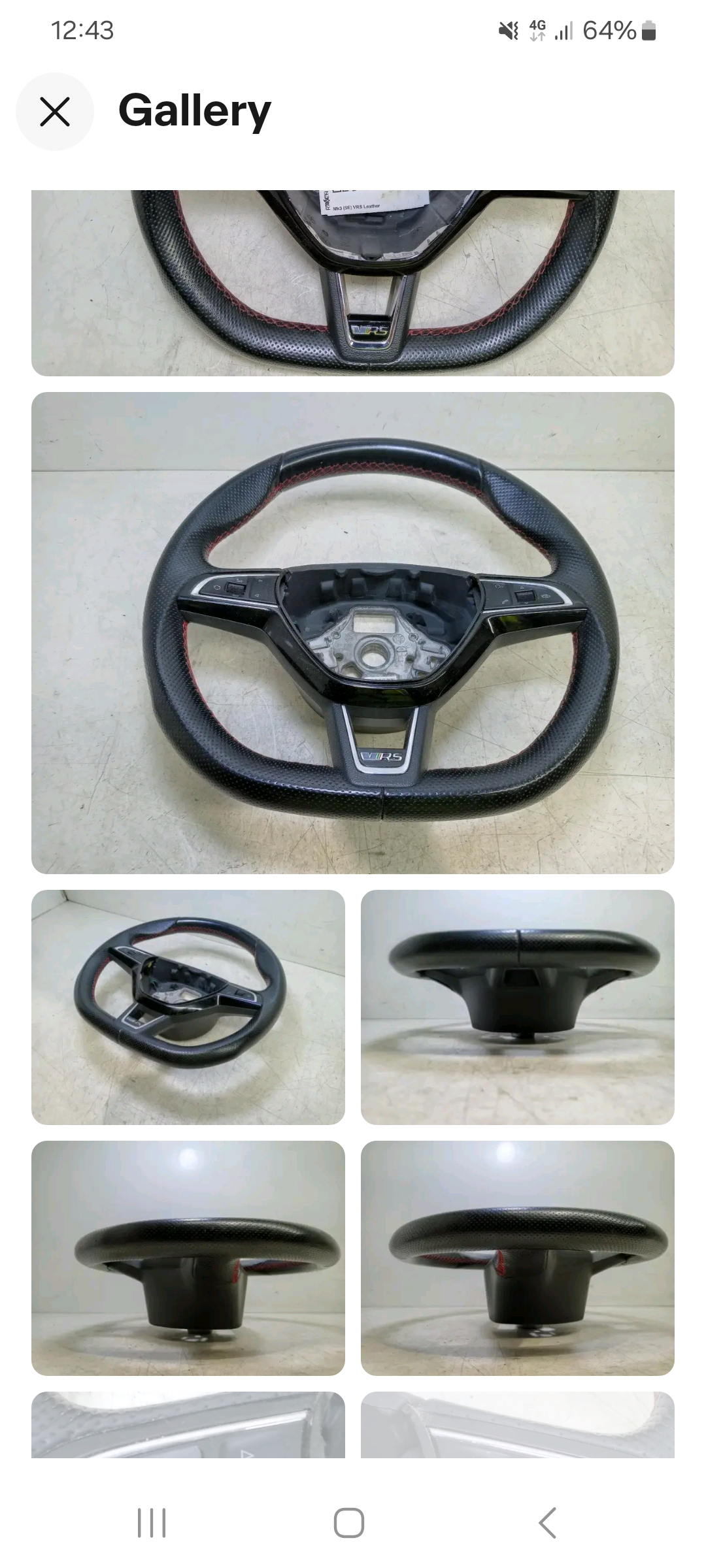

Im wanting to upgrade my fabia monte carlo 2014 1.6 tdi steering wheel to a multi finction.
I can buy tge steering wheel and loom off ebay and i am aware it will need coding after. My question is, do i have to swap the clock spring or squib or clock spring to make this podsible?
What wheel do you have? I have a set of switches and loom from a yeti with 4 spoke wheel and don't think my bcm will support it so may abort.
That maybe the case, but the Fabia multi function wheel only has switches on the Left side .......the right is blank,
so even "if" it's possible to plug and play (which I doubt) with a factory loom ( which would be specific to the Octavia..........I think the Fabia will be possibly "lacking" some of the connections in the car loom for the right hand switches, so you would need to wire these in manually or not use them.
