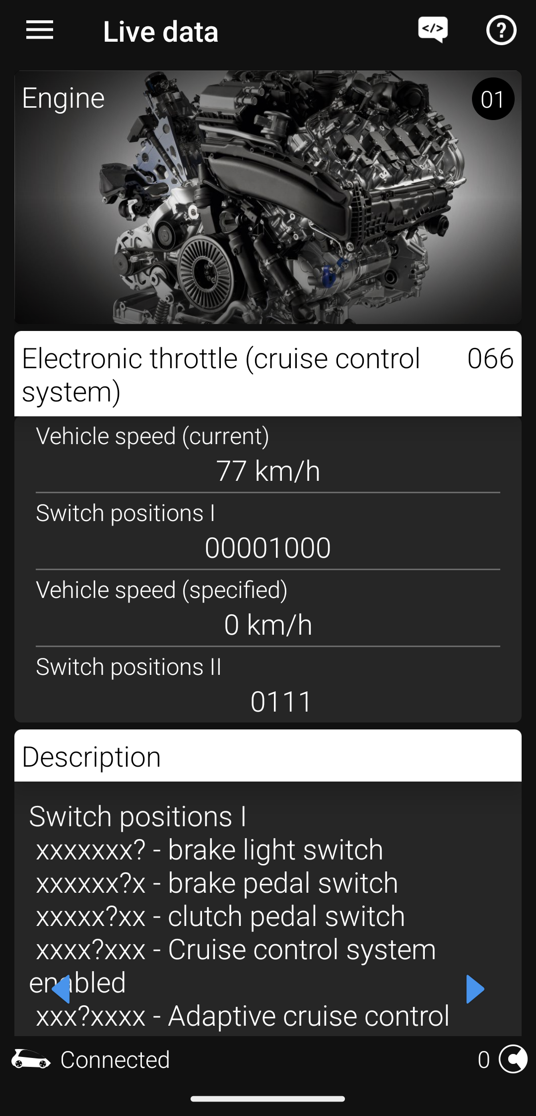

Hi! i can't get my cruise control to work. It will not engage when in speed. Nothing happens. I have tried the following to get it to work:
- Checked the stalk in Live Data and it checks out and in getting feedback from OBD11. No clutch engaged or brake.
- Tried putting in the activate code in Engine Module. Did a Throttle Body Alignment in OBD.
- Removed the microchip on the stalk and cleaned it.
- Checked all the fuses.
I have no idea where to continue from here.
Thanks in advance!

Yes tried everything. Moving the stalk in different positions and in giving feedback from it. On, off and cancel. Its just that it will not apply it to the engine. You can see in the images that im getting feedback but it will not apply that to specified speed.

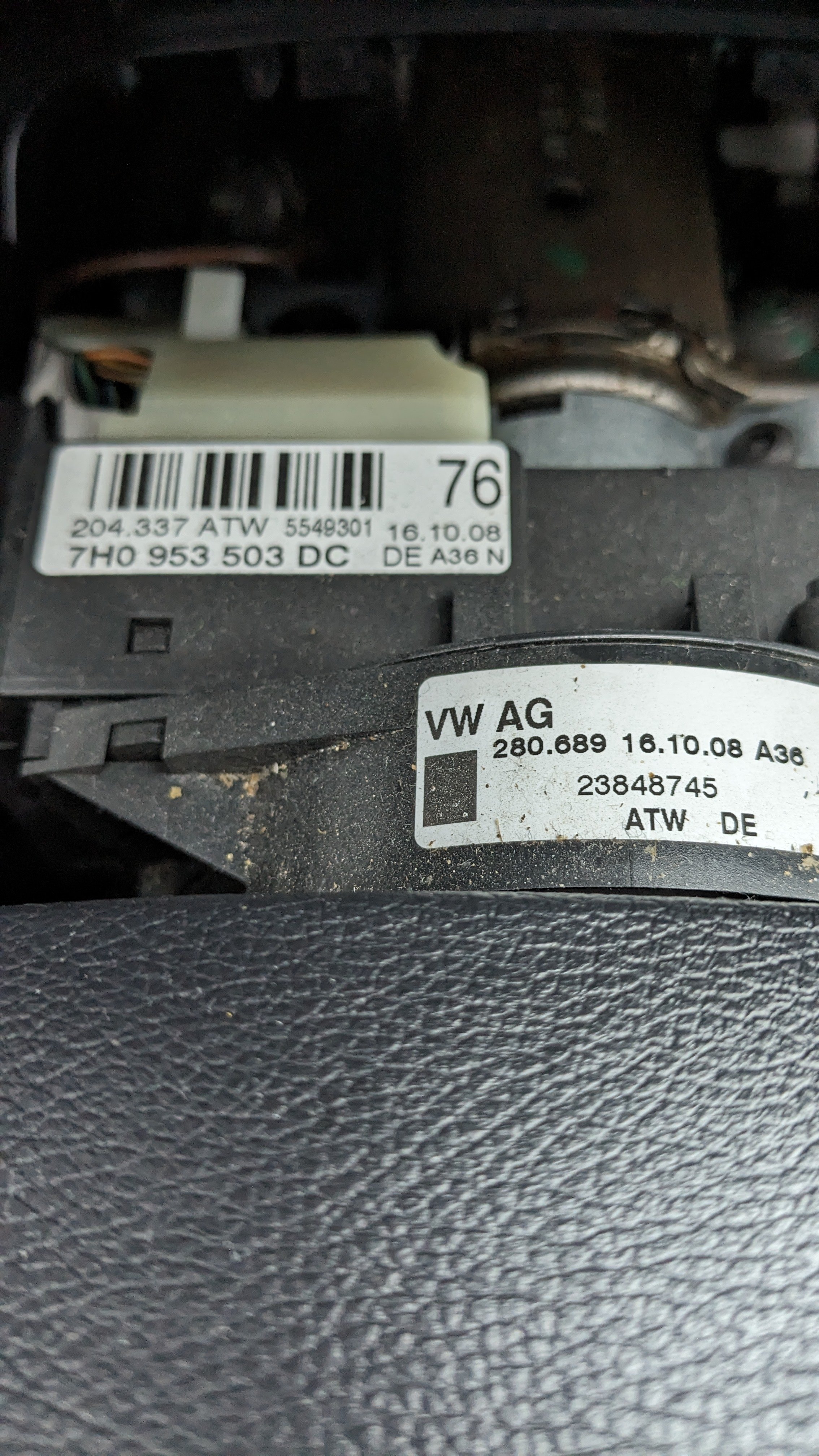

- What im thinking since I bought the car used is that the J500 steering angle sensor have been replaced and should really have been a G85 since I cant access the *16 steering column module.

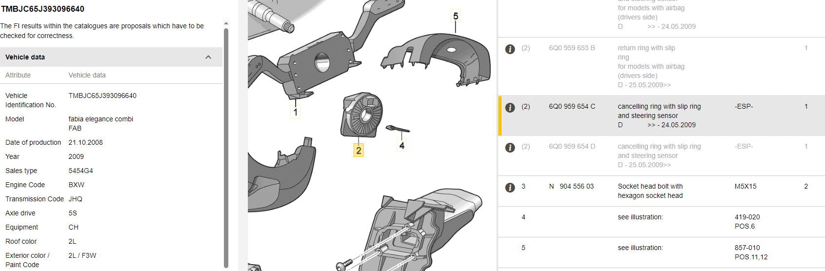

Can you share the VIN/Chassis number, so I can see what was factory fitted, please? I think G85 was only used on cars with ESP, at the time yours was built.
I believe on cars without G85, the correct module address for PAS is 44, steering assist. Maybe even for cars with G85.
Sure, no problem VIN: TMBJC65J393096640
Sidenote: I do have ESP, and I guess Drive-By-Wire.
  • Sponsor
That VIN does show a normal rack-mounted steering angle sensor, but wiring info suggests it should have a G85 sensor as well. I don't currently know where that is normally found in the parts catalogue, to check whether you VIN says it should be there or not.
Hmm, So if I would have replaced the slip ring and stalk to another one with G85, wonder if it would work then or if it would be non compatible?

Ah, you've just led me to where the G85 is, shown as item 2 here, current part number for your VIN is 6Q0 959 654C.
Frightening price new from Skoda: £225 + Tax here in UK.

UPDATE: Did replace the whole Stalk including the clock spring. And now it works flawlessly. I don't see the green icon in the cluster board but the cruise control works.
