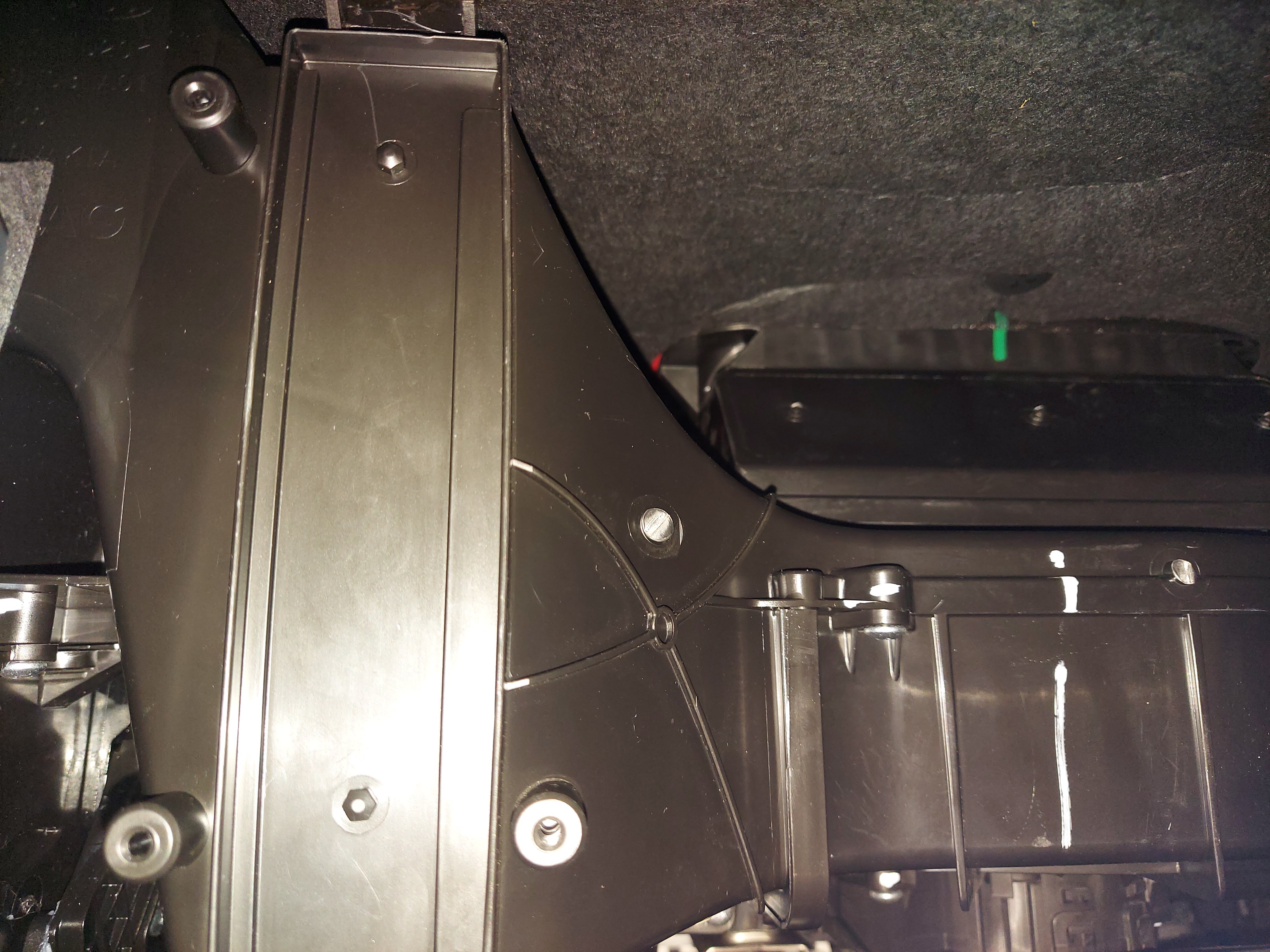

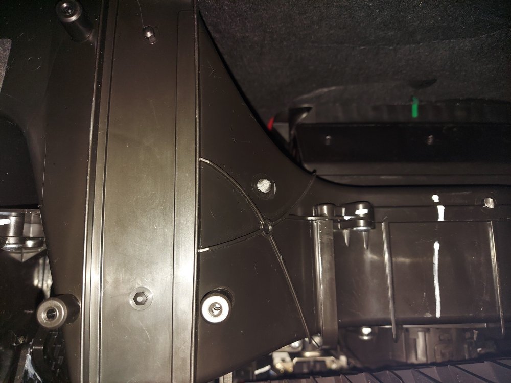

Hello,
            I took my citigo 2019 1.0 mpi to an indipendent mechanic for full service, he couldn't replace the cabin air filter though he purchased a replacement, he tried different ways but couldn't open the cabin filter as it was locked too tight or was something else. We looked at youtube videos and tried it but the locking mechanism wasn't there in my model as of the old ones where a simple clip would let the cabin filter slide out. Mechanic told me he couldn't open the cabin filter as he couldn't find any mechanism to open it, only way possible is to completely dismantle the glove box and compressor system screws behind the glove box to see what is inside. Could anyone have an idea how to replace the cabin filter in skoda citigo 2019 june model ? I tried myself couldn't figure it out. I stopped trying as I am afraid if i push too much something would break off. Please help. Pictures under my glove box compartment is attached.20240216_111228.thumb.jpg.c88e62e4c405e4e39f3c095a3ff91f46.jpg

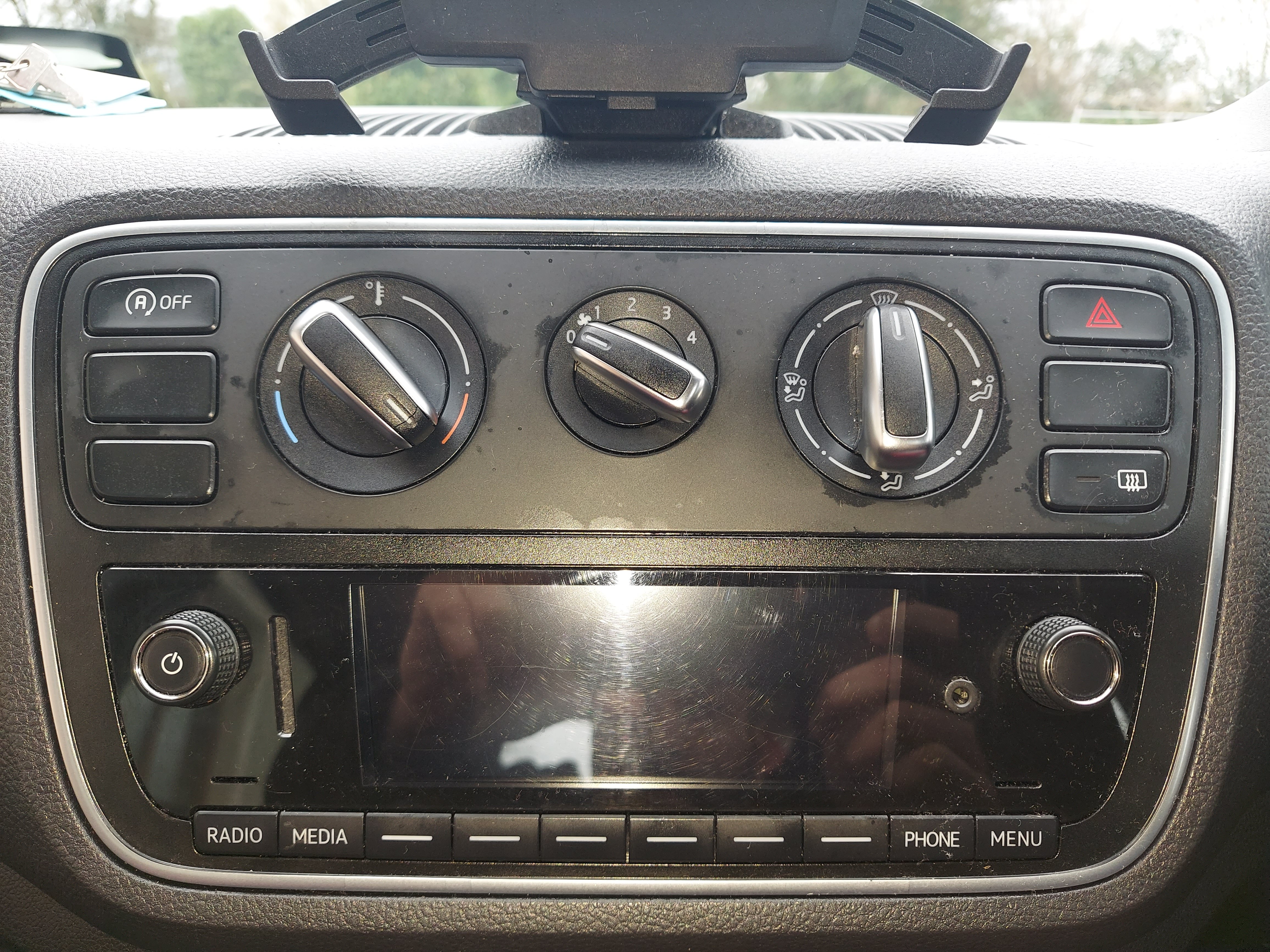

But I do have an air con but not the automatic/climatronic its a manual a/c hot and cold air. I believe all skoda cars have AC. Picture is attached of my AC switcher.
That looks like a simple cabin heating and ventilation system - not one with AC.

2 minutes ago, Warrior193 said:
That looks like a simple cabin heating system - not one with AC.
Is it? I thought it was AC. Okay maybe that is why I don't have cabin filter. So that means air blowing in will be dirty and smelly right without the cabin filter? But how will it cool without AC system I understand heating it has setting for cold air too. I'm confused.
The same air that you breathe when outside of the vehicle.
Coldest setting is ambient air temperature.
The above is on the basis that you do not have aircon, I do not have Climatronic but the basic Climatic system and also aircon, my heater controls are like yours but I have an additional AC on/off button which I don't see in your photograph.

No that is not for air recirculate. It's the auto start button for city traffic it can be turned on or off.

The parts diagram of the interior ventilation system for a non-A/C equipped Citigo of this year does not show a cabin/pollen filter, so I would not expect there to be one.

That button is for automatic idle stop.
😄  Fair enough.  😄  I misread the 'A' as 'R'.  😄

It's funny that the skoda manual i got states it as air conditioning. But it's not. And yes I don't have air recirculation option nor heated seats, only auto stop/start and a heater .
