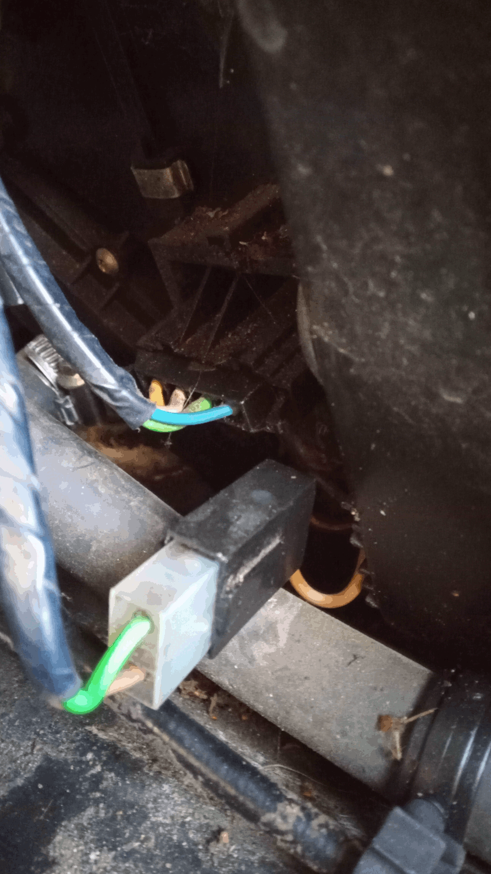

I have a felicia 1998 1.3mpi with an annoying problem just started.  It sounds like it may be the blower/heater, and it is running even with the ignition off and no key in. The only way to stop it is to disconnect the battery. I have looked around the guides section but nothing mentions this issue.  I have attached a vid of the sound and where it appears to be coming from as it is only audible from within the car.
So far I have pulled the all the fuses, the relays and disconnected two wiring blocks that seem to connect to what I assume is the blower (see image) - yet the problem persists! Changing the settings on the blower controls seem to make no differance either. Only disconnecting the batt stops it.

Yes, the two blocks are heater blower and the resistor block. So it's not the blower motor.
As of what it is - I have no idea. All devices in the interior should be disconnected with fuses removed. And I don't think that bad contact would be this audible without causing a fire. Could it be some incorrectly wired device added by a previous owner and hidden behind the dashboard?

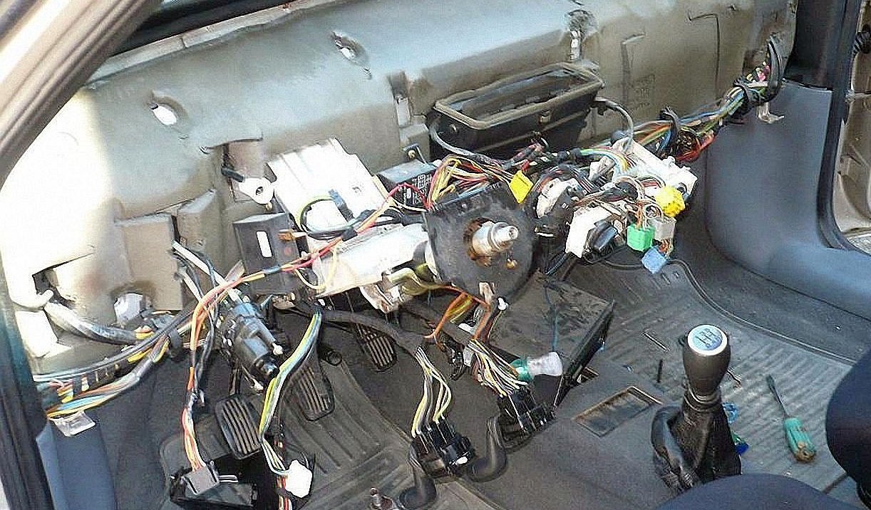

@robchap here is about the dashboard removal.
Here from mine.
