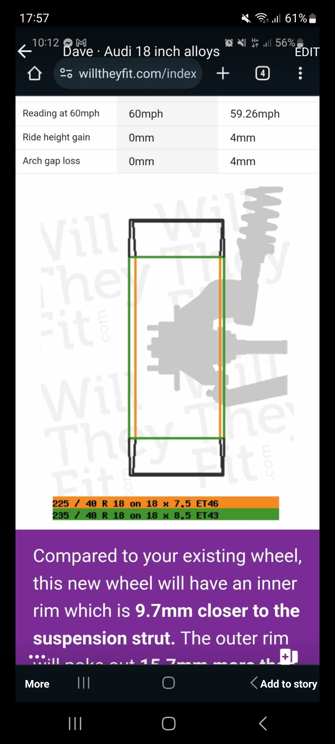

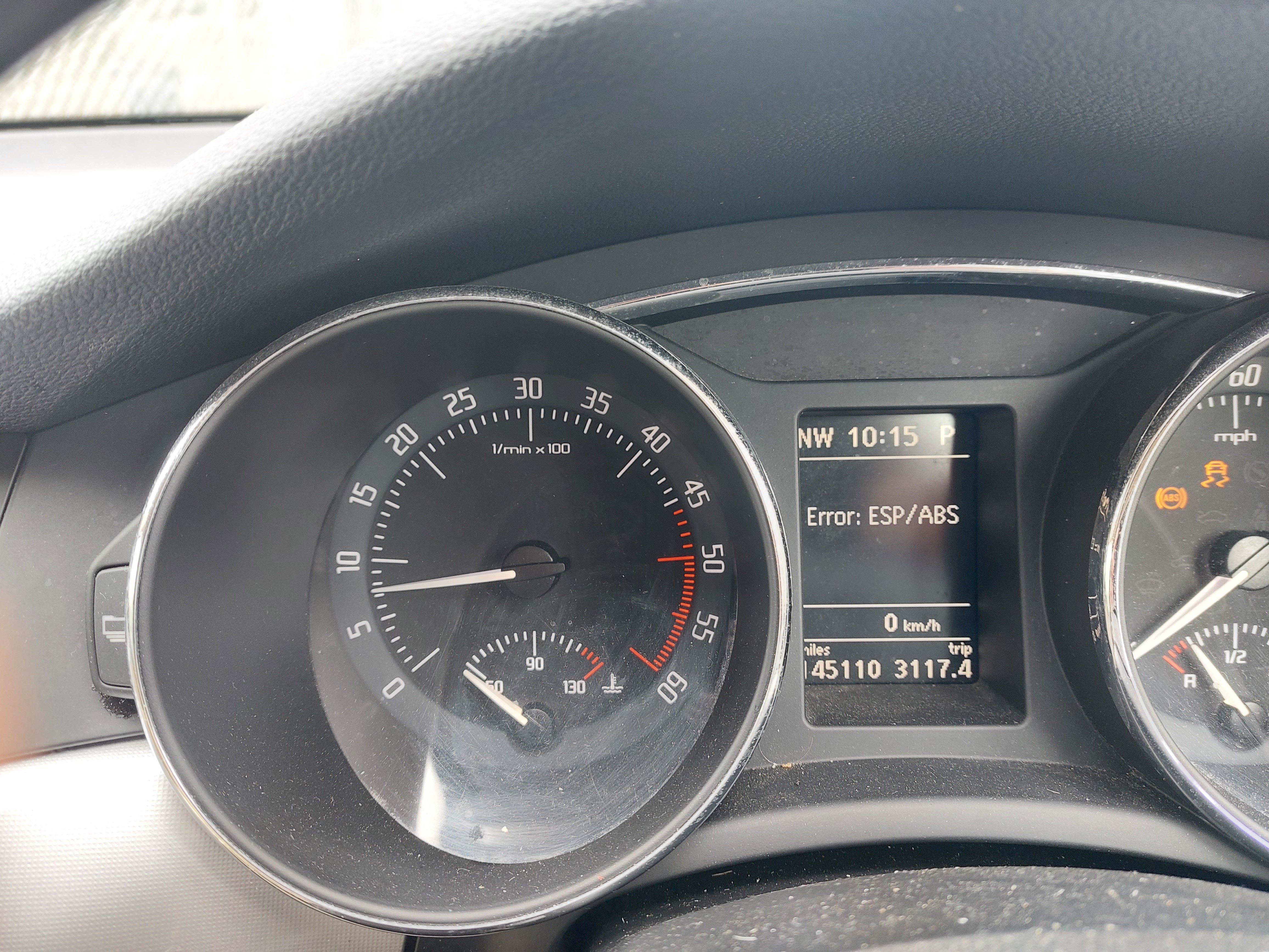

As the title states I've swapped some new to me wheels onto my 170 Elegance and the dash has lit up like a xmas tree.
What is the likely culprit ? Abs sensor is something else ?

What wheels & tyres did you fit? Are they all the same rolling radius?

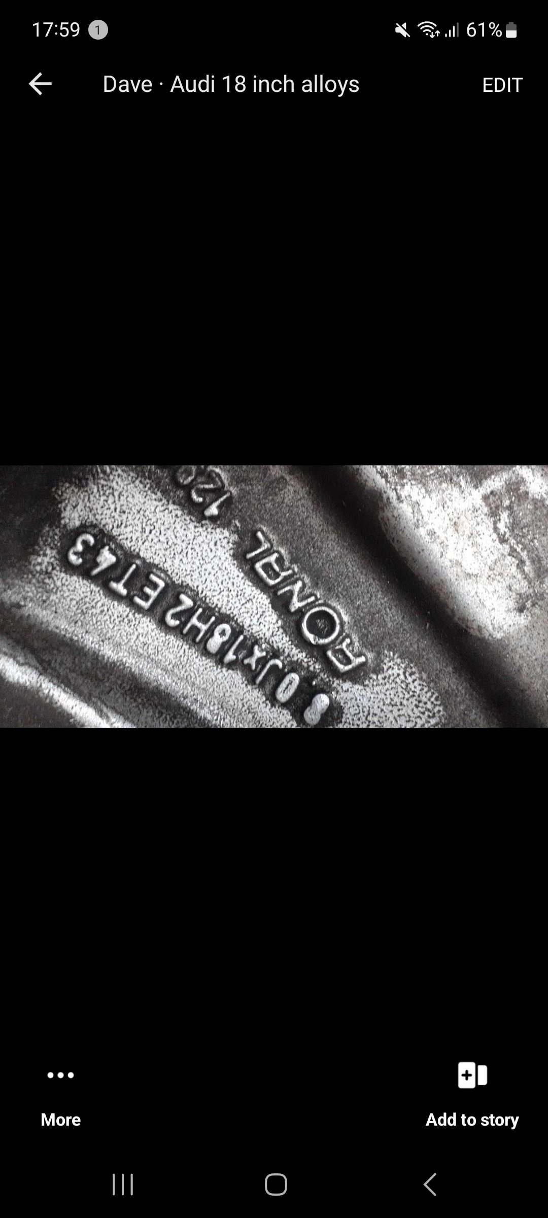

Fitted audi ronal wheels mate
And are all 4 tyres actually the same size?
The newer tyres are 235 opposed to 225 being the only difference.
Edited by Davidoff1234
A Total diameter / circumference change would make no difference you just reset the TPMS.

Different total diameter will usually put the tpms light on. Does it have sensors in the wheels?

If you changed the tyre width then the diameter is different, as for the sensors if you wiggle the valve it will move easily without sensors and you will feel some resistance if it does have them.

So the tyres need replacing with 225's ?

What is the full size of each tyre fitted? Are all 4 the same section, profile and rim diameter? Are the 4 wheels all the same diameter and width?
If everything is not exactly the same on each corner, then you could run into issues with these systems because the wheels will not all be running at the same speed.
Another thing that can cause what you are describing is a flat or disconnected battery. The ABS module in particular gets quite upset when this happens. To reset it, with the engine running, turn the steering wheel fully left then fully right before returning to the centre. This resets the steering angle sensor and makes the controller happy again. I'd suggest trying this before you go any further, it's quick to do and you'll know straight away if it has worked.
A fault scan of the ABS module would also be worth doing, just to see what it thinks is going on. It may help guide further fault finding.
Old wheels back on and still getting this pesky abs eps tpm error ! Isn't allowing me to set the tyre pressure. Have done the steering wheel reset and no difference.  Also getting a slowing down motion as if running out of fuel or braking. This disappears after pulling over and journey then normal.
Right, definitely something up with the ABS. Time to get a diagnostic scan done on the control module to see what's going on.
