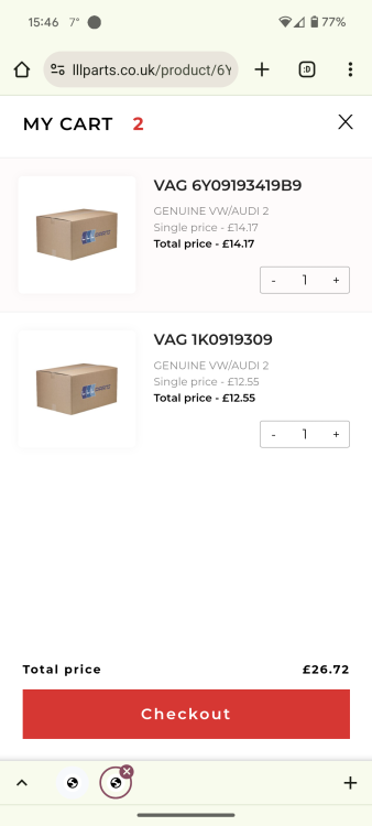

And, sorry for the long question, if anyone would be able to easily double check I'm ordering the right replacement bits I'd be super grateful. I feel like I got taken round the houses a bit with the parts diagram on here -
https://www.lllparts.co.uk/product/1K0919309/1k0919309-genuine-vw-audi-2
I'm trying to get the socket and the ring surround clip as I can see one of the clip/flange bits is snapped off. I figured I don't actually need the lighter unit as it's never going to be used.
