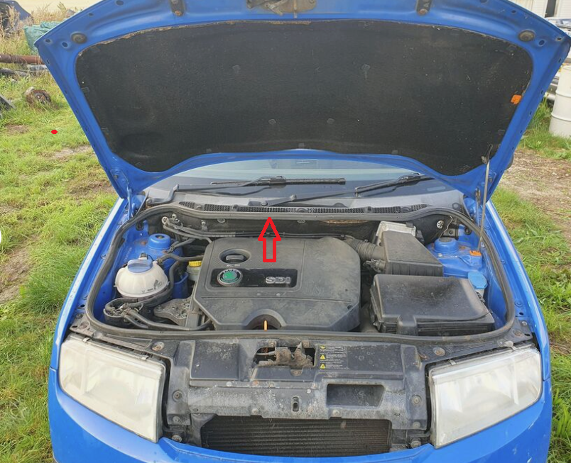

Can you post a photo of your engine bay?
There is a rubber seal that goes along the top of the 'water box' (the section below the windscreen wipers), and all the way around the engine bay, to seal against the underside of the bonnet.
This should keep any leaked exhaust gases from entering the ventilation system inlet (which is inside the water box).
This is quite a dangerous situation. If the leak is upstream of the catalytic converter (like at the head/manifold junction) you could be breathing carbon monoxide (CO) which can make you fall asleep and die.

You should have this:
@Breezy_PeteI might have an old photo. I will have to find it in my phone. But I think my seal is detached from the water box. I am planing on cleaning out the water box and replacing the plastic things that hold it in. How should I fix the seal?
If it is not there, get one from a scrapyard.
One version appears to be available new from Skoda still - 6Y0 823 723 A
Not sure if that is the correct one for your car or not, if you tell me the VIN I can check.

Your VIN calls for 6Y0 823 737B, which was available until recently, so some places may still have stock.
Dropped from sale at Skoda in August last year.
