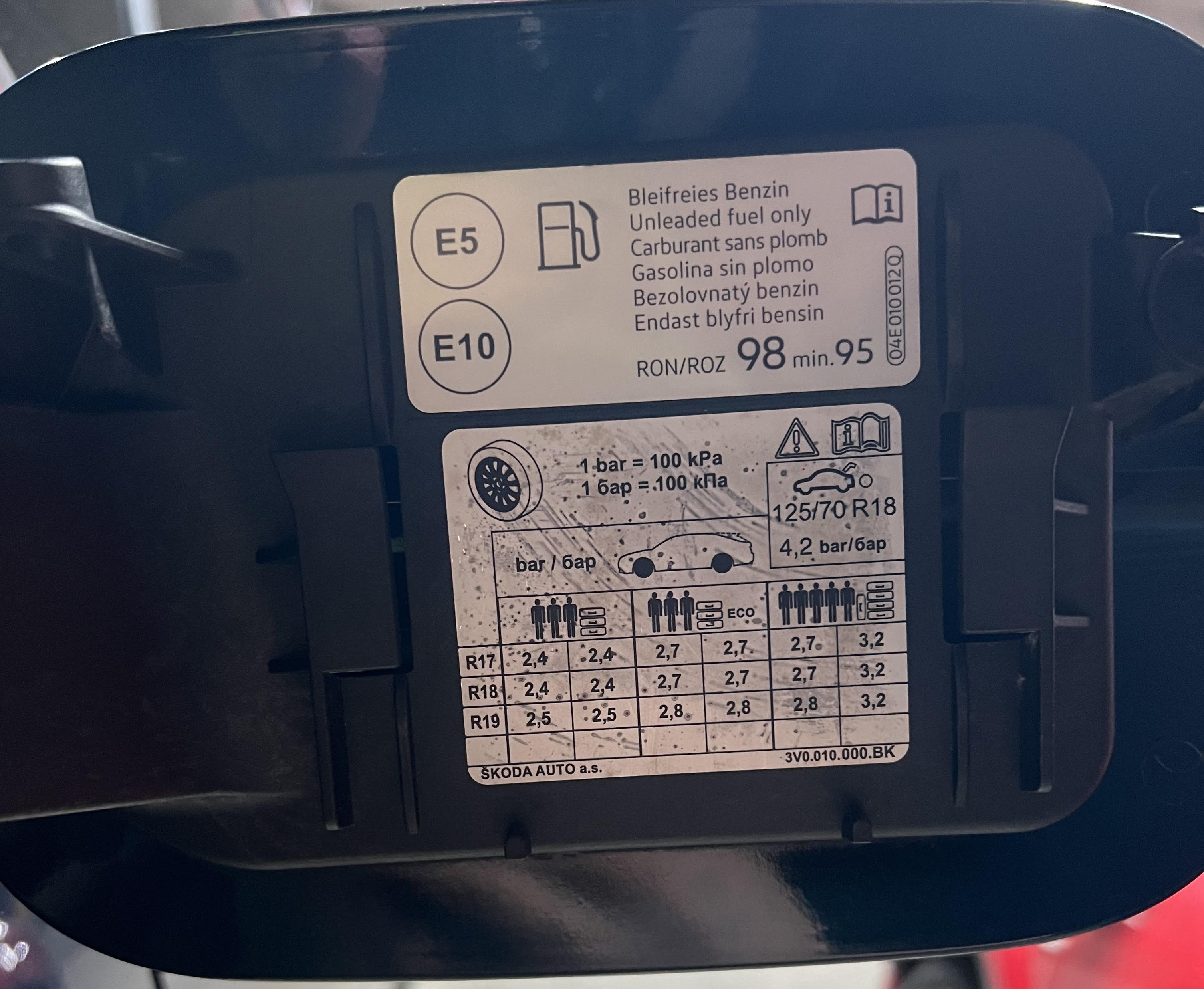

The dilemma I am facing is that there the majority of petrol stations here provide you with 95 RON and 99 or 100 RON as options.
I checked out the car's flap as my 'source of truth' and it specifies "benzin RON/ROZ 98 min. 95", attached file skoda_flap.jpg.
I was hoping someone has already been through this scenario and could share his experience (hopefully positive ones!).

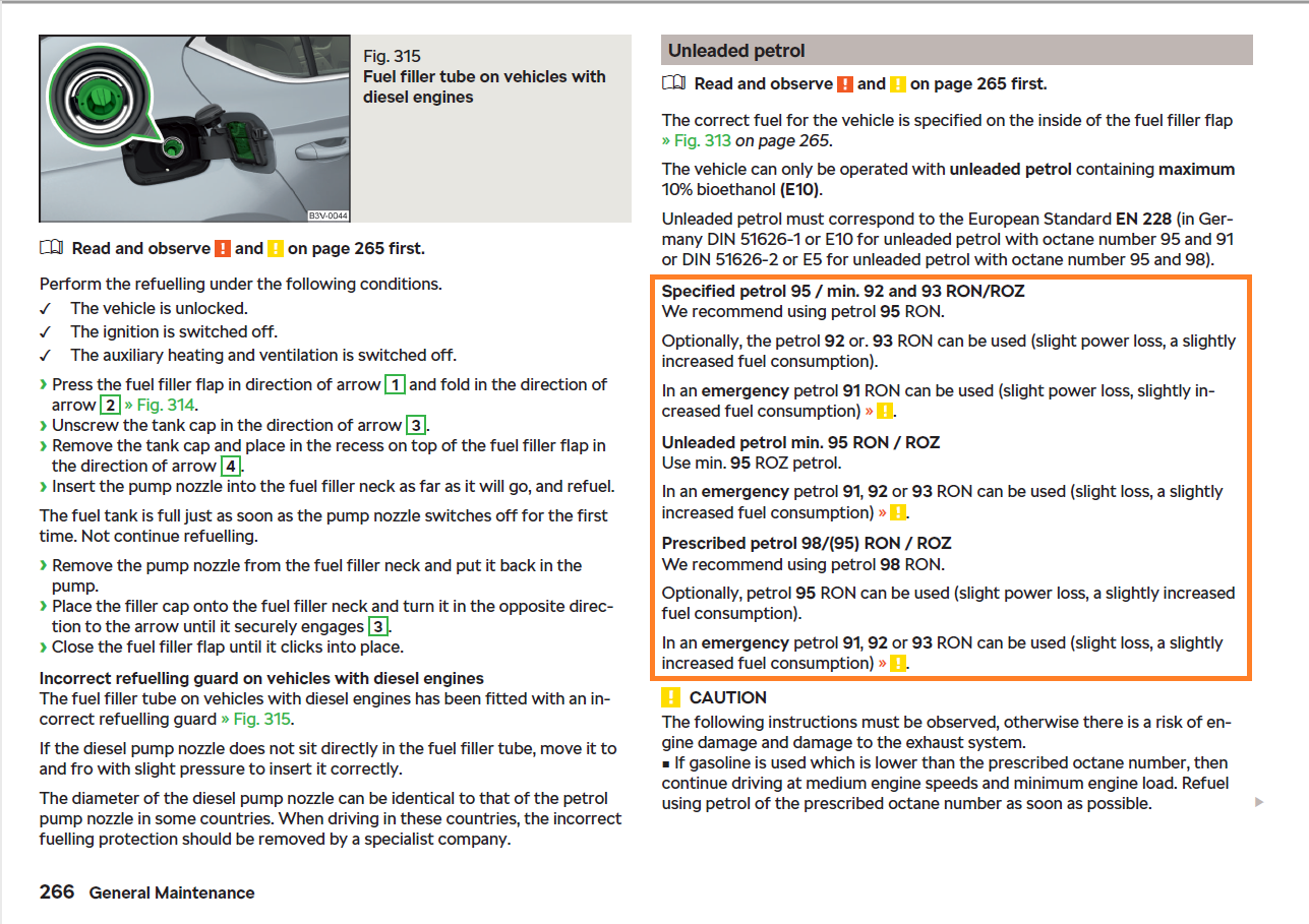

I've downloaded the car's manual, using the VIN to make sure it matches, and found 2 relevant pages:
Here the wording is a bit confusing for me, since it mentions 1) 'specified petrol 95/ min. 92 RON', 2) 'unleaded petrol min 95 RON', and 3) 'prescribed petrol 98/(95)'.
Based on the fonts they used, I think these are 3 distinct ways they specify the fuels on their flaps and I believe that I fall under the first formulation, but with 98 and 95 as RON values, instead of 95 and 92.
Page 266 didn't clarify matters for me, because I was searching for an upper boundary for the octane number and it provided a recommended value which I cannot find in petrol stations.

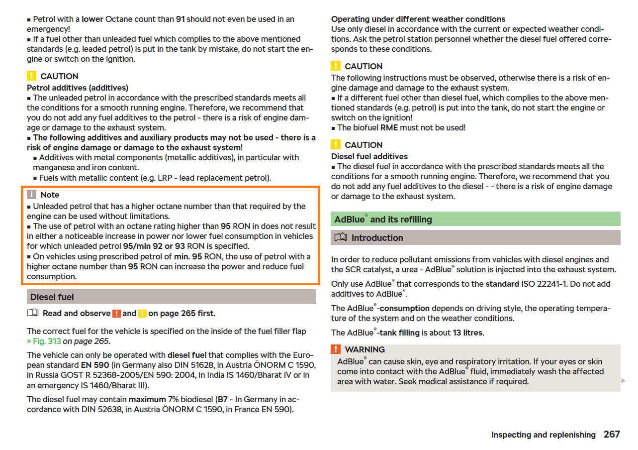

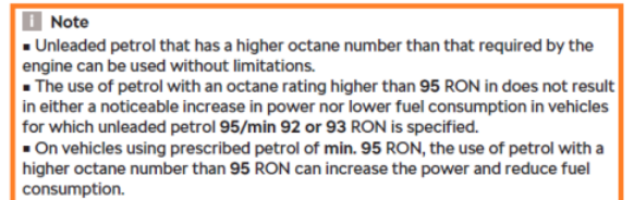

Here the Note touches the higher octane topic with all 3 points:
■ Unleaded petrol that has a higher octane number than that required by the engine can be used without limitations.
■ The use of petrol with an octane rating higher than 95 RON in does not result in either a noticeable increase in power nor lower fuel consumption in vehicles for which unleaded petrol 95/min 92 or 93 RON is specified.
■ On vehicles using prescribed petrol of min. 95 RON, the use of petrol with a higher octane number than 95 RON can increase the power and reduce fuel consumption.
So... I'd conclude it's OK to use 100 RON?
P.S. I mainly use the car on holidays, only minimal driving in the city, so fuel price isn't really critical.
Welcome.
Your car is the Min 95 octane.  So forget the Min 92 / 93 stuff as for other world regions or engines.
You have the Prescribed 98 as VW / Skoda have in the EU / Europe / UK,  except we in the UK have 95 E10 or 97 or 99 min E5.
That 99 Min in the UK can be 100 or 100+ on occasions. Locations.
The Continental Europe 100, 100 + is lovely stuff for a TSI.     Enjoy.

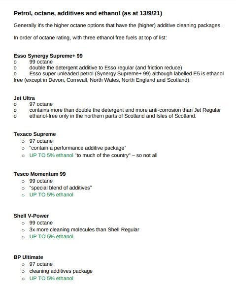

The higher octane petrols also generally have higher levels of cleaning additives which you may feel give additional benefits.

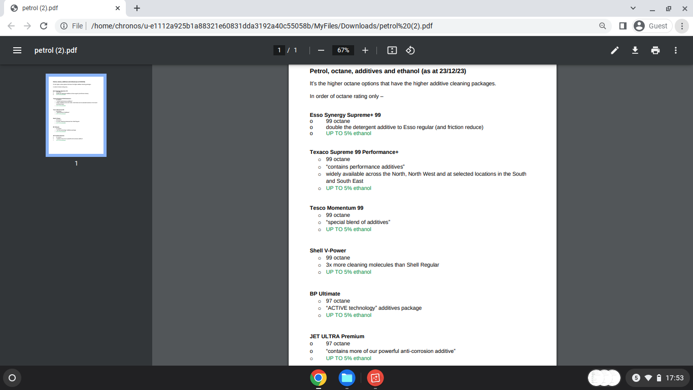

@Ootohere
- thank you for the .pdf printout with the content of the fuels in the UK. It gave me a better idea what to look for. Indeed, the engine seemed to appreciate the 100plus. :)

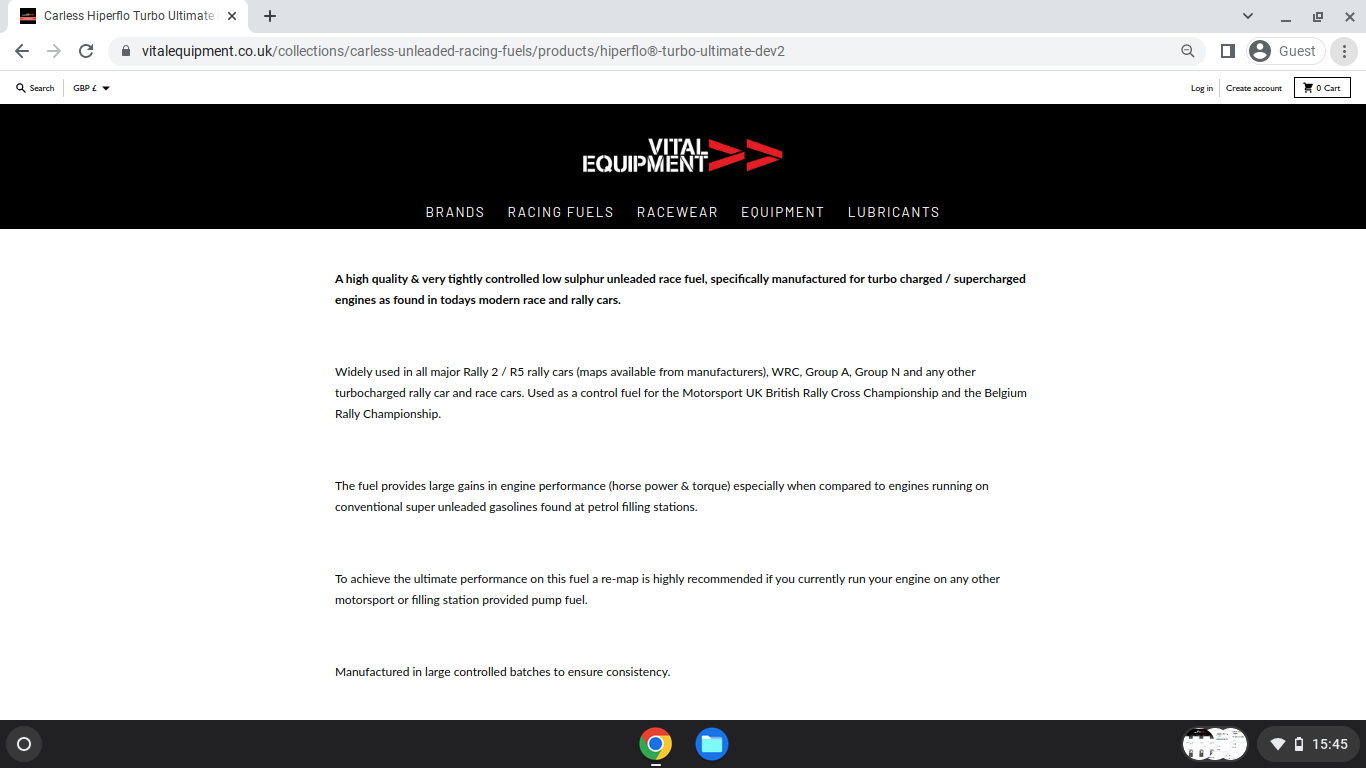

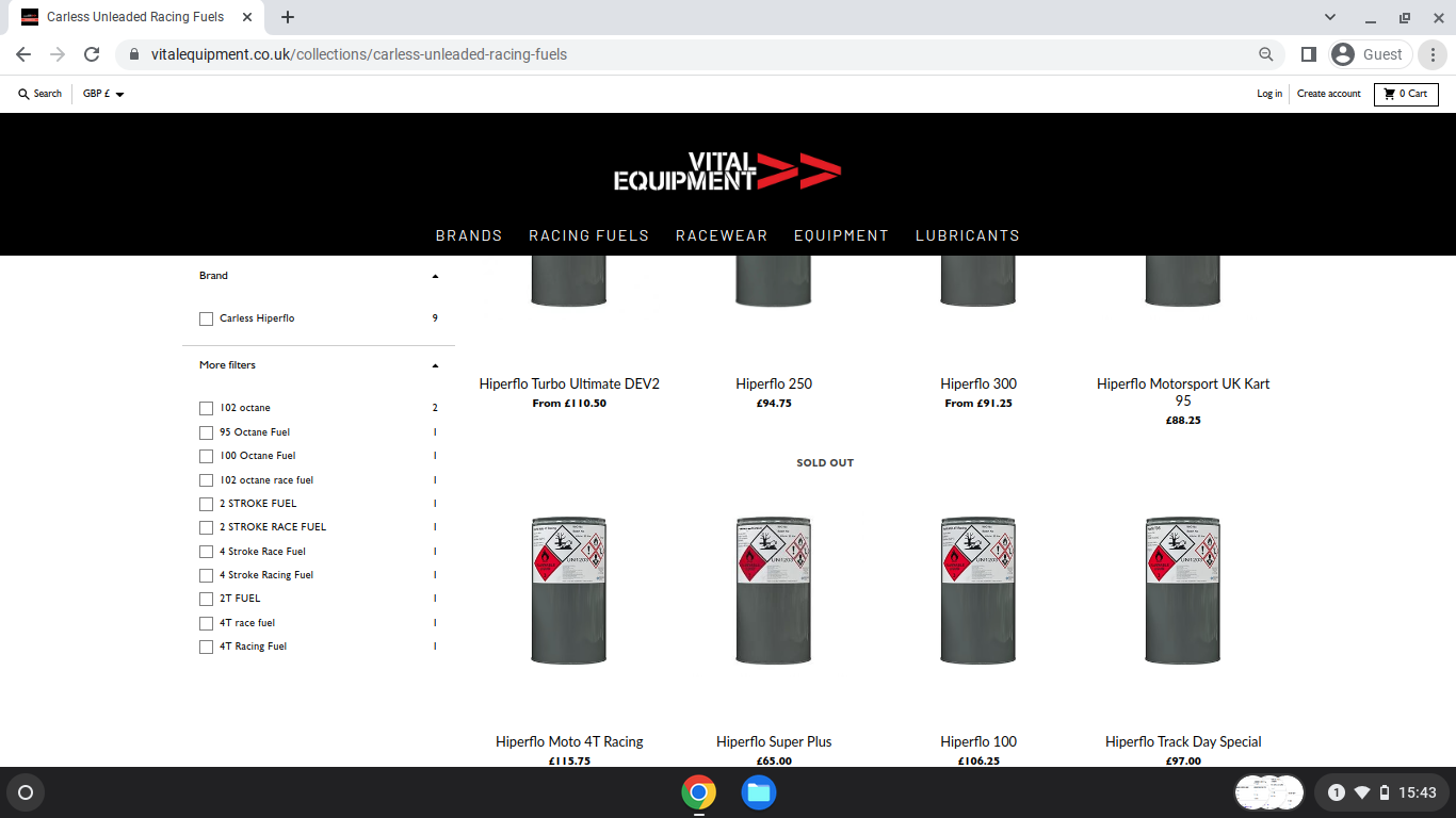

The cars might well run well run on 100 +  maybe 102 ron Race / Track fuel. Especially if mapped to.
Twice the price in the UK, but then no daft additives / detergents, you know every time what you are getting.
In Italy near the factories or tracks there is Shell V-Power 102 ron available at pumps.
(Which is where their advert / vid of a F1 car running on pump fuel came about. A bit sneaky really.)
There used to be pre 2010 102 ron BP Ultimate available in a few filling stations in the UK near to tracks.
Edited by Ootohere
