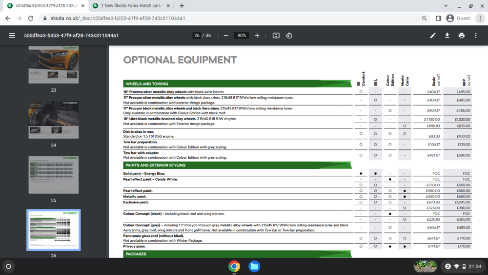

" Disc brakes standard on the rear of the 1.5 TSI DSG."
Gone is the option of having them fitted to 1.0TSI,s for £100.
Not that they are still standard on 1.5 TSI DSG,s.
