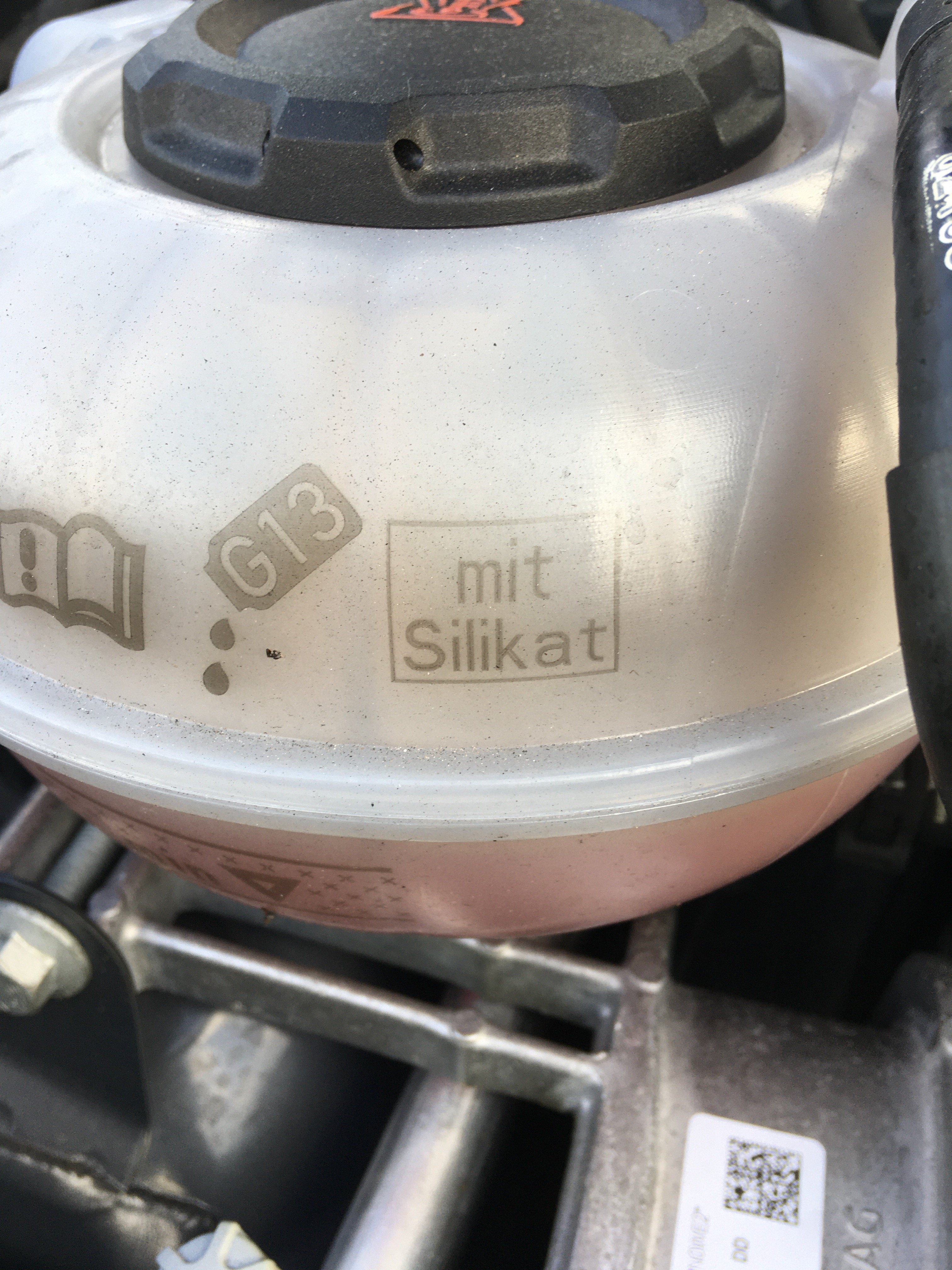

Tanks with a silica bag in generally had 'mit Silikat' printed on the outside I thought.  This is the tank on my previous 2015 vRS:

I’ve got an identical tank on my GTI - one with ‘mit Silikat’ on.  If there is a bag in yours, it’s very easy to find. You should be able to both see it with a good torch, and also feel it with your fingers.  I oiked mine out as soon as the car was out of warranty. It was very easy to do and took moments.
Having said that, I suspect you don’t have a bag in there. But it does look time for a coolant change IMO.

There were 2 versions of tanks with bags.
For older it's possible to get bag out with long pliers = you can see bag through coolant fill bore.
For newer (my '2016 Octy had this version) it's not possible because bag is behind additional wall and you can't even see it.

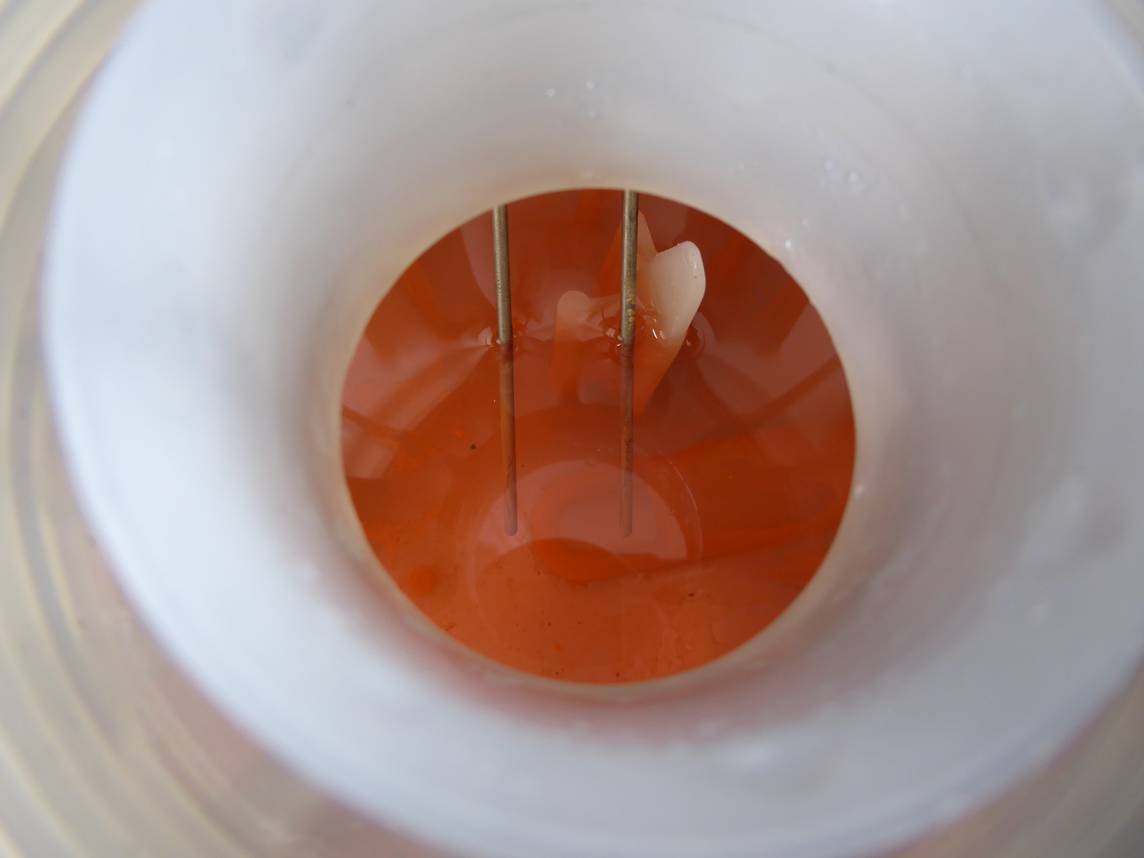

My coolant was changed in June 2022 and looks like this today. Your coolant doesn't look particularly clean.

If coolant has mixed with other type it can turn a brown colour. Is it said to not cause a problem.
Perhaps.
But the system has supposedly been flushed.
Beyond that, it has some sort of scum/fish-food stuff floating on it.
I'd be wanting the system flushed again and G12evo put in.
Definitely. I assume the system has not been flushed properly, to do it properly you would need to do it multiple times. With main dealer garages being on bonus schemes stuff like this usually happens cutting corners to achieve bonus.
