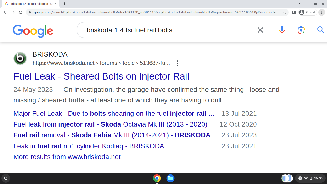

I am unable to find any relevant TPIs relating to fuel rail leaks - is anyone able to point me in the right direction?
The NHTSA safety recall for North American EA211 fuel rail bolt failures (VW recall code - 24Gi) appears to be for the 1.4TSI.
I see that the EA211s for that market have been manufactured in Silau, Mexico since 2021 - can anyone verify where North American EA211 engines for MYs 2016 to 2018 were made?

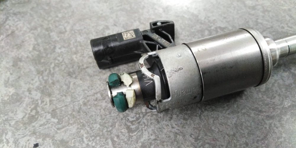

Collected the car this morning, failure was due to failed injector seal caused by loose securing bolt on number 1 injector.
There has been no work done on the fuel system of this vehicle from new.

2 fuel rail bolts had broken (one sheared of completely, the other one loose with slight damage) and injector 1 had two broken/split seals...

I've got the same issue on my Skoda Kodiaq 1.4 TSI. Broken o-ring of one of my injector due to not screwed bolt. It was causing a fire on my car with my baby daughter inside! Which is the current status of this issue? I would like to go to a lawyer with all the possible information. Thanks!

From the invoice, I believe that it had simply loosened, resulting in damage to the sealing ring.
Seems that replacement of the damaged seal and correctly tighten the bolts was sufficient for fix.
