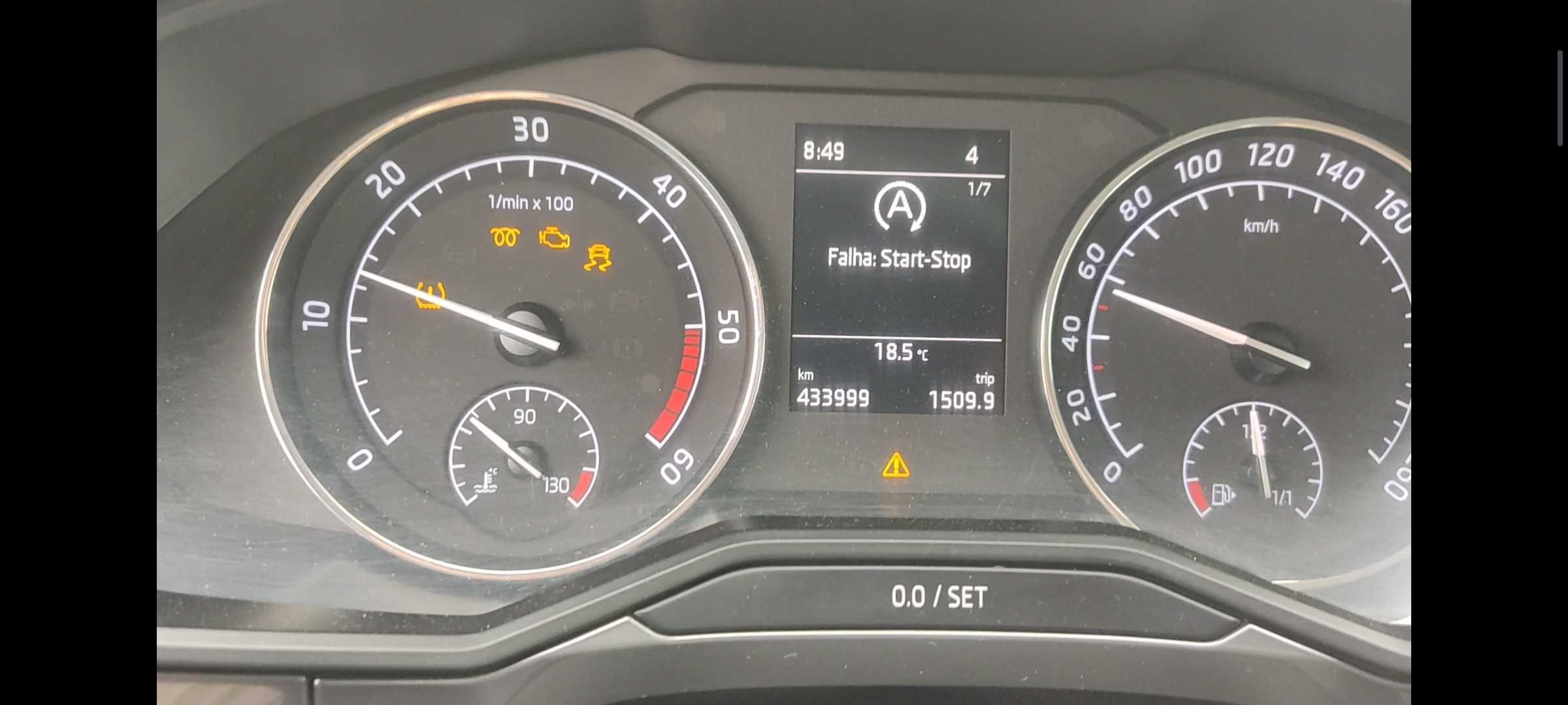

My Skoda Superb 2.0 TDI from 2017 of having some WEIRD problems.

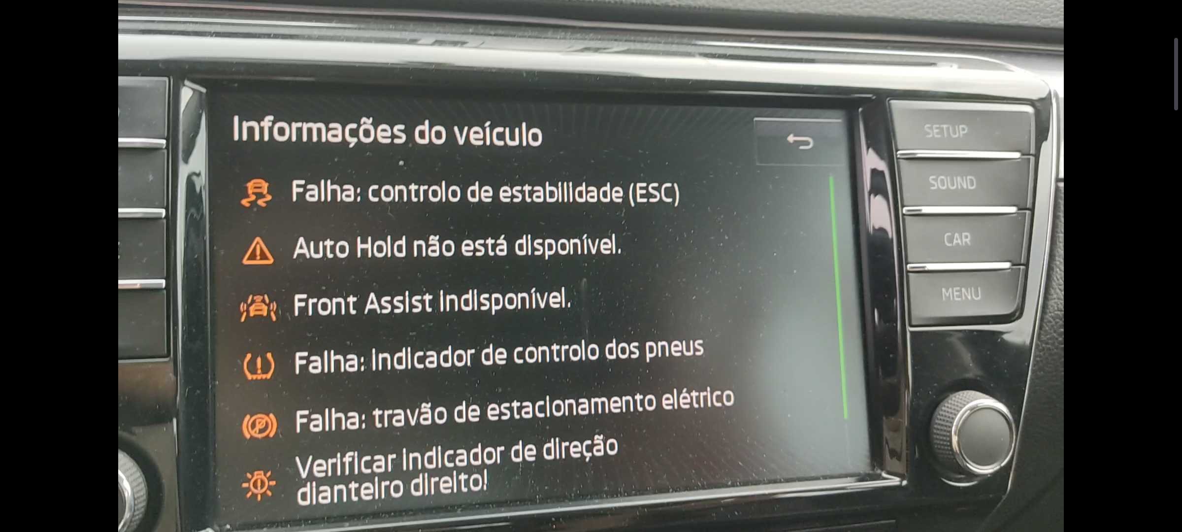

It started making like once a week when engine was warm, however now makes most off the time when starting the engine cold. When starting it takes double the time to Start, the rpm goes to almost 1200 and it gives all the fault codes on the image, sorry its portuguese but the images are the same haha
Its the ESC, TPS and resistance/glow plug light flashing on the dashboard, also says Start stop error after restarting the car to clear the codes, most off the time it clears everything after restarting except the Start and stop error.
When it happens while driving the car kind stalls for 0.1 second and gives the errors, it algo goes into safe mode, loses power, if this happens while engine idling the engine cuts off and i need to restart it.

After scan I got a bunch of passive errors related to tire management, ESC, alternator (start&stop), front assist, etc. because of all the dashboard lights as shown on the comments before.
However, only 3 active errors appear, my right front light that needs changing, key battery low and Engine Rotation Sensor - no signal, code P0322. So from what I understood, with this error the car gets in safe mode and disables everything related to traction control and safety things like front assist, a little weird but ok!
