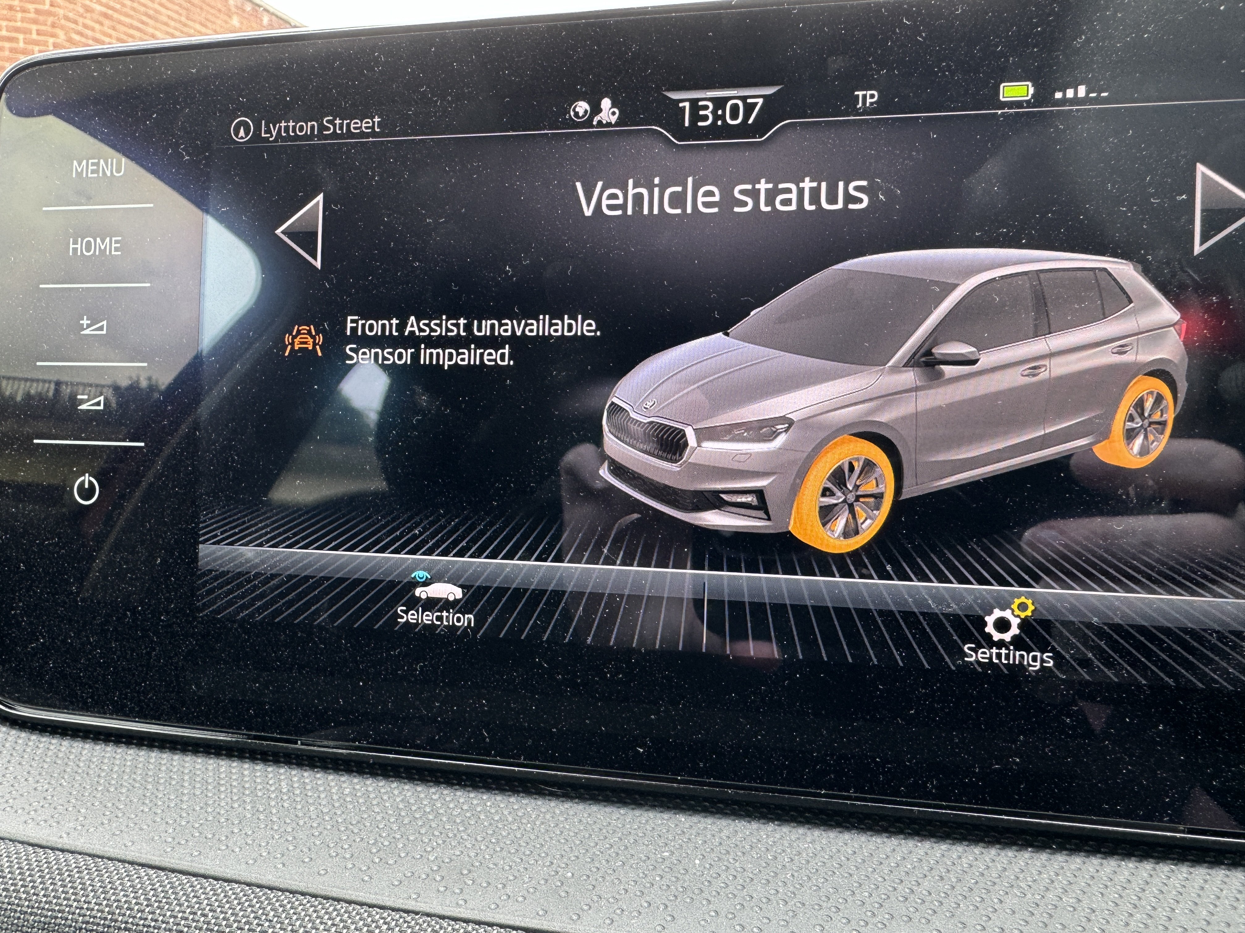

Driving today I had a bleeping noise and the usual car image in the dash this time saying front assist unavailable. It flashed off again and was left with a yellow triangle and exclamation mark. I took the photo as soon as I was able to pull over. However 15 minutes later the display said everything was ok and have a good journey!
Can you switch it off from a menu?  No point having it on if it's intermittent and could activate unnecessarily anytime.
Have you tried cleaning the sensor front ? That’s what Škoda advise in my Scala manual
Hi. It will only allow lane assist to be turned off. The only option with the front assist is the amount of warning time it gives you before it brakes. I have set it to the longest time, but can’t be switched off entirely.
Yes. The first time it happened a colleague said it might be that the sensor needed cleaning. It was clean though, but I still cleaned anyway. Still keeps happening.
