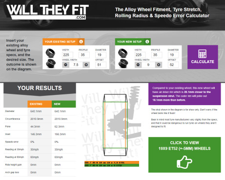

So after months of umming and ahhing over alloy decisions I'm almost decided on what I want.
I'm currently on 19" extremes with 225/35s.
Current offset is 51 and 7.5j
I have 20mm spacers on the rear and 15mm on the front. I really like the way this sits.
The wheels I'm looking at are also 19s with offset 52 and 9j.
From what I can figure out I should be able to run the same tyres (albeit with a slight stretch) and remove the spacers and the wheels should sit pretty much exactly the same.
Or am I completely wrong? 🤣 I've lost myself in numbers.

Ignoring the spacers, the inner rim will be 20.1mm closer to the suspension and the outer rim will be 18.1mm further out with the new alloys vs stock.
Compared to your current setup with spacers, that means the fronts will poke out by an extra 3.1mm (18.1 - 15) and the rears will poke in by an extra 1.9mm (18.1 - 20) so pretty close.
I'd be a little concerned about the inner spacing so I'd suggest you remove the spacers and double check you have clearance inbound...
The wheels will be sticking out a lot with them tyres on. Even with the 225 35 19 on 8j the wheels come past the tyres.

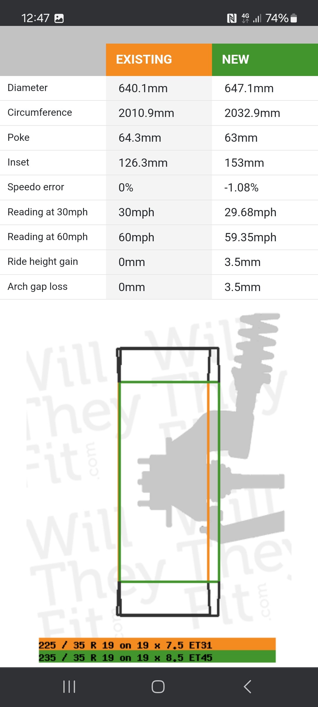

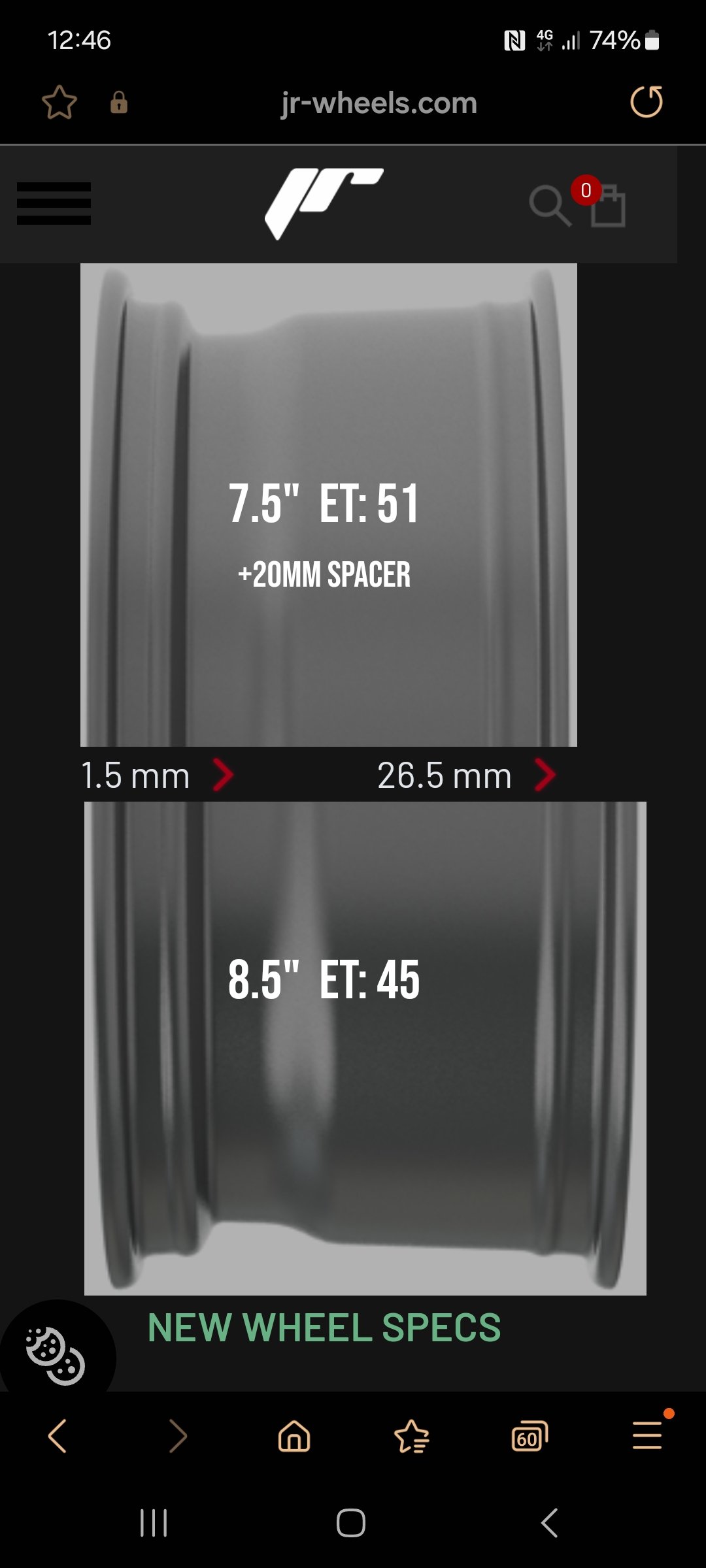

New wheels found. 19" 8.5j, 45 offset.
Willythey fit shows me they will sit basically the same as my current set up with the extremes and spacers, wheels will be about 1.5mm further in the arch and around 6mm closer to the strut which should be fine.
Would you go with 225s or 235s on this set up?
225 is the minimum reccomended so I'm thinking of just going for 235 for a bit of extra rim protection.

I'm seeing:
Rear (20mm spacer) - Inner rim is 26.7mm closer to the suspension strut. The outer rim will poke out 1.3mm less than before.
Front (15mm spacer) - Inner rim is 21.7mm closer to the suspension strut. The outer rim will poke out 3.7mm more than before.
So, the front and rears will be 6.7mm closer than OEM, and will poke out by 18.7mm more than OEM. From your current setup, that looks like a 1.3mm decrease in poke at the rear, and a 3.7mm increase at the front.
I'm not sure what the current OEM strut spacing is (it's ****ing rain here so not going out to measure, sorry!), but I found another post saying that the clearance on a Karoq 4x4 is only 10mm. Thus, reducing the clearance by 67% seems a bit unwise to me. It's also worth noting that the main issue with strut clearance is the tyre shoulder, and whilst going up to a 235 may technically increase grip by a fraction (not really...), you'll lose even more clearance, and potentially have speedo issues. That said, I'd still go for a 235 tyre, as 225 will be a bit stretched IMO, but I would personally sort the potentialclearance issue.
Depending on the strut clearance on a vRS (anyone?), have you considered doing something like a 40 offset? Doing so would mean a 235 is far more comfortable (rim is only 1.7mm closer to strut), and the only downside would be a increase in poke of 3.7mm at the rear and 8.7mm and the front.

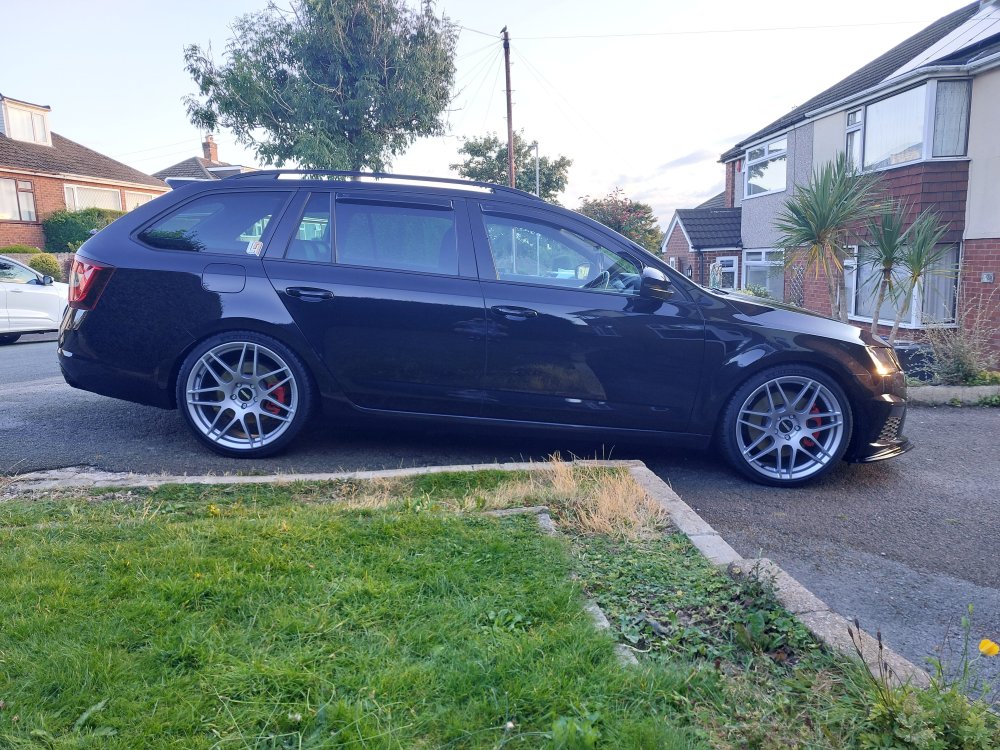

And they're on. Really happy with them. Fitment is perfect.
Sits nicely! What tyres did you go for in the end?
235's mate. Glad I did, I do like the stretched look but I don't like kerbed alloys 🤣. Not that the 235s offer that much rim protection but there would be nothing at all with 225s.
