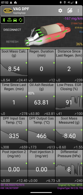

Just jumping in on this topic, I get a Regen roughly every 250km. But looking at my VAGDPF results I have a negative reading for measured soot mass. Anyone got any insight on this?
Have you manually selected an engine group in the app and did you pick the correct one? As when it's in auto for mine I don't get that panel populated
Yeah, I have 2 options for my engine. The other doesn't give any results. (DFHA 190)
i have a similar situation where the regens are triggered by calc soot so my tuner told me i either have a super clean dpf or somebody has driven a hole through it or damaged . i have finished a regen at that level but 8.5 is high and it was a trip where i couldn't get a decent run , the last regen finished at 5.5grams  (i was on the a30 and a long uphill section) that gives me 300 miles to the next one btw my egr valve has been mapped out

I would like to ask you, did you find the cause of the problem?
I have a similar problem, 2016 crtdi Superb regenerates every 60-100 km. The process goes fine, the calculated shoot mass goes down from 19 to around 5 (checked with Carista).
No never got to the bottom of it. Iv done a few 300km runs where it only re gened once. So I am thinking due to my change in driving pattern over the summer of lots of very short trips and no long trips it was just more obvious as it was regening every 5days. Now my driving in pattern has gone back to normal it's only every 2-3 weeks, but still a similar distance. Prior to the summer I don't know how far it was between regens so it may not have changed and was only more obvious due to my driving pattern change.
