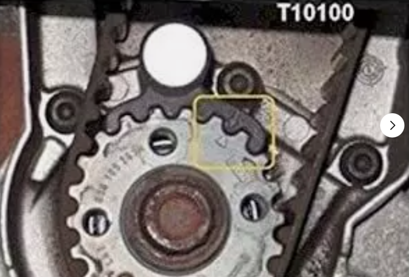

How would I know the crank is at TDC when one of the marks that  I'm supposed to line up with is on the locking tool?
@J.R., this is what I'm hoping to set up at the bottom end, then see if the pin will go in at the cam sprocket, or the marks at the back of it and head vaguely line up.
That's what I was thinking, unaware of any other marks but ive always used to tool so have never really looked. Both require taking the same amount of parts off so you might as well put the locking tool in?

Re the timing marks, I'm sure there must be a TDC mark on the crank pulley to align with one fixed on the block, perhaps it is hidden behind the locking tool on the photograph?
I'll report back once the eyeballs or camera phone have had a look.

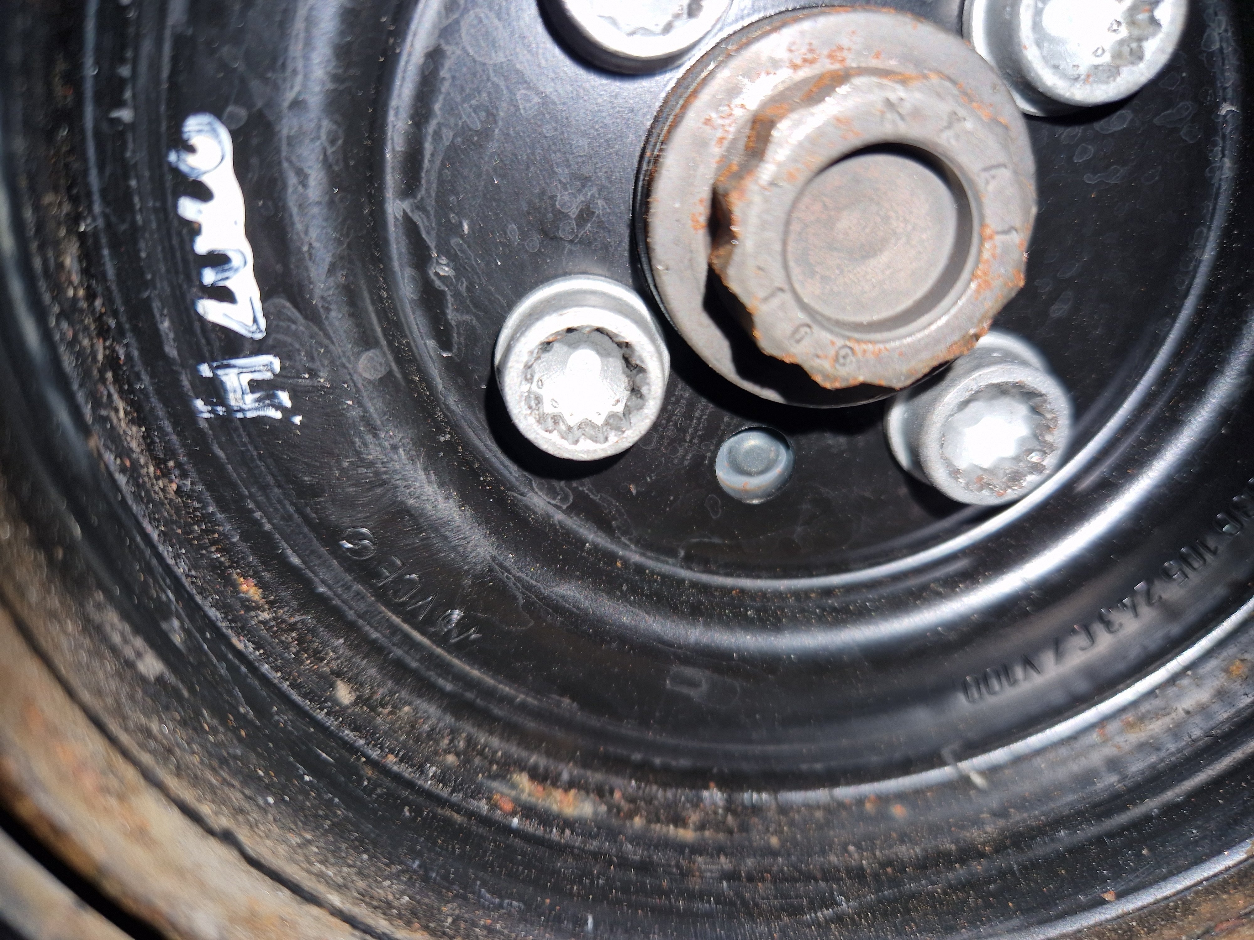

Had to take a pic to see what heads the 4 screws that hold the pulley had.
Triple-square; nice.
Pulley came off without difficulty, thankfully.

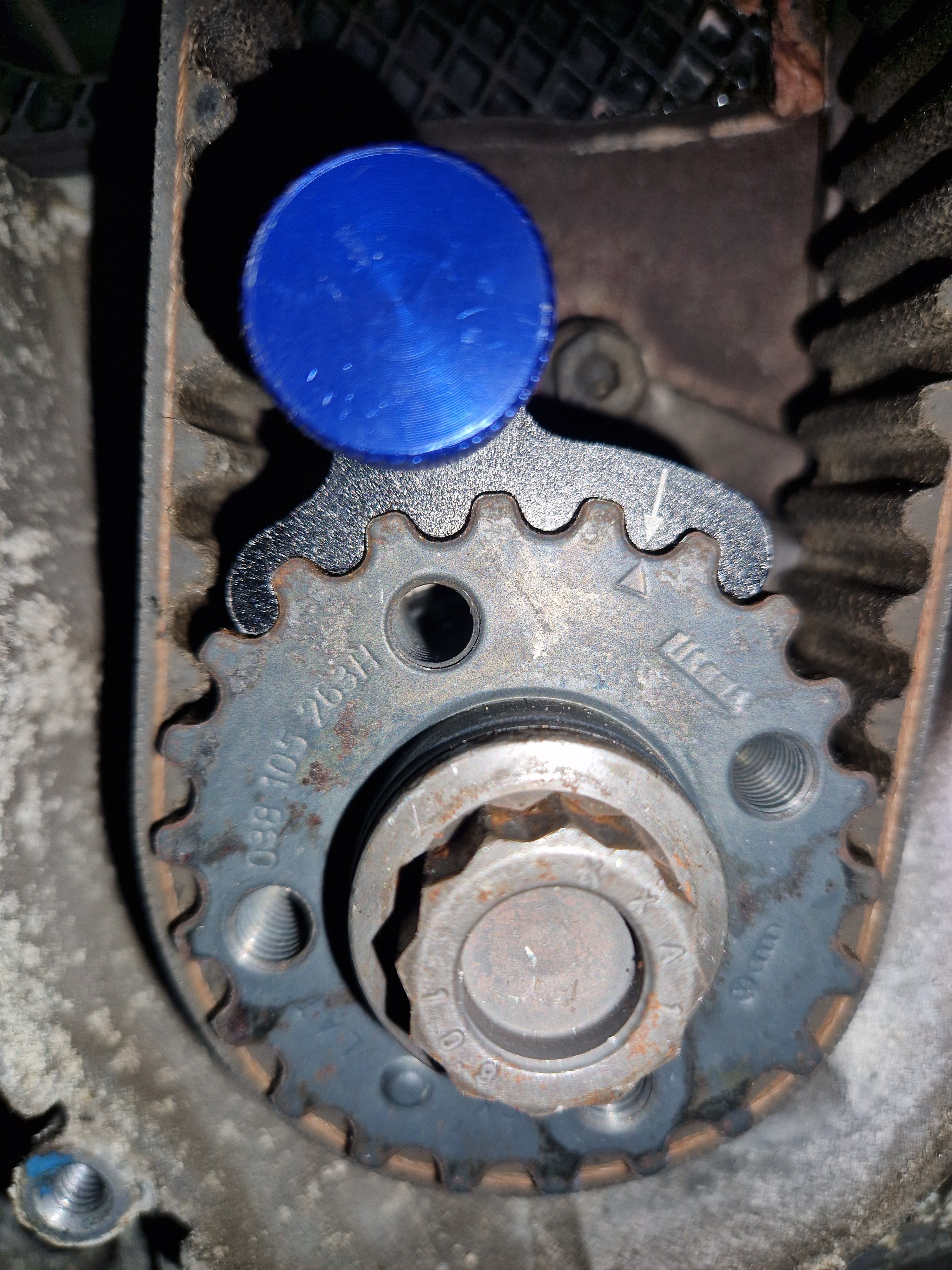

No sign of any alignment marks on the block. The little triangle/ arrow on the sprocket is visible at about 10 o'clock in tjis shot,  and the hole on the block that the locking tool uses is visible looking a bit oval, which I think is a trick of the light and shadows from photography.

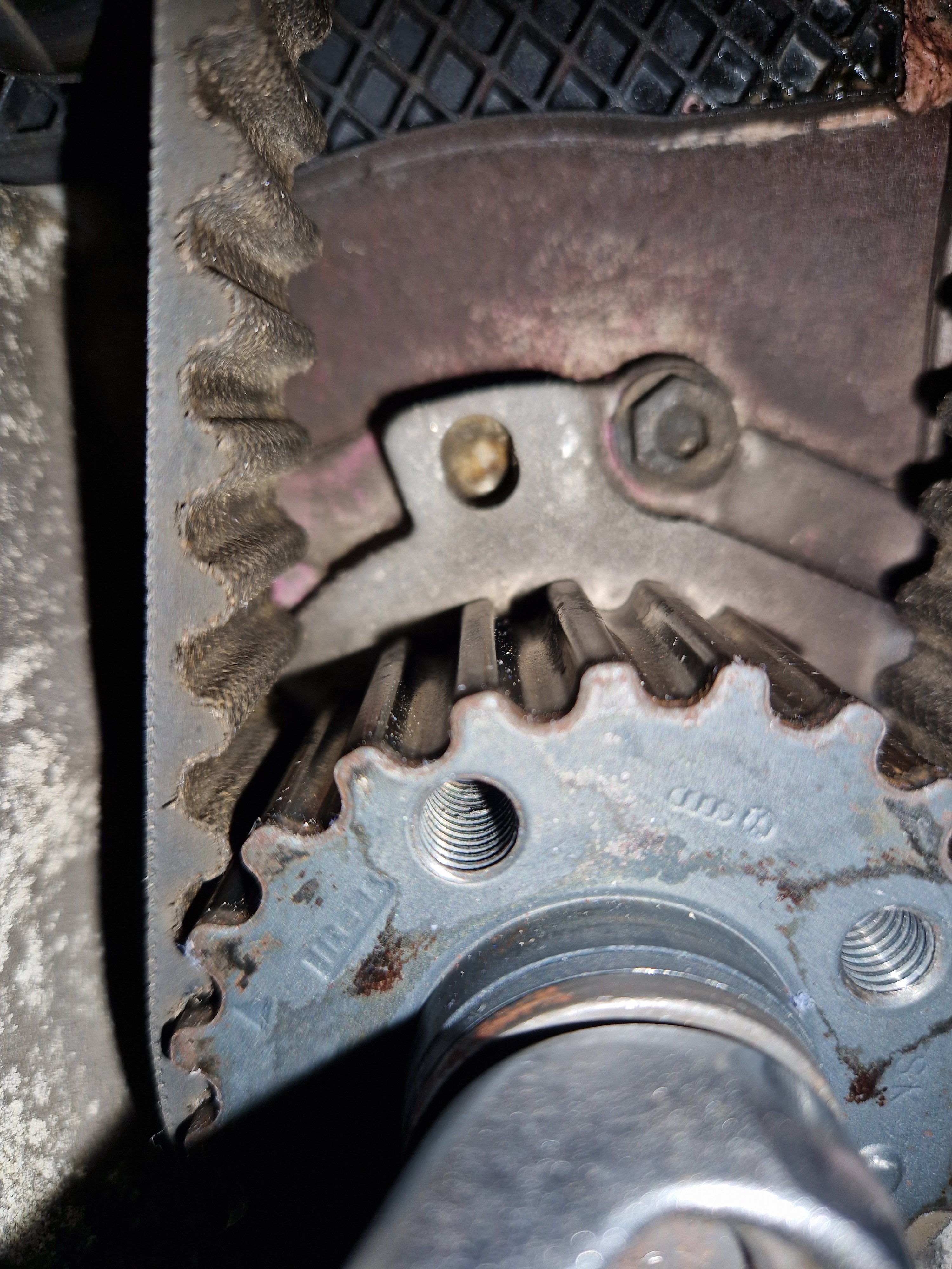

Got the locking tool in a after a while, and of course the crank needed to go another 360° before the '4Z' lined up correctly with the narrow slot on the cam sensor wheel.
2nd time lucky:
Couldn't quite get the cam locking pin in through the cam pulley/sprocket,  but I could see it was very close, although even there the visibility is rubbish! Couldn't get a photo that showed how close it was down the slot/ hole. I could get a slightly smaller diameter drill in though, so it's not far away.

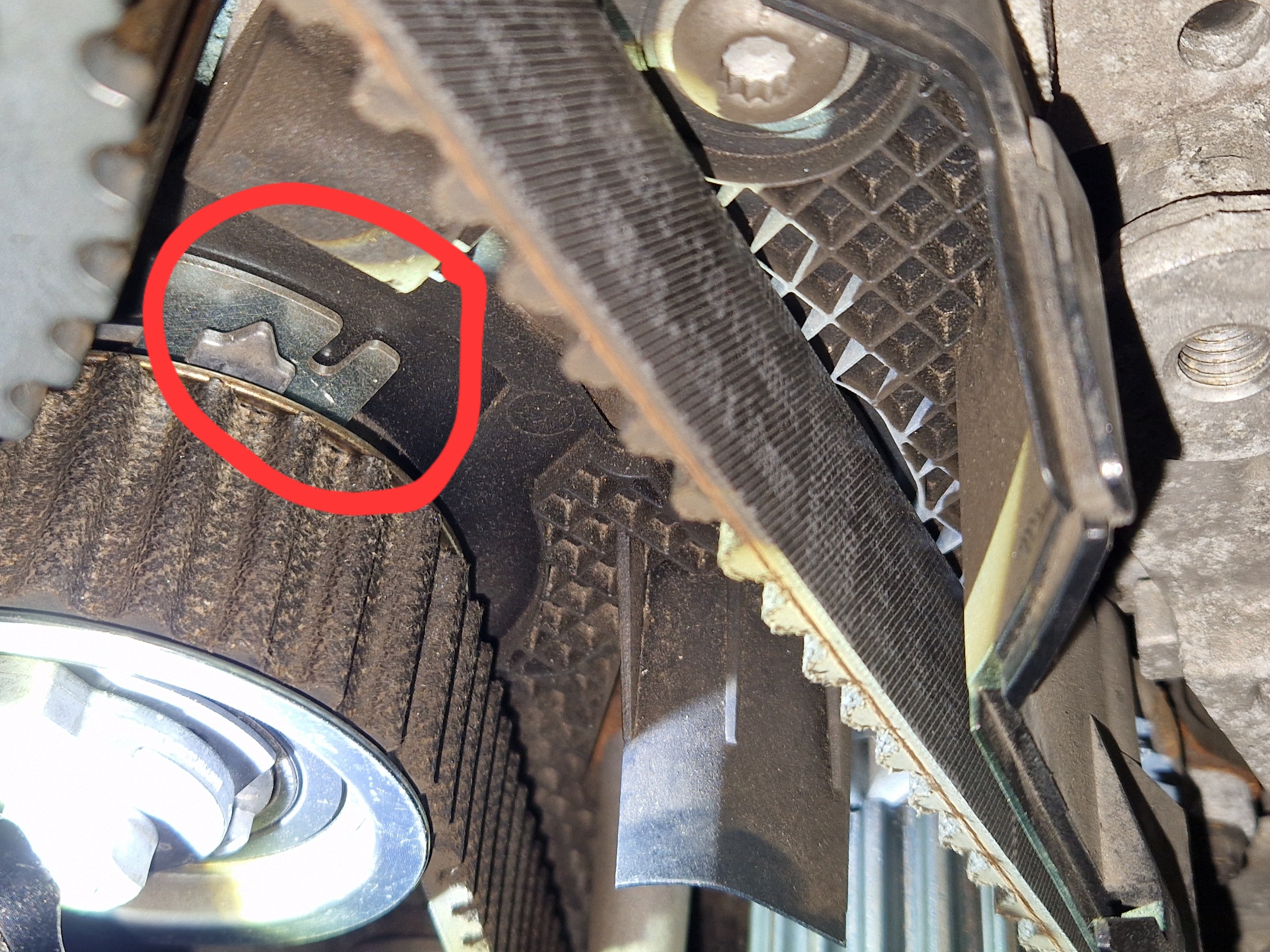

The tensioner looked to be a fair bit out, I think on the loose side, which may be the next thing to address, tomorrow.

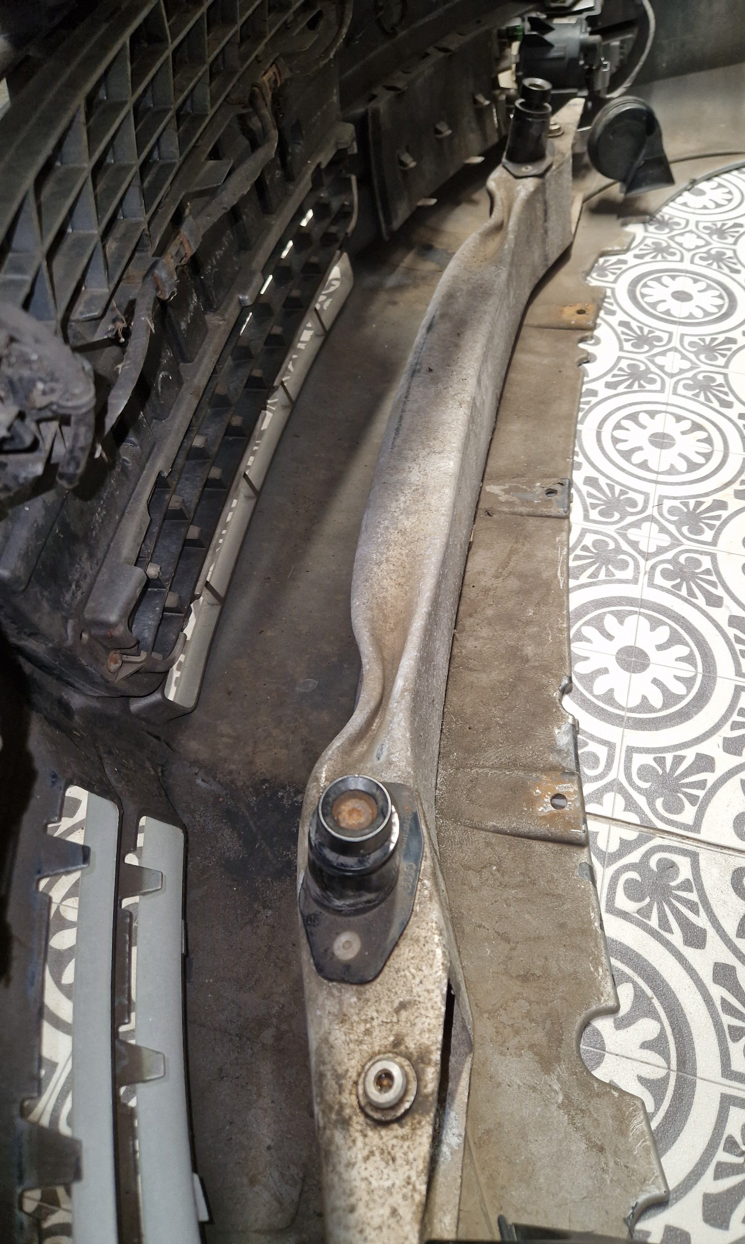

The crash bar appeared to have suffered from an impact. First I thought,  hmm Eddie never mentioned crashing into something. Then I remembered the muntjac, and thought "didn't think it was that much of an impact".
Then I started looking for replacements an found that they all look the same; as do some of the new aftermarket ones, so maybe this is just how they are??
I think it must be like that when new, it looks to be perfectly symmetrical.
An intended area to give in certain direction in the event of collision maybe?  I could see it pulling things inwards to crumple away rather than towards any impact area.  Just a guess mind.
