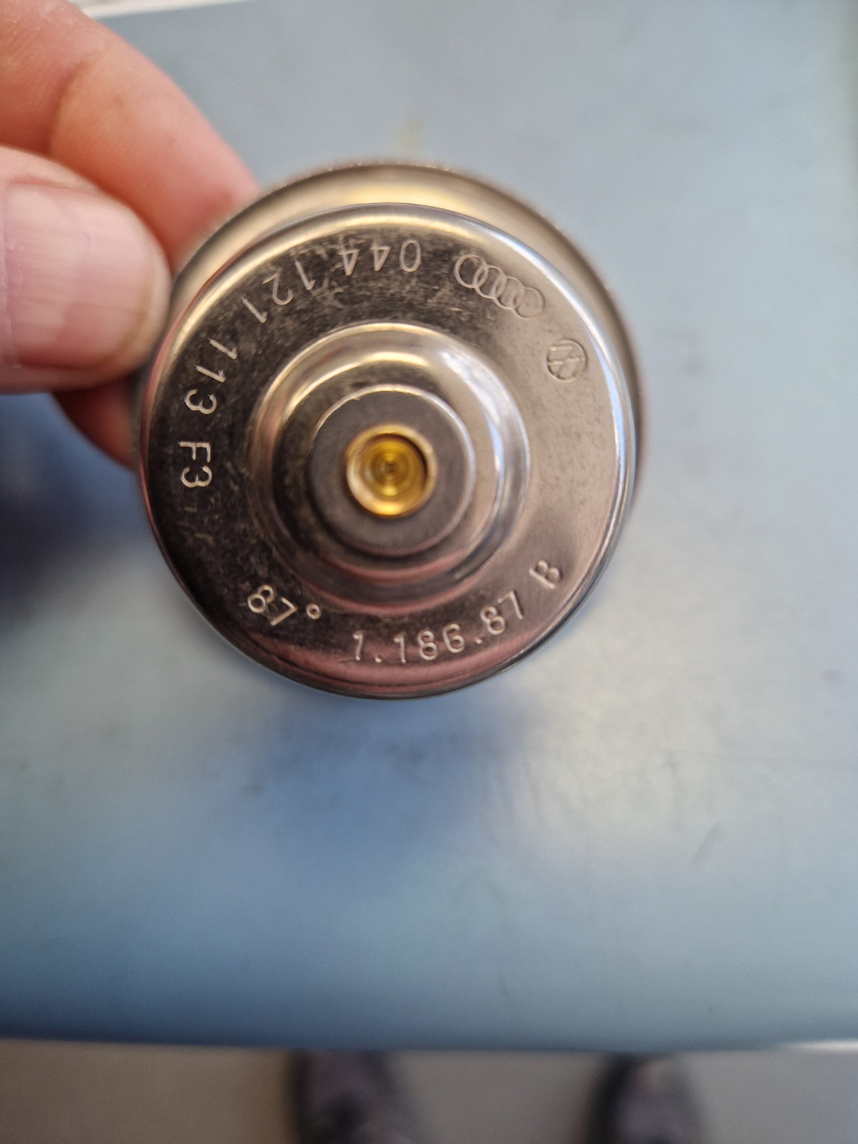

FWIW this genuine one is made by Bremi, who made it in Germany according to other stamping on far end (also 'BTT').
The 1.186.87 B is what told me Bremi.
I paid £33 delivered, including o-ring from an eBay seller.
Does seem to work when dunked in boiling water. :)
