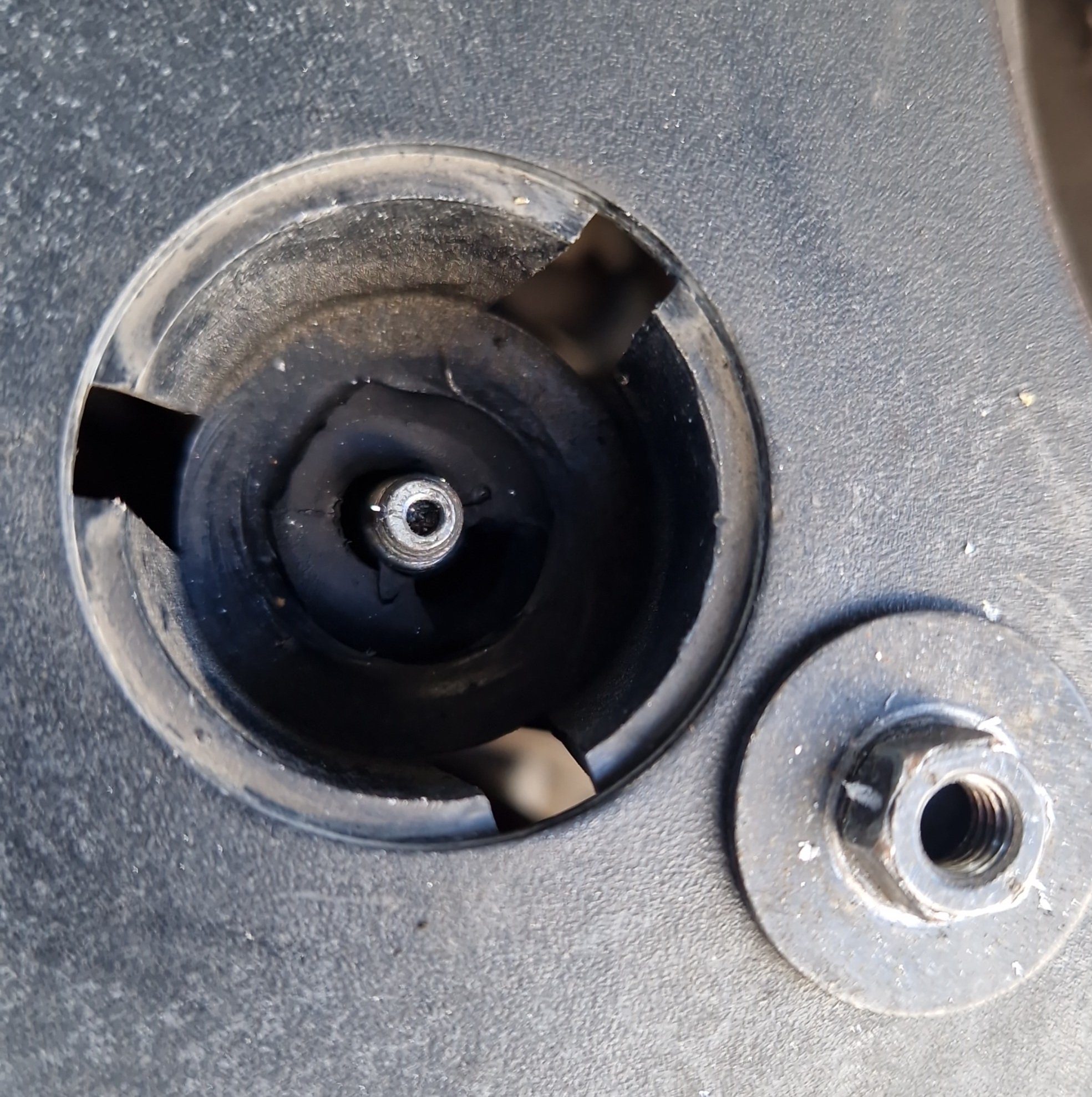

1 hour ago, Breezy_Pete said:
Beat the spinning engine cover nut by drilling and tapping an M3 thread in the stud, and sticking a screw in it to counterhold.
Credit to workmate Richard for that idea. :)

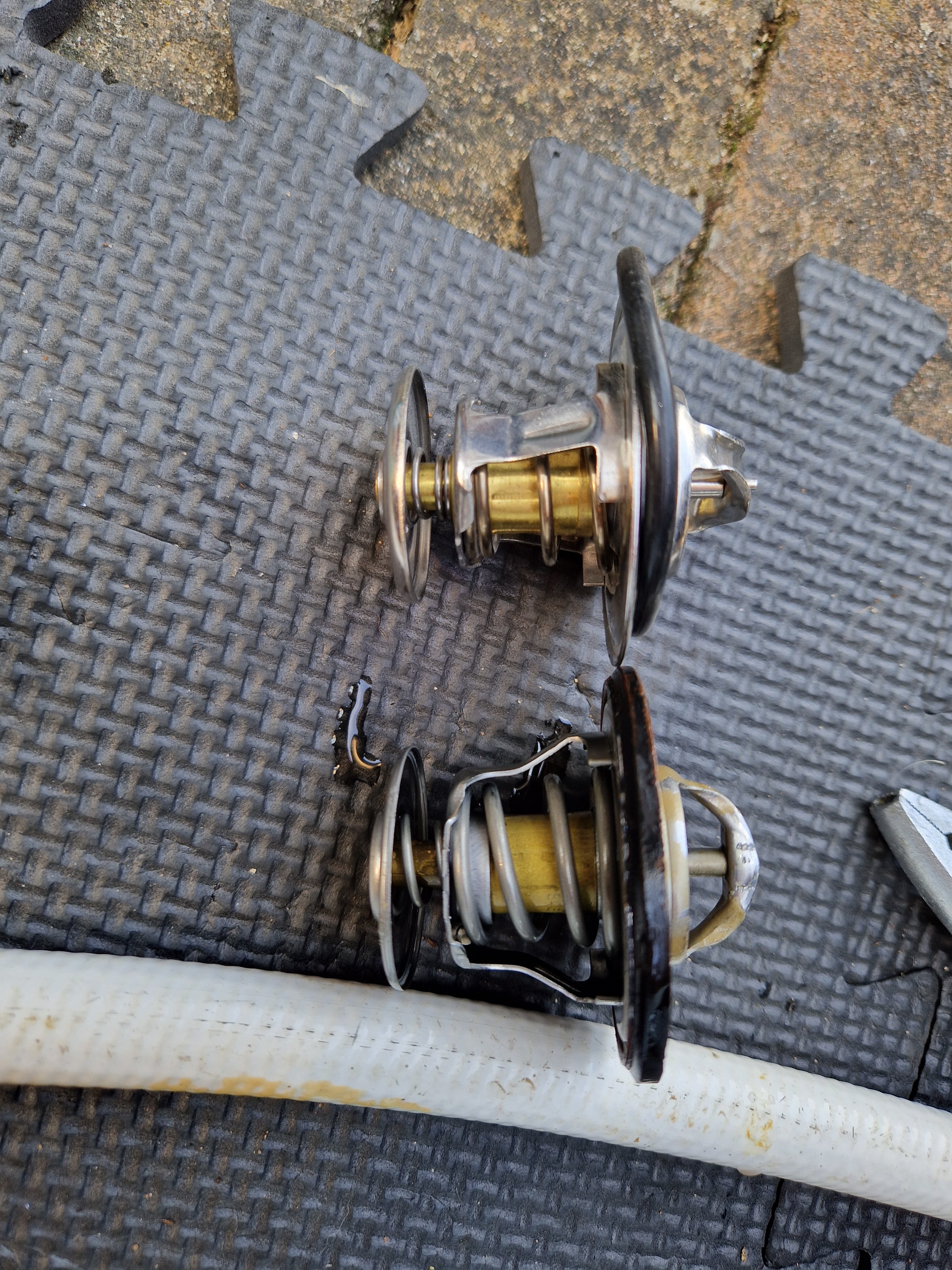

34 minutes ago, Breezy_Pete said:
There was a stat in there,
I win, I win, Yaaayyyyy!!! 😁

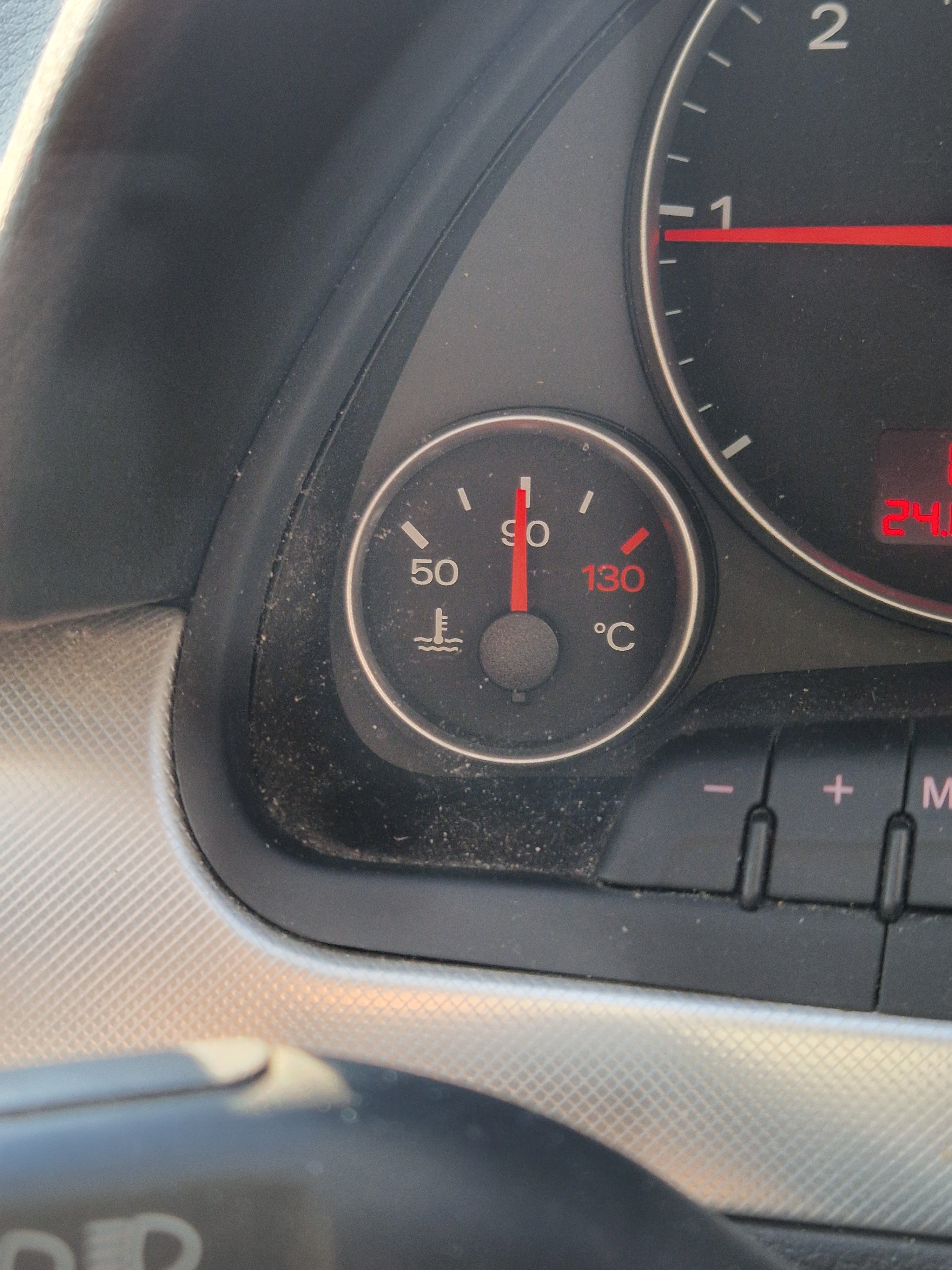

3 hours ago, Graham Butcher said:
That temp is now spot on.
As is every other VAG vehicle produced in the last 1/4 of a century, the temperature has to be well above or below for it to indicate anything other than a rock steady 90°c.
I miss being able to see the micro fluctuations, since owning a Triumph Stag I have always driven with one eye on the temperature guage (not easy when you only have one working eye!) which has been pretty pointless for the last 25 years.
But not in fact, when the waterpump leaked on the Stag I avoided warping the heads as I noticed a micro fluctuation overtemp where there should not have been one, I stopped immediately even though I was only a few hundred yards from home, checked everything, allowed it to cool, refilled and drove home. Given that I now wont see any indication of overtemp until it has reached at least 110°c its even more imperative to check the guage all the time and to stop immediately if it rises.
4 hours ago, Breezy_Pete said:
There was a stat in there, old below new
Slightly surprised; I honestly thought the description sounded more like "no stat".
Or, at least, somewhere between 50 and 110.
If your Yeti has Maxidot then the display can show oil temperature which may give you an indication.
Given your knowledge I'm sure you could also jerry rig a coolant temperature gauge somehow.

On 16/09/2024 at 21:05, Breezy_Pete said:
The sound insulation on the underside of the engine cover had done a nasty mix of falling off and disintegrating,  covering the engine in black foam dust, now largely vacuumed away.
There's an almost new roll recently listed on Facebook Marketplace and loads available on aliexpress.com.

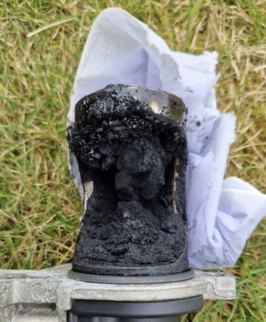

21 hours ago, Breezy_Pete said:
As expected, (electric) EGR valve not looking pretty at all
EGR = Exhaust Gunge Recovery? :)
8 hours ago, Breezy_Pete said:
Hope so; but my optimism doesn't stretch to imagining that the inlet valves look more like the second photo than the first.
The throttle valve looks a lot better, upstream of the soot source,  but still getting a clean later.
I agree but its amazing how well they continue to run and have undiminished fuel economy or power in all but drag race conditions, todays schmoo does not seem to smother engines like back in the day when a decoke was needed well before 40K miles.
You are lucky that the throttle valve is upstream, mine was much peppier after I de-schmoo'd it but the ports and valves will no doubt be like yours yet its coping with the extra power after the remap.
