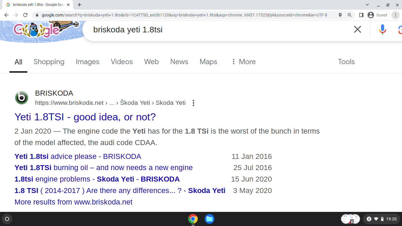

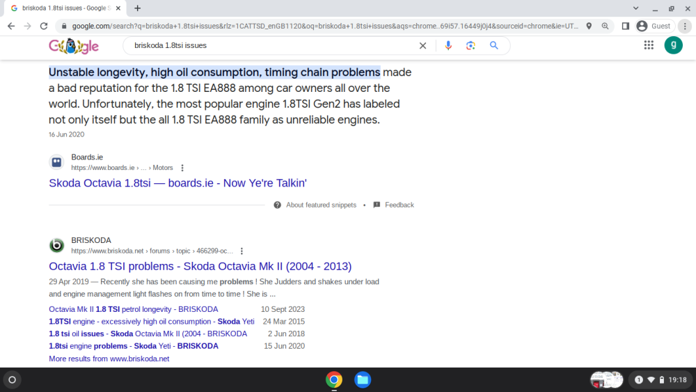

Sadly the 1.8 TSI is the engine to avoid.
Obviously everyone can not be bad, some might have had replacement engine, or a rebuild, or have just been looked after and lasted till now.
But!
