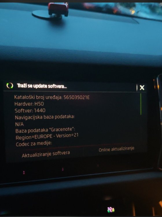

Is any chance to check it if this is high or standard? In standard GPS won't work without sd card?
Sorry I'm confused now..

MIB Standard (Low) Navigationssystem need SD Card With Maps
MIB High, Navigationssystem Maps is on the intern memory.
Edited by Cairus
But I used sd card to update maps and don't know if this card is needed now. It's normal sd card without skoda/vw logo like I've seen few times somewhere.
Take Out the SD and Check, Navigationssystem is working
I removed both my sd cards and GPS working normally

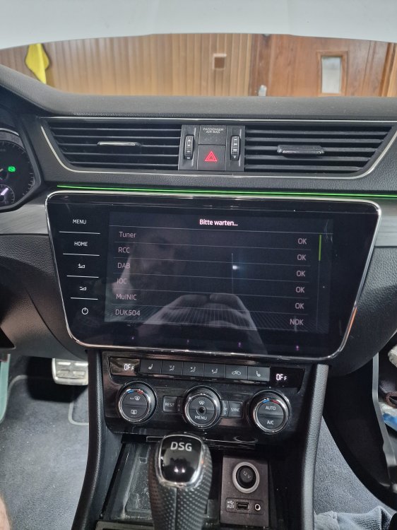

So i just did the upgrade, and looks like it stopped right before the end. After swapping the screen it switched to german language, using translator i pressed skip and now its stucked here, please wait
Any ideas?
EDIT: So after about 1,5 hours of waiting and searching online i decided to pull the fuse to restart the head unit and it finished the update, rebooted and started to work

On 28/01/2026 at 21:03, Kosin said:
Ok sl
Which fuse did you removed because I've got same issue screen stuck in same place but still have eng lang. And during this proces I didn't skip anything don't know why I mean this message doesn't show up everything was just keep going.

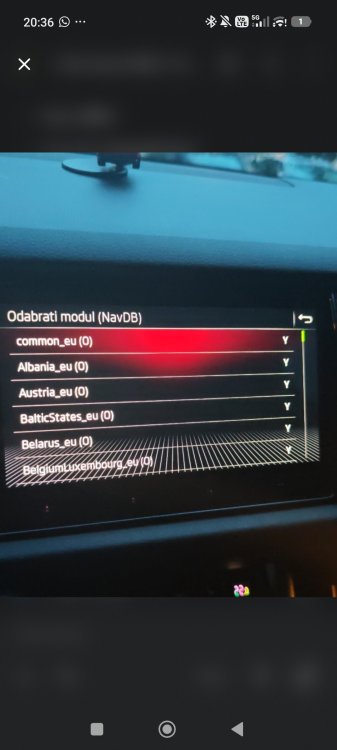

OK I found it everything working except maps Can someone tell Me How to install database? Got error navigation database not available and of course I've got sd card with maps.
// found it sorry :)

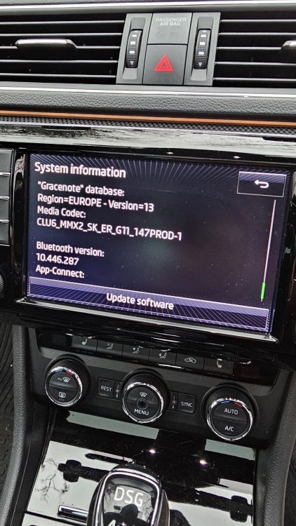

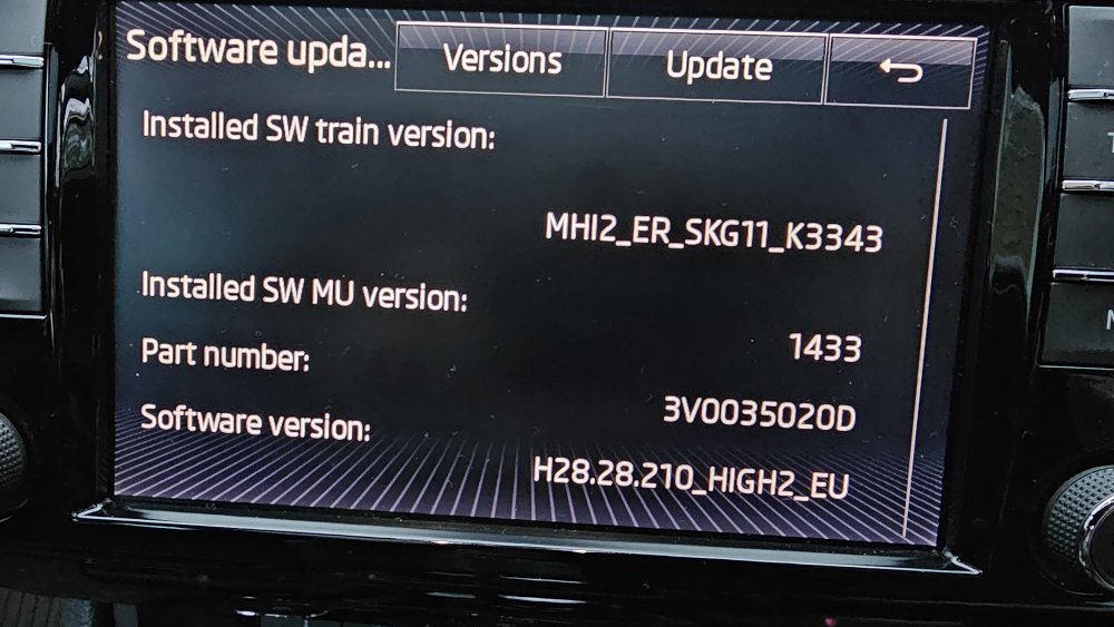

Anyone can help me with some info of how to update the MIB2 to the latest version before I try and upgrade the unit to a MIB 2.5 ? The car has a Canton audio system, don't know if that makes any difference.
Edited by LeGrumpy
I have posted the wrong photo, and MIB-helper says that this is the latest version. Anyone knows how accurate that is ?
Edited by LeGrumpy
I had the same one before the update and now everything working fine. I mean I hope it working because I did it yesterday and till now no issues 😂
Good to hear. I can now buy the MIB 2.5 without issues then haha

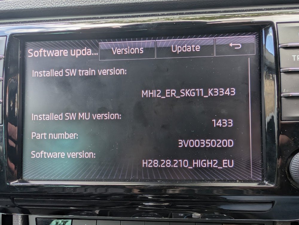

The only one problem I have is that I can't make adaptation with confirmation of installation change. After I do the xor numbers I write it to change confirm and it going back to previous numbers.. It's like not saving what I changing don't know why. I'm definitely sure it was working before when I updated old version to 1433 (before screen swap year ago).
So you think that is because it might need a proper coding ?
