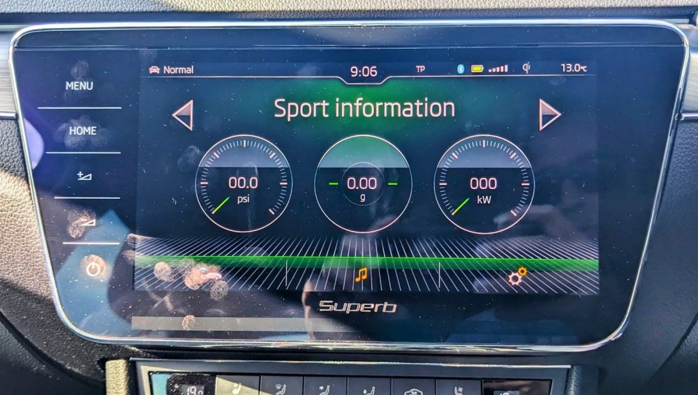

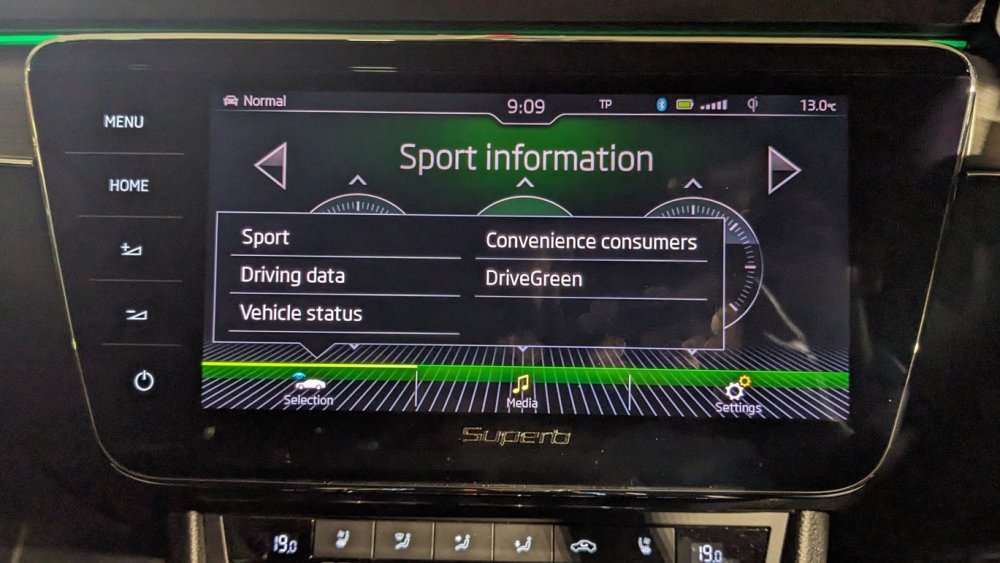

  • found another feature "unlocked" as a result of the MIB2.5 conversion - Sports (Performance) Monitor!!  woOot normally this only enabled on Sportline models.
Dragging this up, was looking for firmware updates and came across your thread. How did you get the performance details on yours?
I have the MIB2.5 I believe from factory but do't have this, do you need to have it in sport mode, not individual?
Not to worry now @JR RS I used your manual and upgraded the firmware on my MIB2.5 unit, went from 1163 to 1440 so a nice jump and also the Sport function is there now.

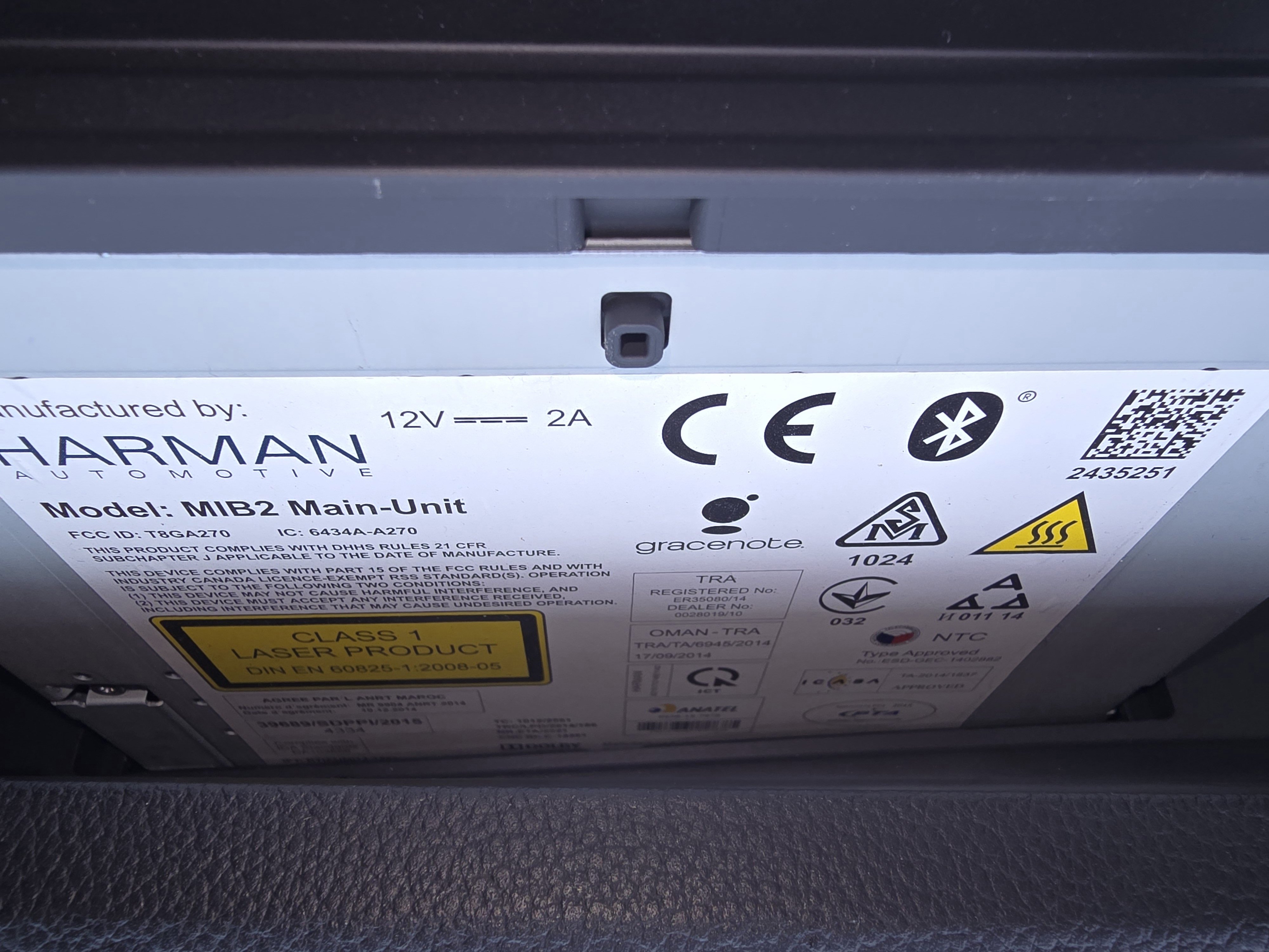

Hi,
I want to know if I have mib2 main unit 3v0035020d with 8 inch screen (buttons on both sides), do I have to buy mib 2.5 main unit if I want to change screen for 9.2inch like this one from link:
Link here
Thank you for all answers.
3 hours ago, Aadain said:
Hi,
Link here
I didn't change the main/head unit in the glovebox.
That's the whole point of this AIO firmware upgrade - upgrade headunit + change screen.
So by only update software you change mib 2 to mib 2.5 I'm right? I thought we have to buy main unit so it looks easier then.
Yes, provided u have the right headunit to start with. Should b MIB2 High Harman version.
Mine was 3V0 035 045 D.
Mine is harman too check attach. 3V0 035 020 D
Mine is Harman Mib2 main unit 3v0 003 5020d
I'm not sure but I have mib2 standard version not high? High have internal memory and I've got maps on sd card so can't make this upgrade no?
Correct
