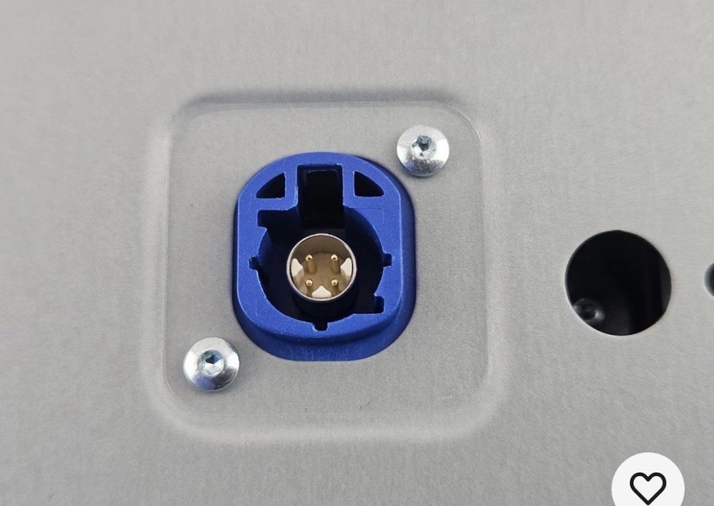

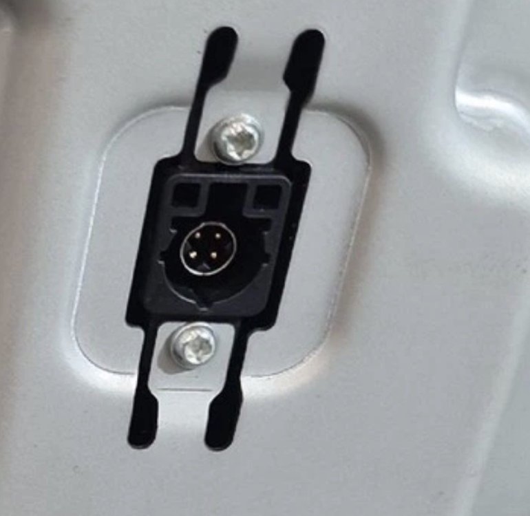

The screen is on its way. Looking at photos it looks to have a different plug. Assuming part numbers and looking at eBay listings it looks like my current 8” screen has the blue plug and the 9.2” has the black plug. I saw on a golf forum about shaving down a bit of the existing plug so it fits. Is that correct, It’s not listed in @JR RS guide.
Edited by Binx1310
Yes, Cutter and 1 Minute Work
Ok great thanks. Glad I’ve not bought an incorrect part!
@Binx1310 - both my 8" Columbus and 9.2" Columbus have the same black connector, so there was no need for me to trim/cut anything - hence not in my how to guide.
Interesting... in both of our Skoda models, kodiaq & Octavia 3, the 8-inch displays have the blue connector, while the 9.2-inch displays have the black one.
Looking at eBay items it looks like it’s part number dependant and the difference between std and high.
Both 8 inch screens that look the same
3v0919606 - black plug - high https://ebay.io/m/mzqBAe
Looks the same as
3v0919605a - blue plug - std https://ebay.io/m/YnuE5m
So looks like mine will be black plug. I was just assuming by how the screen and buttons looked. Didn’t realise there were 2 different part numbers that looked the same from the front!
Looks the same as
they aren't both 8" though? One is 8" and the other has a 6" screen - it has a massive bezel around it.
(also I sold my 3V0919606 for £40 on eBay so you can still get something for them)
Edited by nick6262
