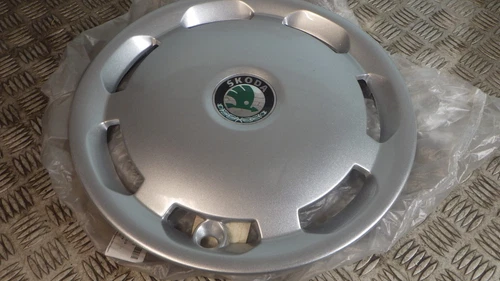

5) If you can get these wheel covers 1UO 6011147C and get some new centre badges off Ebay they do the job a treat. (See my post in Fabia register)
Maybe check that p/n you wrote down, it looks like there are too many digits, maybe just "1" needs removing, I remember looking into VW small van steel wheel centre covers initially when I bought these Alcar steels for my wife's Polo, but had to give up and get a set of easy to clean, okay to look at, wheel covers.
Ie 1U0 601 147 C
Edited by rum4mo

Skoda wheel trim 15" genuine new 1U060447C - Picture 1 of 4
Could you tell me where you got yours from please?

1U0601147C
1U0601147C are Octavia MK1 wheel trims which are made to fit Alcar 8380 6Jx15 ET38 5/100 57.1 steel rims (not Alcar 7760), as shown below. They might fit the Alcar 7760 steel rims, but they don't look correct for the more modern Fabia MK3.
Alcar 8380 6Jx15 ET38 5/100 57.1 steel rim (from Octavia MK1) (8.85kg)
ALCAR 8380
https://www.mytyres.co.uk/rims/details?vehicleId=180274277222716516&rimCode=ALCAR8380
