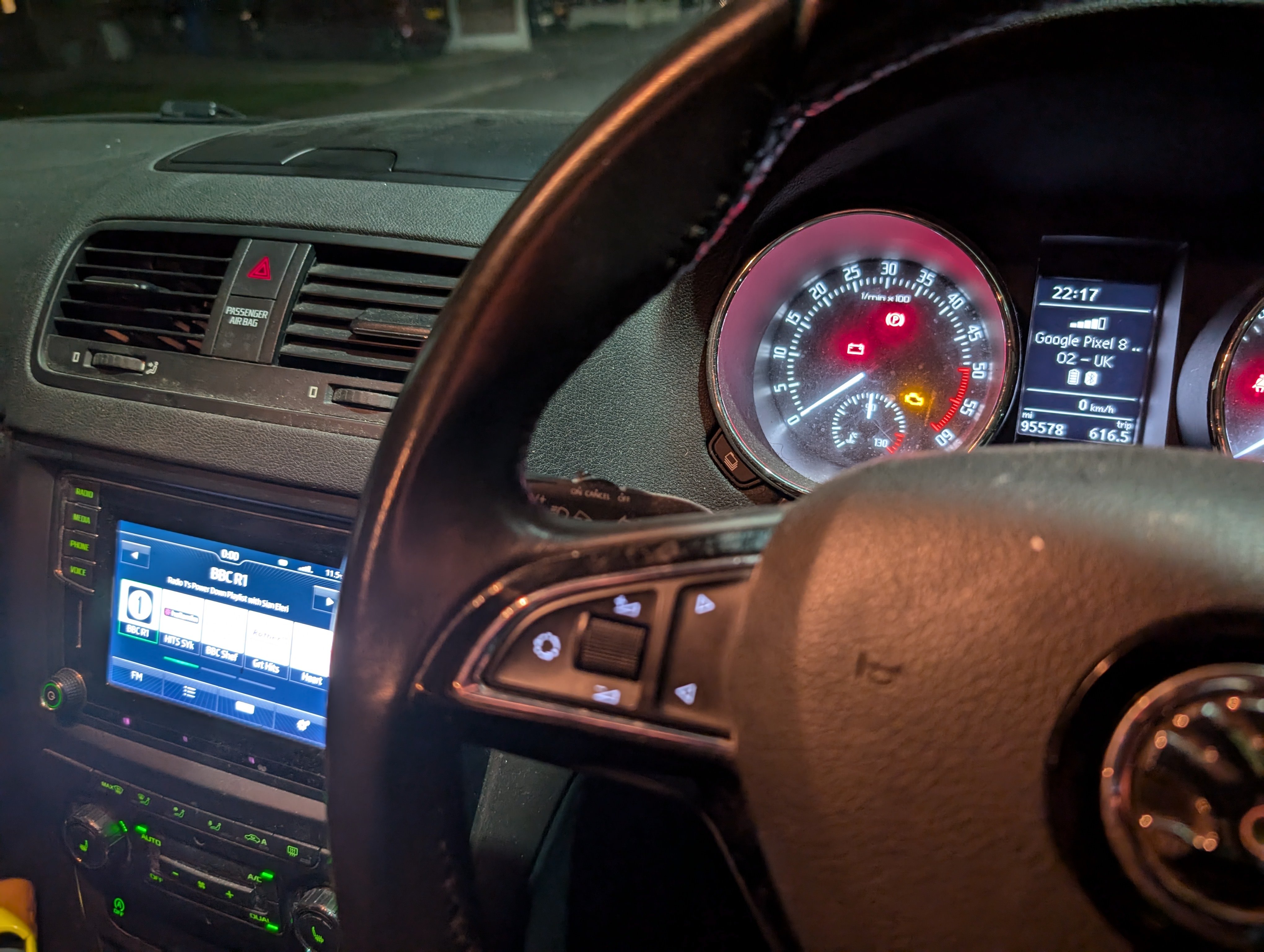

Good evening all
I have a 2015 Skoda Yeti 2.0
In the last week or so my dash clock has remained but my radio clock has just gone to 0:00 and stays at that ...does anyone know how to reset this to be re-synced with the dashboard clock ...
I've tried pressing and holding the on/off button ...I've also factory reset on the radio settings ...but nothing is helping

I have the exact same problem on my Yeti. The dash time is correct. The clock on the radio restarts at 0:00 every time I start the engine. We did do a software update recently and I wonder if that could be the issue. Can a software update be rolled back?

I have recently noticed my 2015 skoda yeti outdoor 2.0d has developed the same issue !! Infotainment clock will not change to the correct time as displayed in the mfd screen. Flicks between 12.00 and 12.28 now and then but usually sits at 0.00. Tried reset etc all to no avail … has been regularly serviced by main dealer who say they have not heard of this issue before and have no idea! It is a bolero unit ( no sat nav) I despair ! Any help will be gratefully received !
