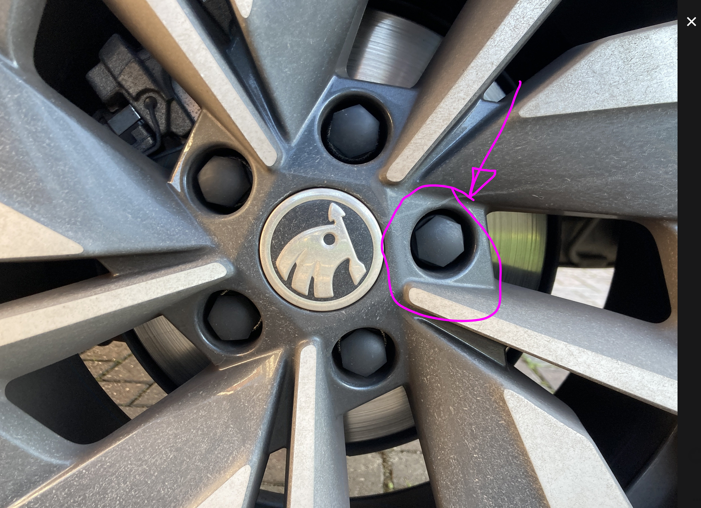

The nut cover on the locker is different from the normal nut covers.
You can tell just by looking.

3 minutes ago, chills said:
Mine all look the same
Either the picture angle, or you don't have lockers!
The cap heads all look similar, but the actual body that goes over the bolt is hexagonal on the normal ones and circular on the locker.
3 O Clock position.
Look behind.
Thanks. AG Falco
4 minutes ago, AGFalco said:
3 O Clock position.
Look behind.
Thanks. AG Falco
Thanks. Now I understand. So it is not that obvious.

No they don't. This one is your locking wheel nut.
