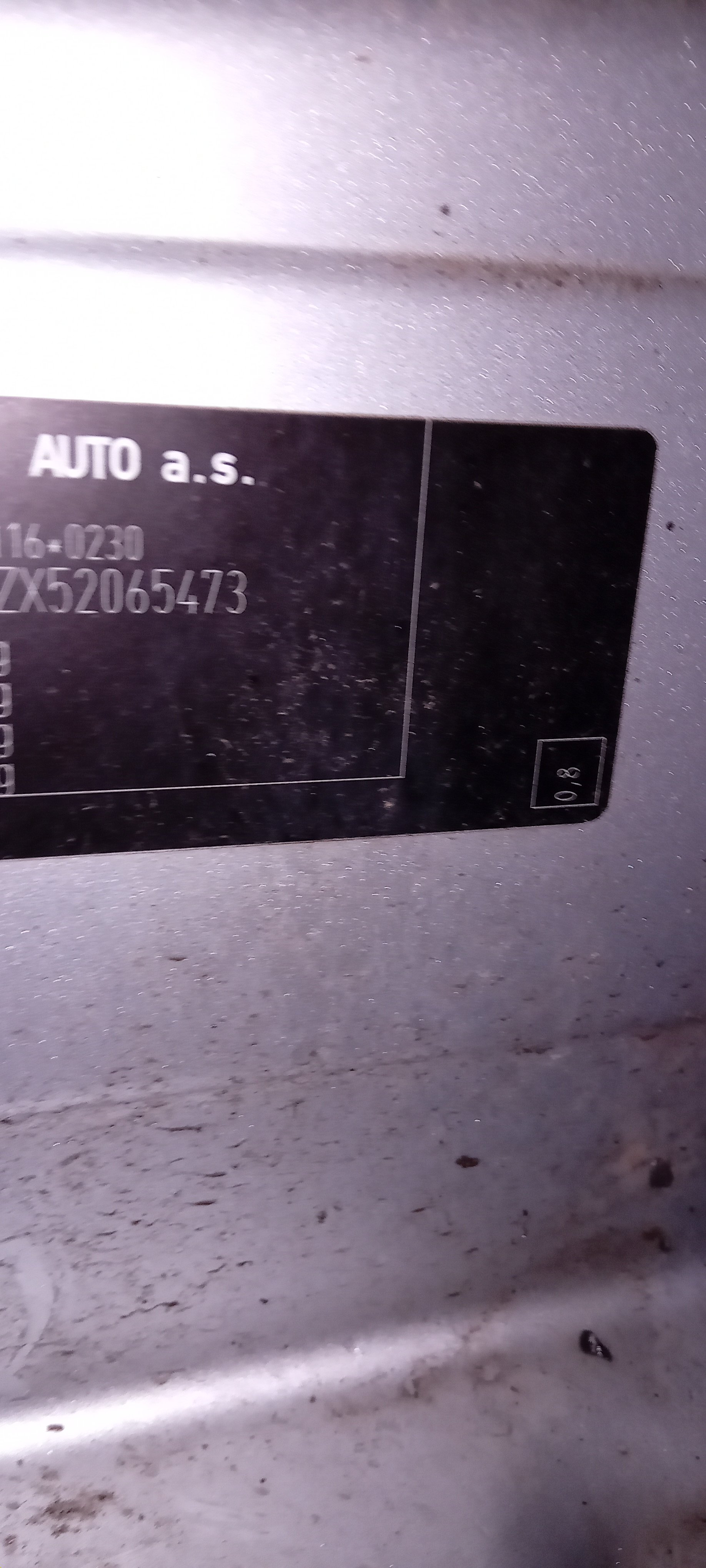

Metal plate in engine bay, or occasionally on B pillar.
Has VIN on it too. The smoke value is often in bottom right corner, and it should be in a rectangular box.

This time they used the plate figure, so 0.8 was what the car had to achieve.

On 30/11/2024 at 18:38, Breezy_Pete said:
Plate value is what they should use 'if it can be read'.
The wording in the test manual isn't wonderfully clear though, so the default limit is often mistakenly used. My A4 seems to have been tested to different limits almost in alternation.

This is the exact wording of the test manual, for diesels of around this age.
I'm not surprised that some testers don't get it right if they skim read straight to "For vehicles first used before..."
Before the test, check the maximum smoke level limit for the vehicle and enter the required details into the diesel smoke meter.
The maximum smoke level limit will be the level displayed on the manufacturer’s plate; or where there is no manufacturer’s plate information:
For vehicles first used before 1 July 2008, the maximum level is:
  • 2.5m-1 for a non-turbocharged engine
  • 3.0m-1 for a turbocharged engine
For vehicles first used between 1 July 2008 and 31 December 2013 the maximum level is 1.5m-1 for all engines.
  • Sponsor
Source of the above, https://www.gov.uk/guidance/mot-inspection-manual-for-private-passenger-and-light-commercial-vehicles/8-nuisance#section-8-2-2
Unfortunately there's a sentence even further down the page than what I quoted, referring to retests after fails on emissions at plate figure. Retests must be done at same figure.
