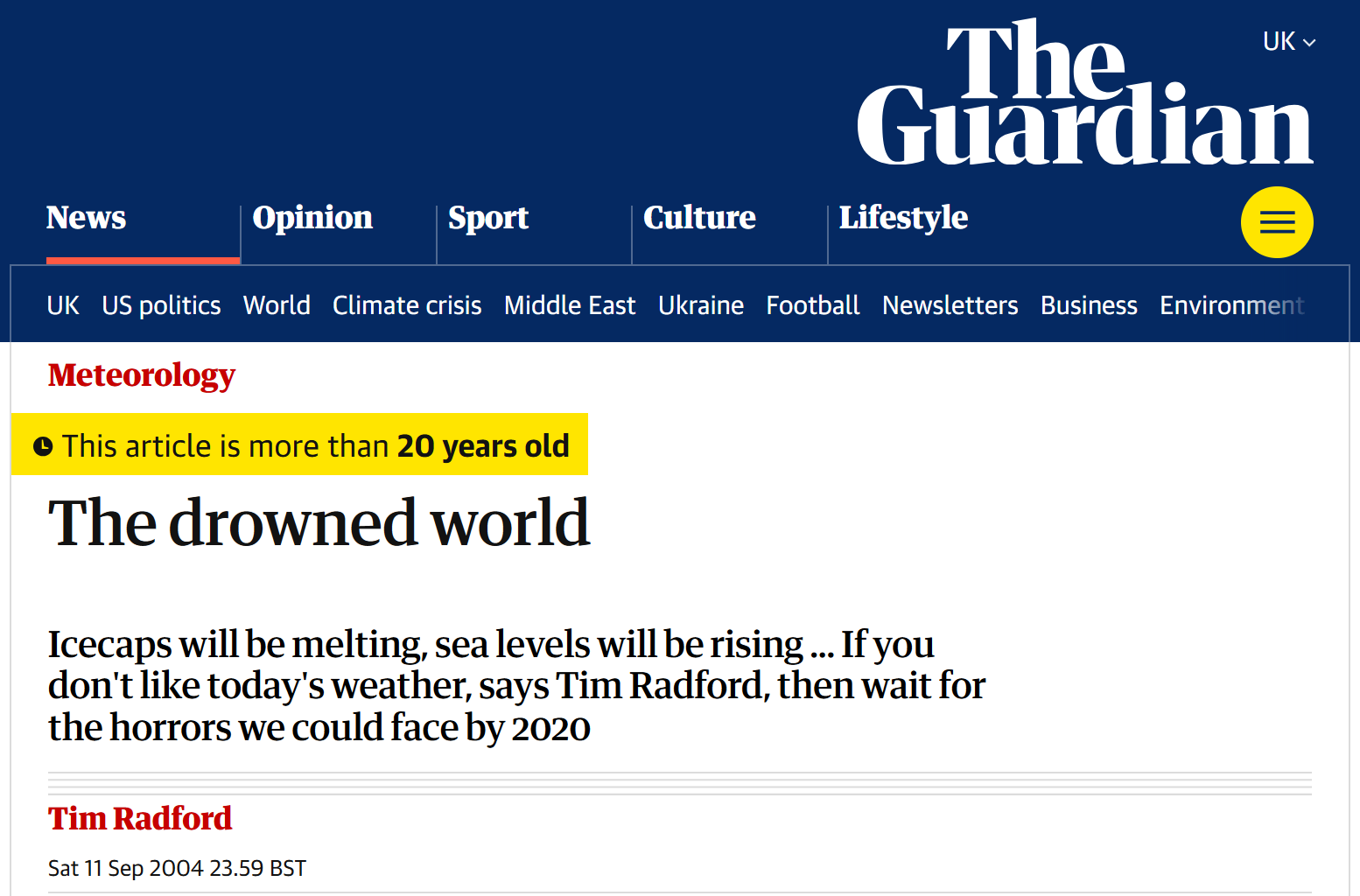

Here's another trip down memory lane. A prediction for 2020.
https://www.theguardian.com/science/2004/sep/11/meteorology.scienceofclimatechange
