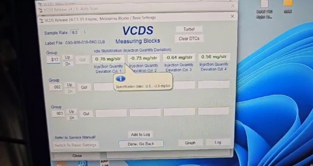

  • The good news - with the EGR fix and clean there is a definite improvement in performance.  Things I must have got used to before, and only noticed today by their absence, are gone.  Such as, slight h

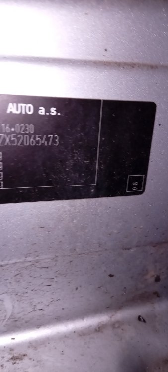

Are you able to check your actual plated value - is it 0.8?
  • Sponsor
Plate value is what they should use 'if it can be read'.
The wording in the test manual isn't wonderfully clear though, so the default limit is often mistakenly used. My A4 seems to have been tested to different limits almost in alternation.
Where, without wanting to sound like a total banana, would I find it?
B pillar on driver or passenger door opening normally with the weights.
