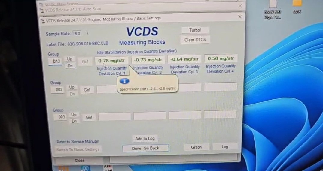

Well... what an anti-climax.
The injector 1 was at fault, nothing more serious.  Switching it with 2 and cylinder 2 had the issue and so on.
But when putting them back in the right place, everything is fine.
The loss of power, the juddering... stopped.
The range of the injectors is something like 1.0, -0.5, -0.6, 0.8 or something.
They think the previous garage, he of "drive it better" fame, may just have bungled the installation of the new injector.
Now 'pulling like a train' I hear.  They want to test it from cold before releasing it.  If it does intermittently misfire in future though he said it'll be injector 1 not anything more serious.
For anyone interested!
