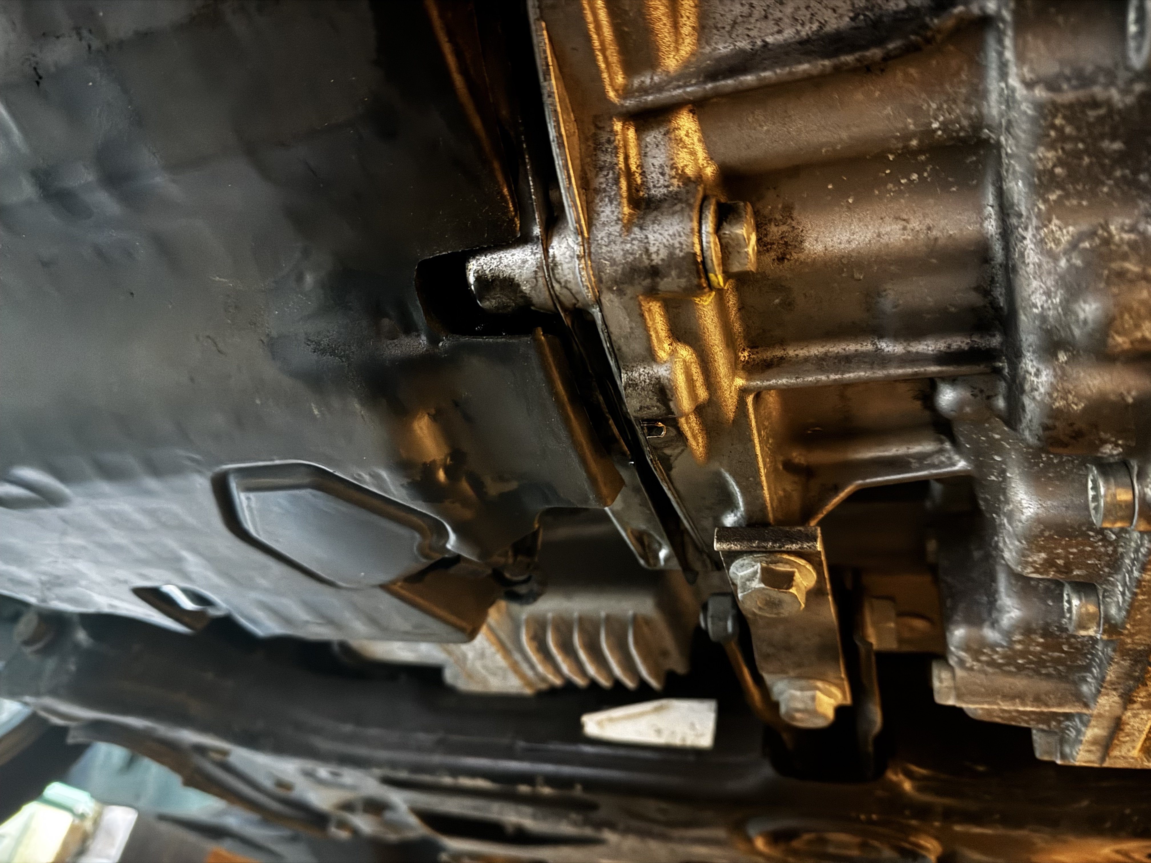

On my superb 2021 Dsg, i see today that i have an oil leake.
I think its not leaking dsg oil, but engine.
Is this critical?
Its not manny oil but it is somethink… on picture i already wipe oil down.
Looks like it could be the old oil leaking past the flywheel bolts problem. Not seen it on the newer stuff before though.
Must i fix this?  Its not muc leaking…
Damaged gasket..?
Remove flywheel bolts and add thread lock.

Its new type engine with 147kw. Dsg 7
I check today again.

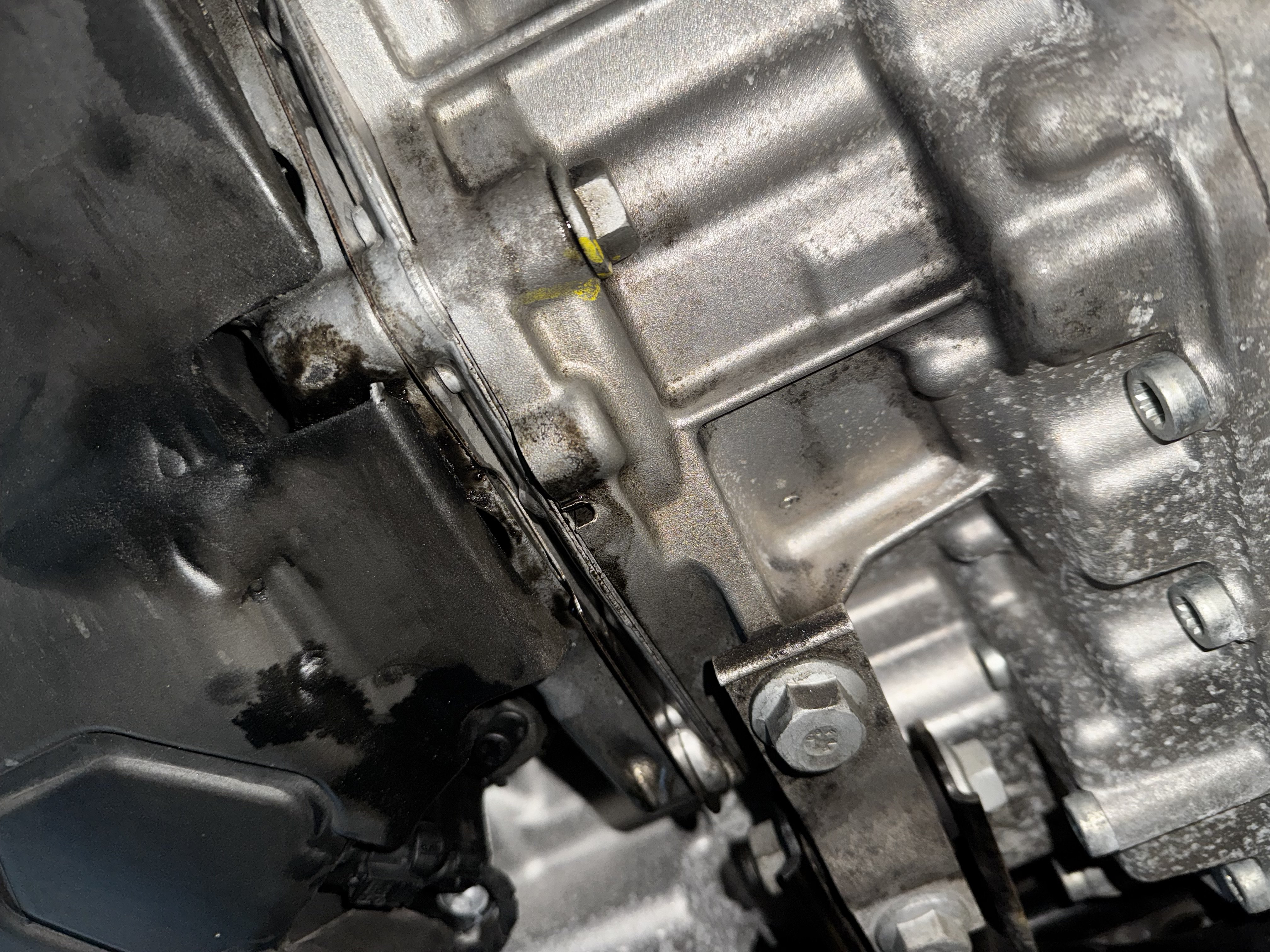

There was little oil to see again…not huge leak. I tight this big bolt and another one at the back.. it was not tighten good. But that will not solve the problem i guess becous there is no oil behind..?
It comes definetly out of there where is flywheel.
So if there is no major leake, should i woried?  Must be fixed?
Probably not essential to get the oil seal changed immediately but it not likely to repair itself. I left mine for 6 months after being told it had a slight leak. I finally got it changed when the clutch pack was replaced as most of the cost of repair will be labour charge.

If it is not leaking from somewhere higher up (above gearbox) and running down to there, then it seems likely that you would have to remove the gearbox to find the source of the oil.
May be better to just keep cleaning it and making sure you are not losing much oil by checking the level regularly.
If it is leaking enough to make a mess on your driveway, then it would be kind to other road users if you fix it before it gets much worse.

Yesterday i cleaned all oil i can see on engine.
Car has not been driving 12 hours, and there was no oil to see at the moorning.
So there is no oil leake when car is not driving.
I put paper on the security plactic (plastic under the engine) And drive around 100 km… Then i look angain and there was probably three droops from oil at the paper.
Should i leave it or should take to delaer to fix it?
Is huge oil leake this?
Thanks for helping !!
  • Sponsor
I would leave that. Maybe keep some paper or cardboard under there (fixed to undertray somehow) to absorb the drips, so they don't go onto the road, or your driveway/garage.
It could be worth checking the positive crankcase ventilation (PCV) system is working correctly.  This helps eliminate, or at least reduce any gas pressure in the crankcase/sump/head which makes leaks less probable.
I don't know exactly how this system operates on your engine, so I can't suggest a method for checking it, but sometimes just loosening the oil filler cap while engine is idling, and observing whether it tends to be blown upward or sucked back down can give a useful indication.

There is definetly not so much leake that will go to the road and to garage :)
That leake must not be new.  I have car not so long, but i  have do 3000 km. And there is no oil on floor in my garage.
I think in this time 3000 km if leake willbe huge i will have some oil on floor at the garage. I guess.
2.0 Tdi 147kw  DTU
Edited by Seba800
Three drops of oil is nothing, but if you had cleaned well the engine you will find a way to get to see where it really comes from.

I haven't got the tpi to hand, as I only downloaded the data for my vehicle which is 1.5, but if you log into erwin you can easily find it. It mainly effected the smaller and older engines. As the others suggest you would have to remove the gearbox and make and inspection.
