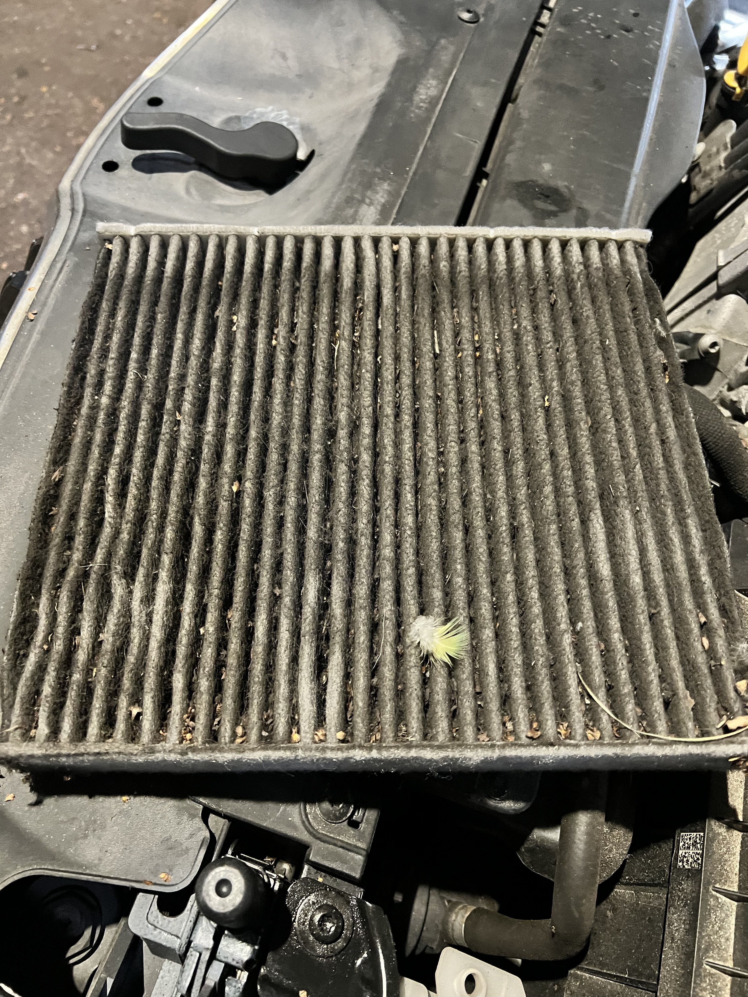

Perfect service history, my ass!
After purchasing a high mileage Skoda superb 1.6  mk3 estate 2018 with a FULL MAIN DEALER SERVICE history I have been questioning either the seller or Skoda main dealer have been…… well let’s just say questionable.
I like to get my hands dirty and have been doing some routine servicing and preventative repairs, and I keep on finding cheap pattern parts installed which have been invoiced by Skoda themselves! I have the invoices going back 6 years and seems legit.
Do Skoda dealers use non genuine parts? Or has the past owner not been honest?
See attached pic of the pollen filter that has been changed 7 times by the same dealer and last changed in May 2024.
Blimey...   That looks like it's never been touched!!
Certainly would not expect the pollen filter to look like that after 9 months unless it's been on the Paris - Dakar.
Jeez - at least you get a cheap improvement to performance. Pretty sure genuine dealers should use what they're told by Skoda to maintain warranty but perhaps after that there's some licence to manoeuvre...

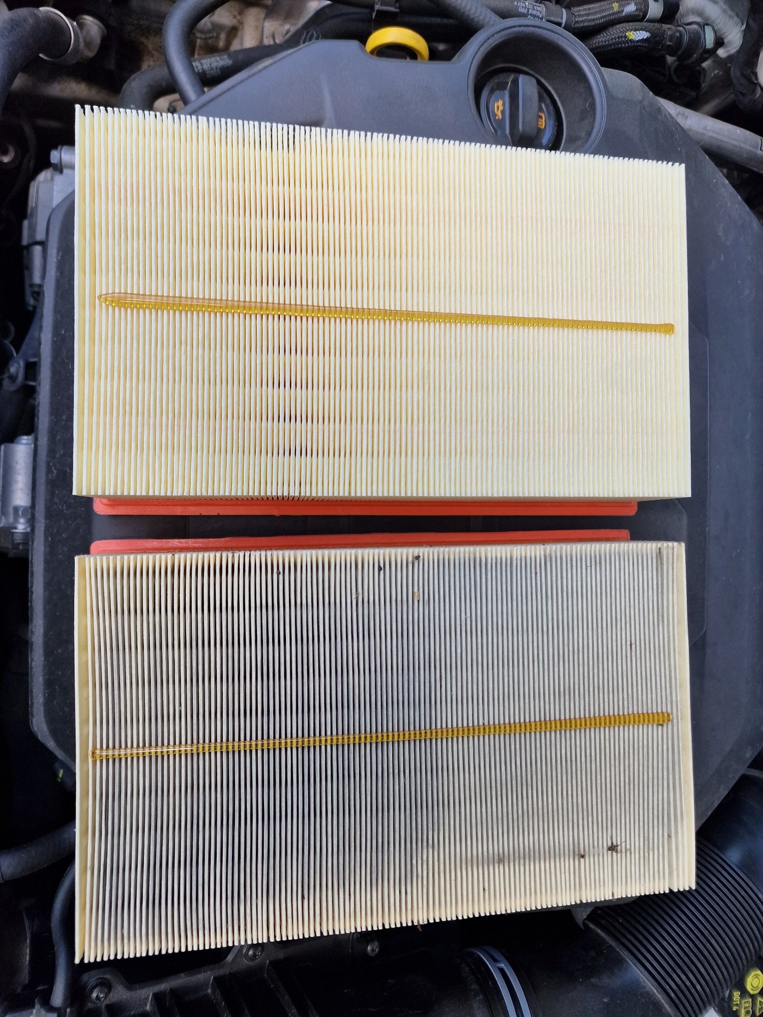

What did the engine air filter look like?
10 kKm 10 months, most of official intervals must be split by half
Wow, that pollen filter looked to be an oroginal one from the car was new...
As @Ootohere suggests, a FMDSH doesn't mean it has received the correct maintenance. In this case I think some stuff has been ticked off and not actually done. Not necessarily a lemon but definitely a dealer to avoid.

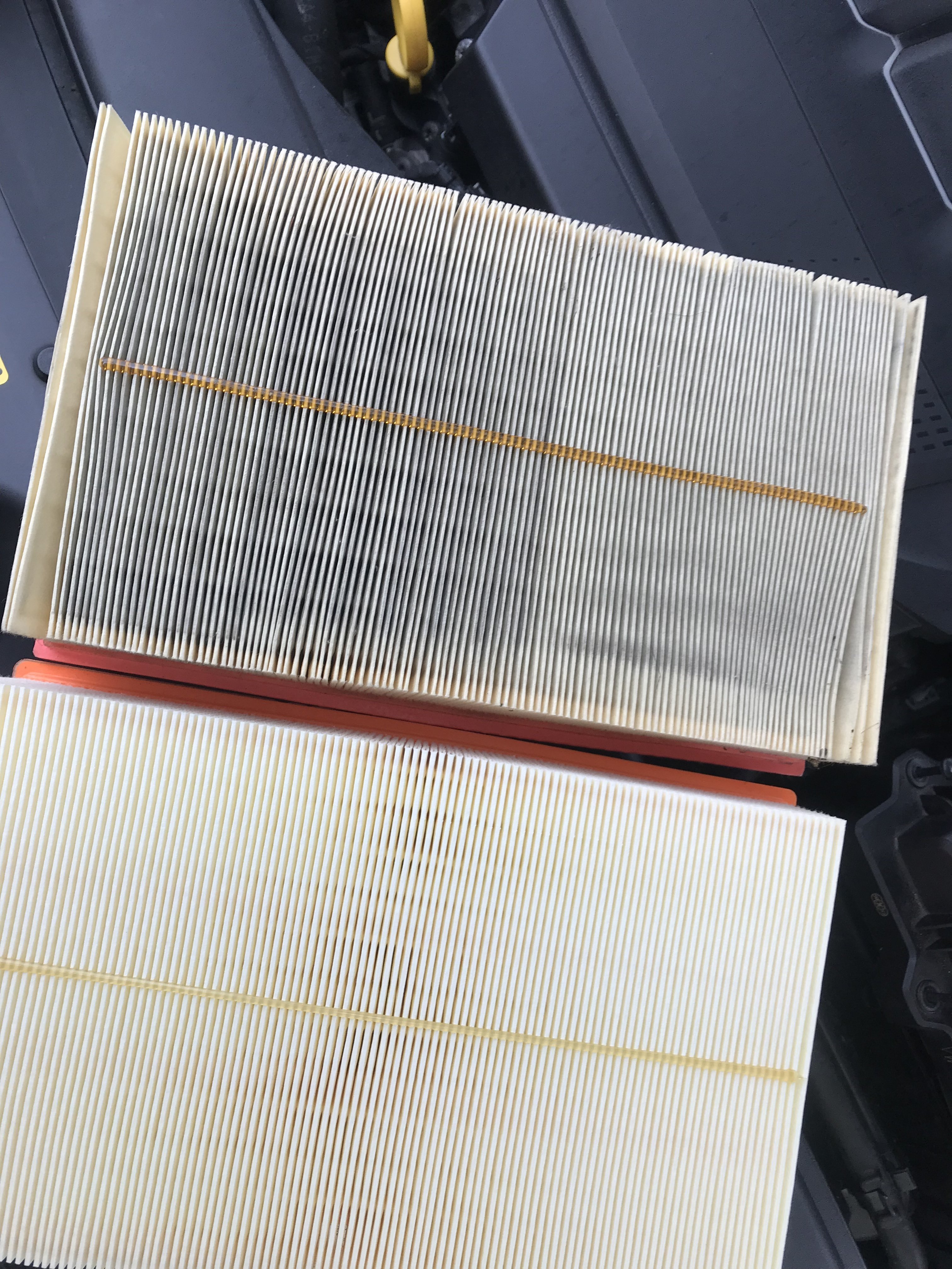

Changed my air and fuel filters today since coming to the end of 5 year extended warranty (oil and filter to do on a warmer day)
my old air filter looks just like yours in the pic above: this after 37k miles albeit mostly rural long runs)
