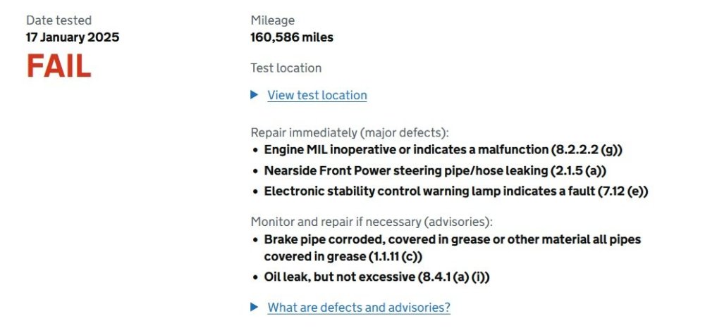

I had put through my 2006, VRS for it's MOT last month and it failed on the below.
It shouldn't have failed on the EML being on as it's not testable on a 2006 diesel, last I checked.
Oil leak was from when the tandem up was leaking for a while. It was replaced and cleaned up as best as i could prior to the MOT but the oil is still wet in areas.
Brake pipes aren't corroded at all. But they're covered in grease so the don't corrode. Shame i didn't do it earlier on the power steering pipes.
The stability management light issue is when the engine has been idling for 10 minutes, it comes on. It happened after alternator was replaced.
I fixed the same issue on my Ibiza almost 10 years back and if i remember right, it was the load balance cable for the alternator loom.
This time i'm struggling to find the break in the cable. Any tips? Or is it just a case of peel it all back and visually?

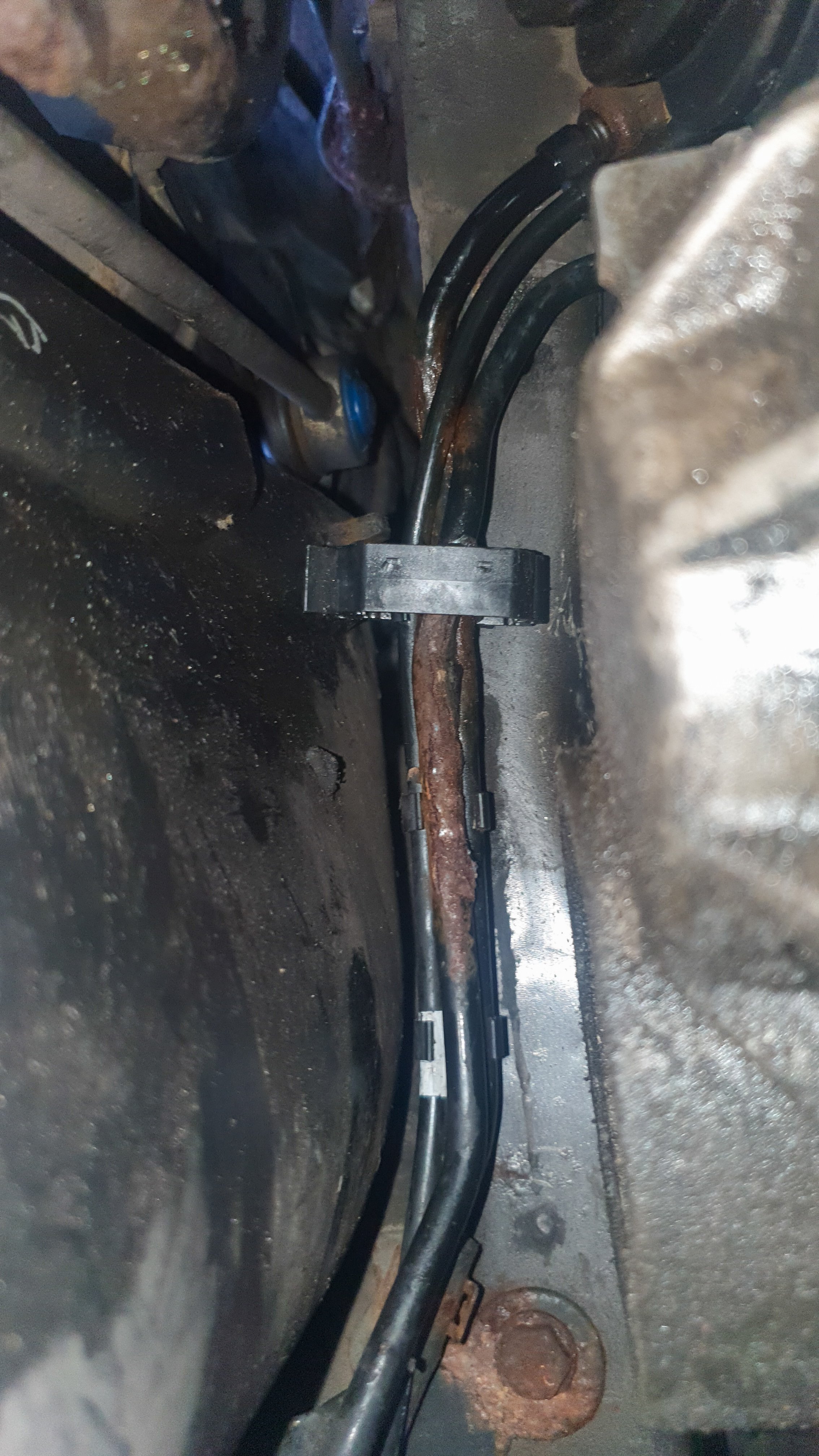

It looks like one of the metal sections on the power steering pipe on the top of the picture is the one leaking fluid (i'd cleaned it all up here so i could access it better)
The bottom pipe is on it's way out as well by the looks of it so i'd like to replace both.
Is this a hard job to do? I'm okay with all things suspension, brakes and some light stuff around engines but wondering what i need to strip for access to make it easy on the driveway.
I had a look on here, using search and it suggested the power steering pipes might not be available any more.
is this true and if so, what have people been doing, to resolve it?

You're right about the MIL, shouldn't have been relevant because:
"You need to inspect MIL fitted to diesel vehicles including hybrids with 4 or more wheels and first used on or after 1 July 2008."
The 10 minute warning light is almost certainly either the replacement alternator wasn't compatible, the connector at the alt was not refitted, or was broken, or the DFM wire (the one that isn't blue) between alternator and ECU.
If you let me know build date of car, or reg or VIN I can look up exact circuit info.
Wheel arch liner removal will obviously be a good start in accessing the PAS pipes. Never got down and dirty with them myself though.  Repair of what you have may be the best strategy, followed by trying to find some better condition ones from scrappies.

I think febi do power steering hoses and pipes. Not sure about VRS but folks got them a few years back for there 1.9tdi. Part number I came up with is FEBI 186139

It looks like it's 3 pipes when checking underneath but the pipes so not sure if 3 different pipes or if all are the same. I'll need to wait to good weather to get them off to check design / shape and match them up. Will probably replace all 3 as they all look poorly.
Had a problem years ago with power steering pipes that had coroded and were impossible to get for  toyota lucida. I finally got a local hydraulic hose company to make me flexi hoses instead of the steel/flexi that was on the car. Tried measuring old pipe but eventually I got them to fit one end and then give me the slightly overlength hose. Ran it through the car and marked where I wanted the other end to finish. Luckily I had fairly straight runs and enough space to put a slow bend in hose for corners. Has been fine for years and still have car. Also repaired the 8mm steel oil cooler pipes on same car  using 8mm copper microbore central heating pipe and compression connectors. Still there and still ok It was lower pressure than steering though. I cant think of a reason to have steel pipe between flexis apart from the cost.

Looks like subframe has to be dropped to replace these pipes. Had the Fabia 9 years and have spent about £1500 on it in the last year, but this is the nail in the coffin for me. I'm so burnt out from work every day I just don't have the mental capacity to deal with any more big jobs so just need to get some affairs in order paperwork wise and will get it listed for spares or repairs.
Shame as has one of the rarer forge FMIC specifically for the VRS, Seat Surgeon Seats, original purchase receipt from Skoda etc but it's too big a job to do on my driveway for me and i can't afford to put more money into it, to have it recovered to a garage i'd trust to do the work for me.
Being replaced by a Renault Modus of all things
I don't think it does, the pipes are just clipped to the subframe, you have to drop the subframe to remove the steering rack.
