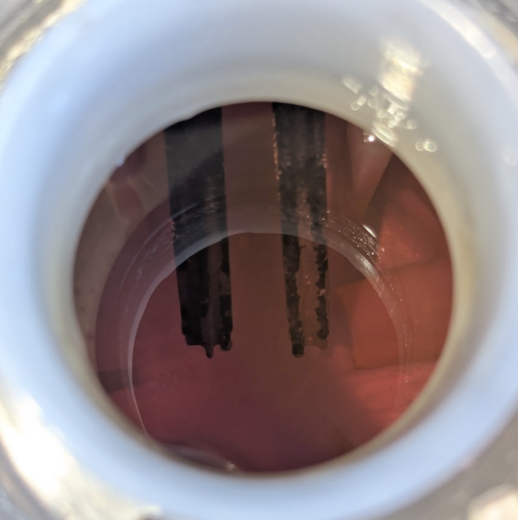

I took a couple of photos. I can;t work out whether the prong on the right is damaged or has a large build-up of stuff....
And not sure about the cable regards coolant migration, as the wires are exposed I assume you mean inside the sheaths?
The RH probe looks contaminated or damaged - try gently running a screwdriver down the flutes to see which. That is very likely to be the cause of your intermittent issue.
If cleaning the probes does not work, it is a very easy DIY job to replace the EV tank.
The probe connector looks OK to me.
Edited by Warrior193
added information
Yeah I think there's a lot of contamination on the right. Try cleaning it. But there is some on the left as well. If it comes back. You'll have to go looking for the source contamination.
The tanks leak in the recess where the connector plugs in. Best to remove connector when hot to check. Spray some soapy water, check for bubbling.

Might be a daft question, but if I'm scraping lots of stuff off the prongs, won't it possibly then cause blockages elsewhere?

Yes, exactly. To the op I would just de mount the tank, drain it to a container clean prongs and replace original coolant. I have a feeling you've got oil contamination so the problems going to recur.
The contamination looked more like scaling to me, I'd have expected to see noticeable discolouration of the coolant if oil was present.
If, on inspection, it is found to be caused by scale, I would strongly recommend a full coolant change.
I agree with scaling. Perhaps been topped up with concentrate and tap water instead of distilled. Had same problem on my MK2 so bought another tank. Wasn't expensive but when it arrived the problem stopped so never got round to fitting it. Might be worth a coolant flush if the scaling is bad.

I did a run to Gloucester again this morning and I had no warnings appear... The screwdriver scraping might have done the job.
I would still get a new bottle. The fact that there is oxidsation in the coolant tank also probably means you need a coolant flush.
