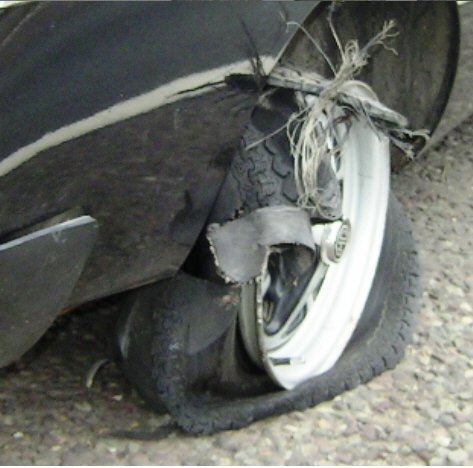

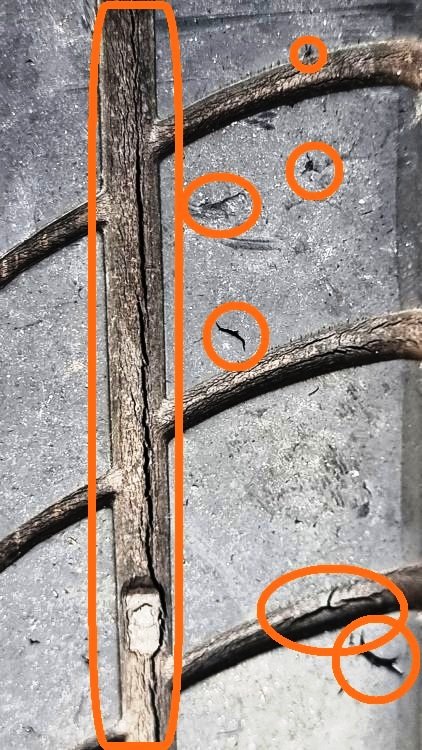

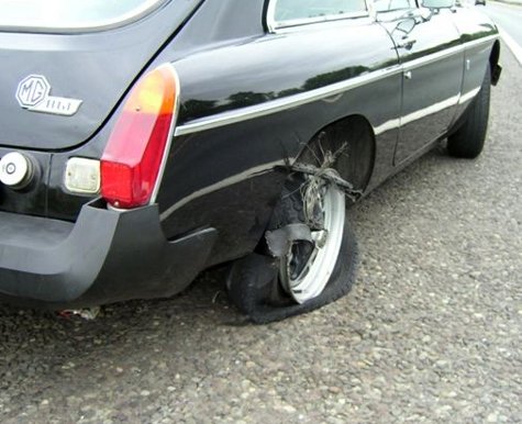

It can depend on the tyres initial storage before fitting, then use and storage when on car as to how they age but in that photo that tyre at that point doesn't look good generally to me - but I'm not an expert in anything, just have decades of experience of owning and driving cars daily on our roads, some 20-50 years old, and of other "classic" (over-valued, over-priced old) cars and their owners, some who should have known better and some new to "classics".
Below an example of old (27 years at the time) tyres that looked very, very good or excellent (I forget) and had lots of tread depth on them, the owner (MR R G Everitt) long ago put photos up as advice and warning for other "classic" car owners and allowed me to do so too.
Of course your dad's tyres might be fine (????? ! ?????) and they might go on so for a good while yet - but- if you're cleaning his car for him you might value him over any inheritance and prefer to see new fresh tyres fitted. All the people that responded after changing to new tyres agreed that they wished they had done so sooner.

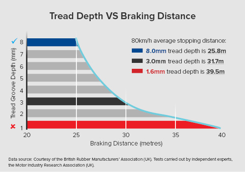

Yes, although I was meaning more factors such as the difference in wet braking distance with fresh vs worn tyres.
At 80kmph (50mph) you should be at least 53 metres from the car in front.

If you mean your dad's 2011 Vredesteins are with about 2.6mm tread then that's fine, as far as it goes, for tread depth, and no cracks is great but how hard is the 13+ year-old "rubber" that it might be (greatly) reduced performance for handling and braking. Your dad's car might very easily be provoked into being tailhappy no matter how little power it has and at low speeds. As the Vredesteins have lasted 13+ years without cracking that might well be another brand to consider.
Only larger, deeper cracks and holes on just the section of tyre shown in your photo. -

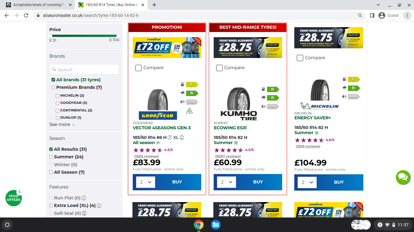

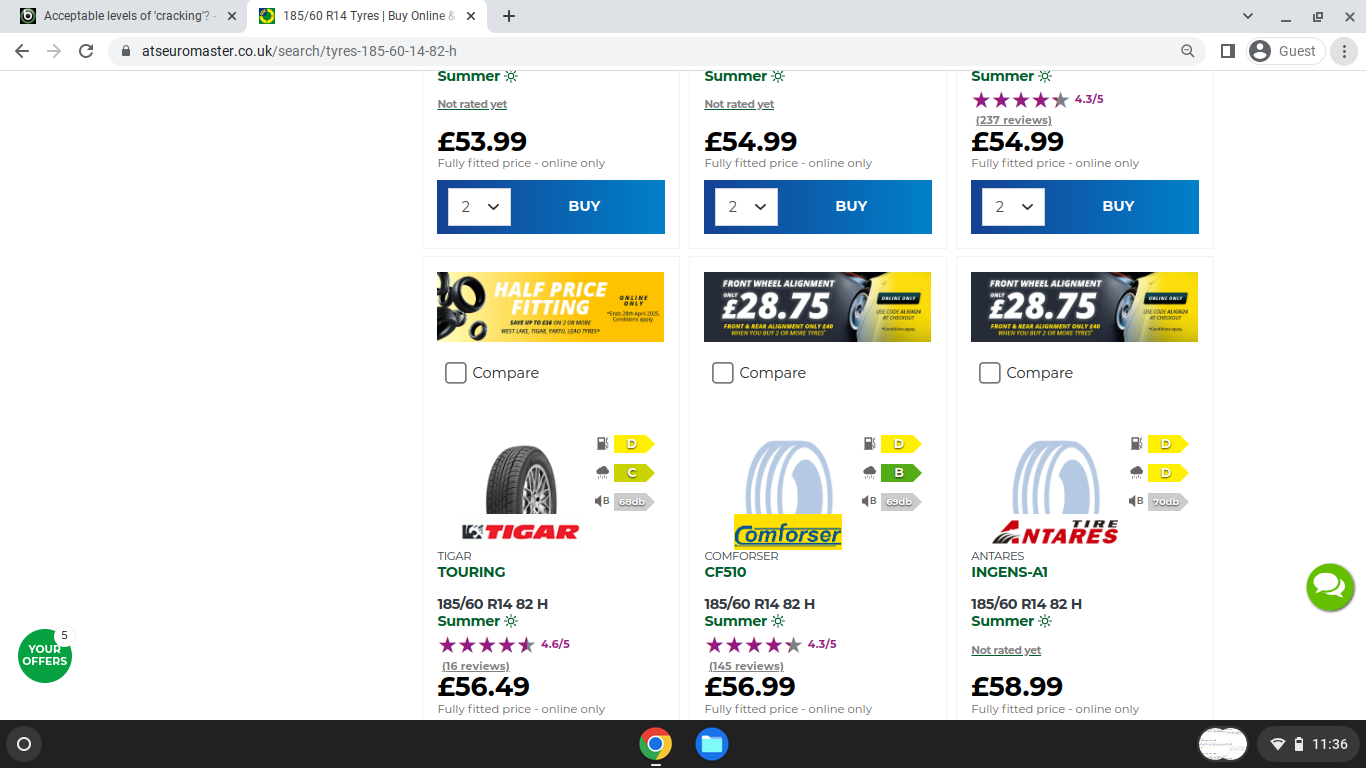

Has anyone bought part worn? I'm seeing some top brands with almost no wear (around 3 years old) for around 1/3 new cost.
Part worn is a bit of a minefield, so depends on the place you get them and their source.
Some could be almost brand new from insurance write offs etc. Some are from people who don't believe in puncture repairs and just buy new whatever. Then there are imports from countries with a higher minimum tread than the UK.
Used to buy them when skint but don't now.
I have used TIGAR tyres on various vehicles, mostly winter or all seasons, but had summers on a Volvo.
Tigar just one of the brands / factories Michelin own who also own ATS Euromaster. (&BlackCircles)
At the desk i often get a price for fitted lower than the Website / Online ordering shows,
or an offer of tyres they have in stock at the branch or for next day delivery.
