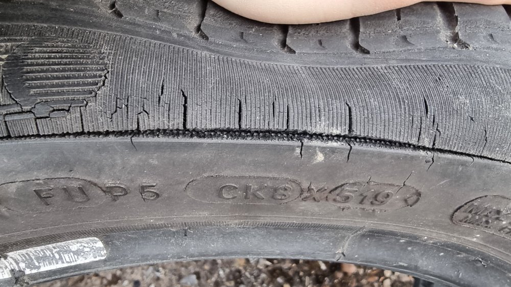

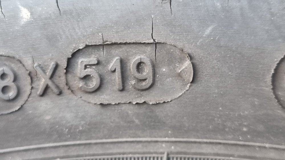

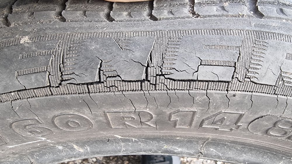

  • Tyres are 17 years old, is that right ? I think they are long overdue a change. Most guidelines reckon 10 year old tyres mean it’s time they were changed, no matter mileage.
