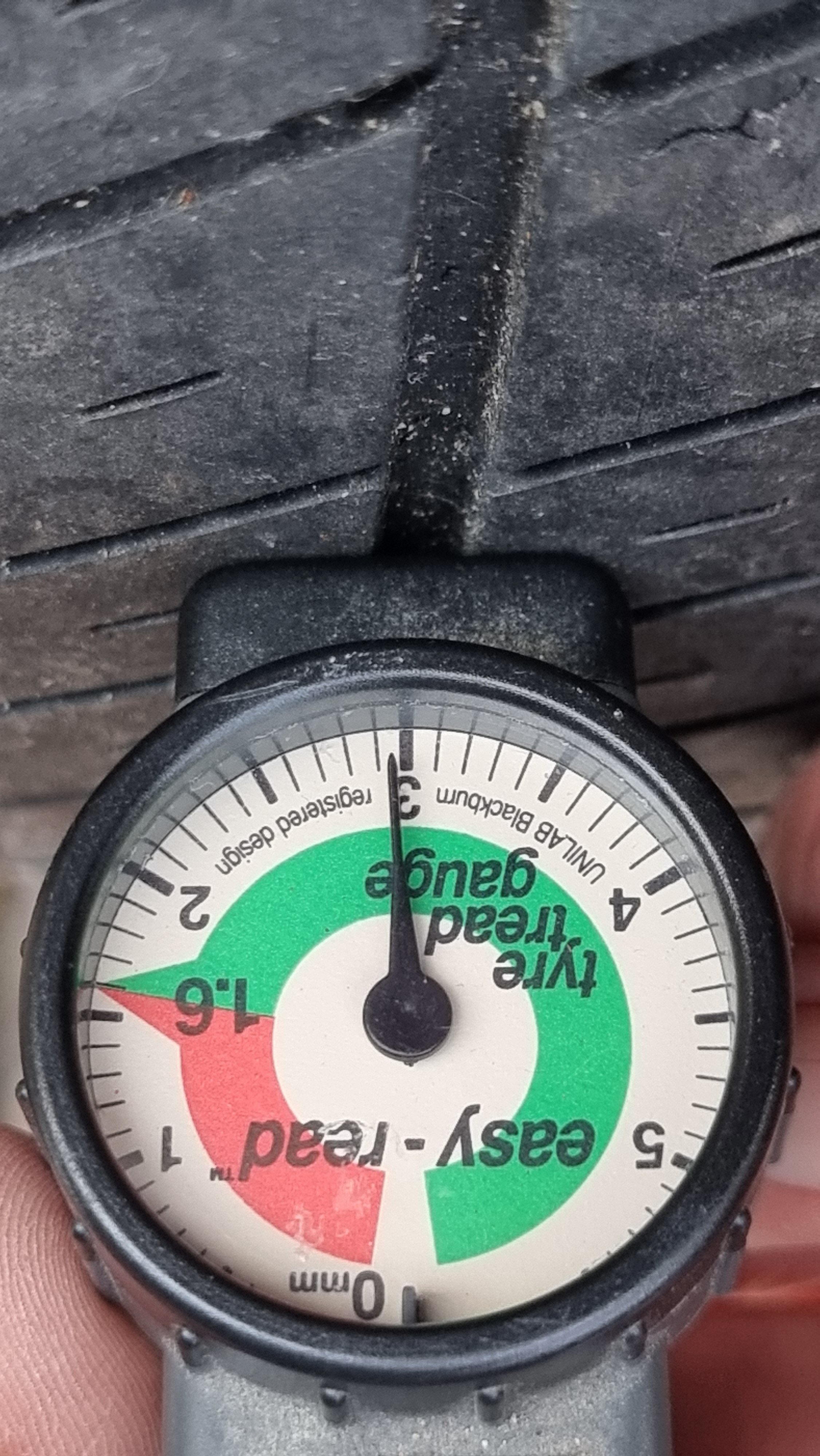

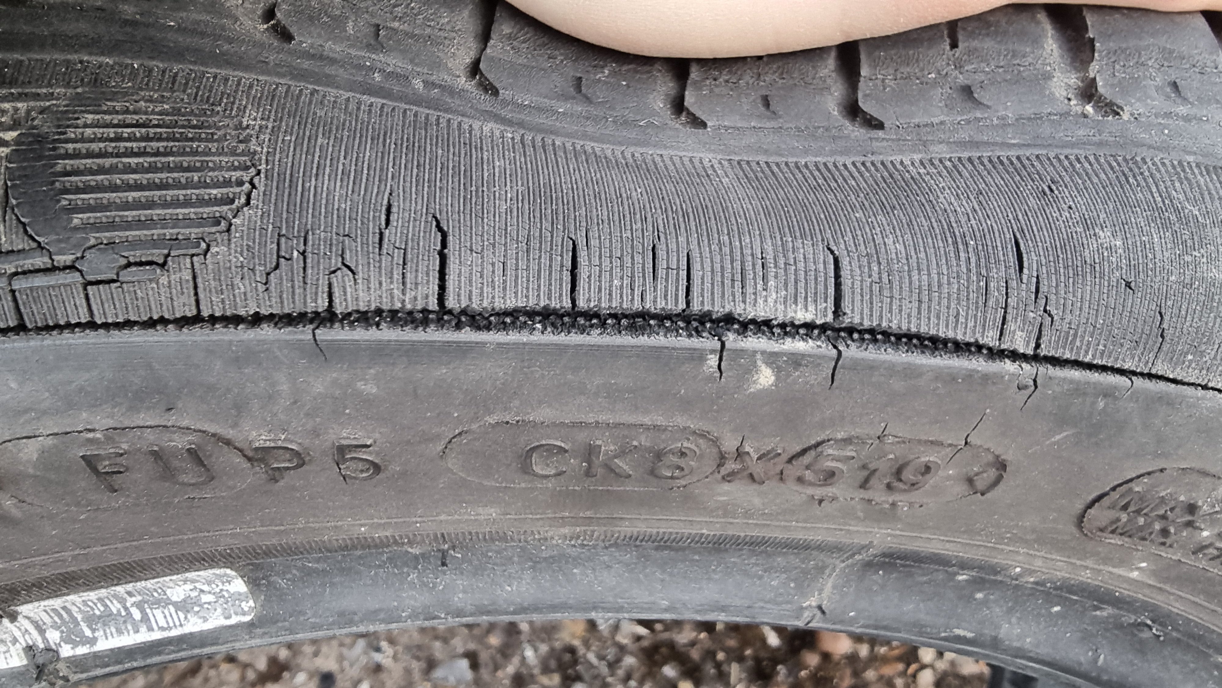

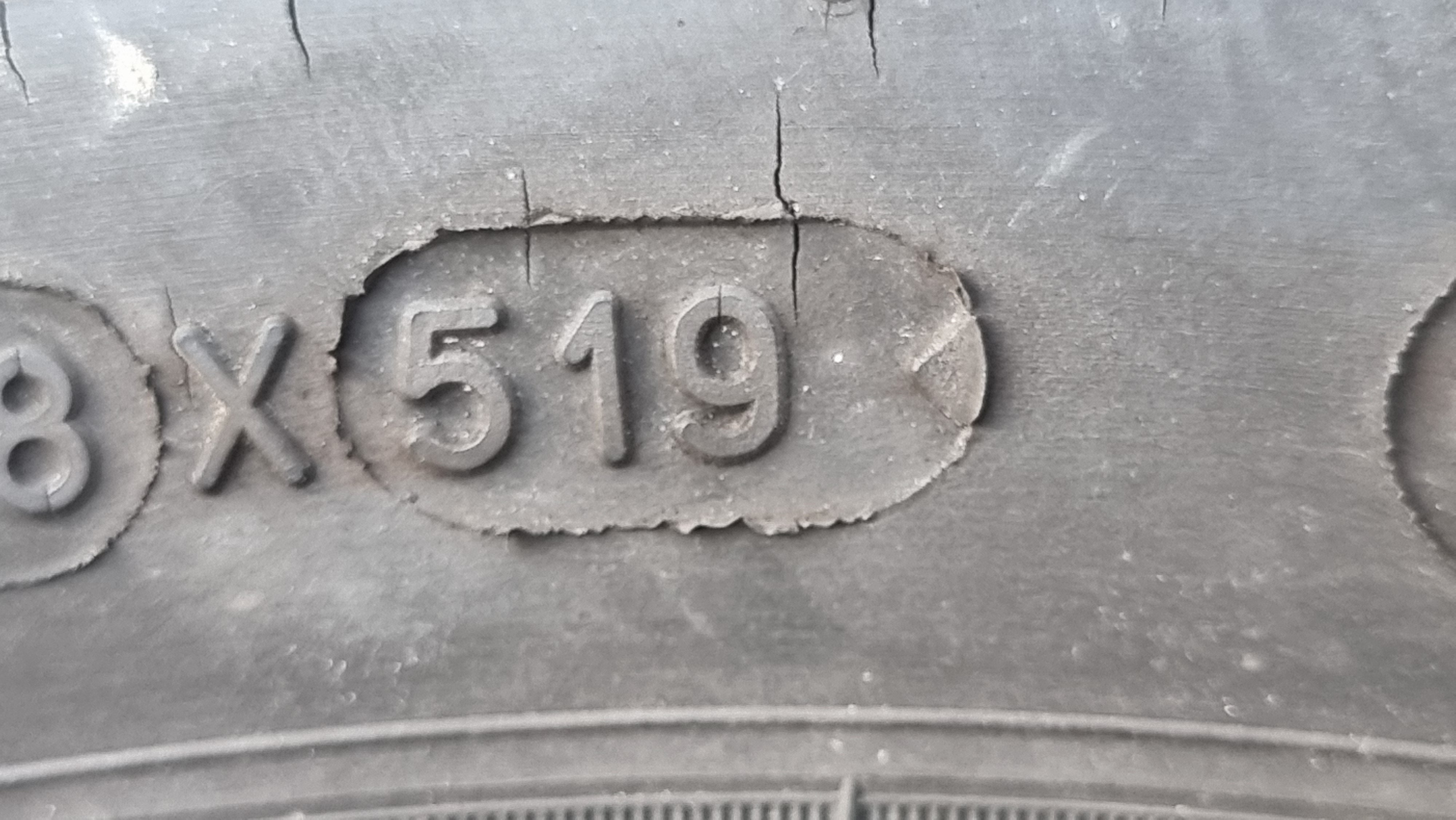

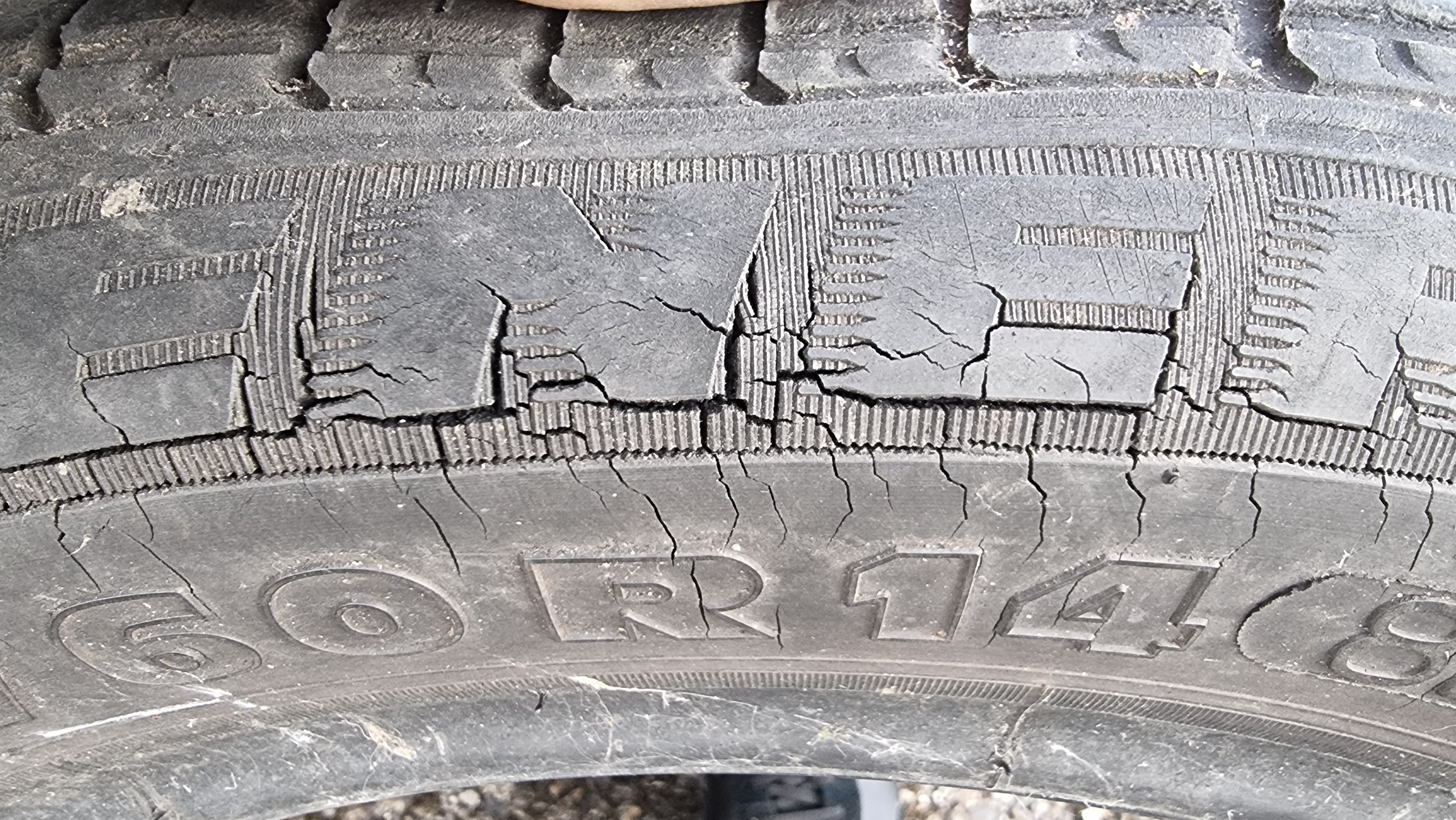

Well as a testament to not buying part worn these two "hardly used" Michelin tyres with "6mm of tread and 3 years old" were in fact 25 years old, had 3mm of tread and dangerous cracking.
So new is best 👍

  • Tyres are 17 years old, is that right ? I think they are long overdue a change. Most guidelines reckon 10 year old tyres mean it’s time they were changed, no matter mileage.

We didn't buy the tyres. They just sounded great being under 3 years, loads of tread and top make sold locally so we took a look.
I'm sure the tyre fitter would have flagged them up had I not picked up on how far off the truth the description was.
A pair of Uniroyals are £130 so that's what we will go with.
Thanks again for the comments it's been really useful

If it's not a mistake you have got to wonder what is up with someone that thought those tyres were suitable for sale, even for off-toad mud-plugging sports use.
