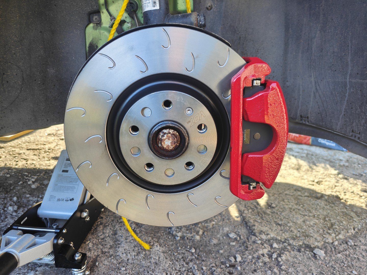

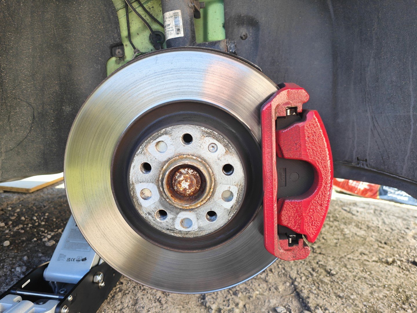

Now for my current issue, when driving I can hear a slight grinding sound when driving coming from the troublesome right rear. Is it new calliper time or does anyone have any suggestions as to what I might have done wrong?
Pics are of the fronts
is the disc shield rubbing on the new disc? It might need some slight bending so it isnt rubbing.

I don't believe so there was enough clearance when I installed them, but I'll double check. The noise is more subtle, it's hard to explain but kind of like sandpaper on a surface.

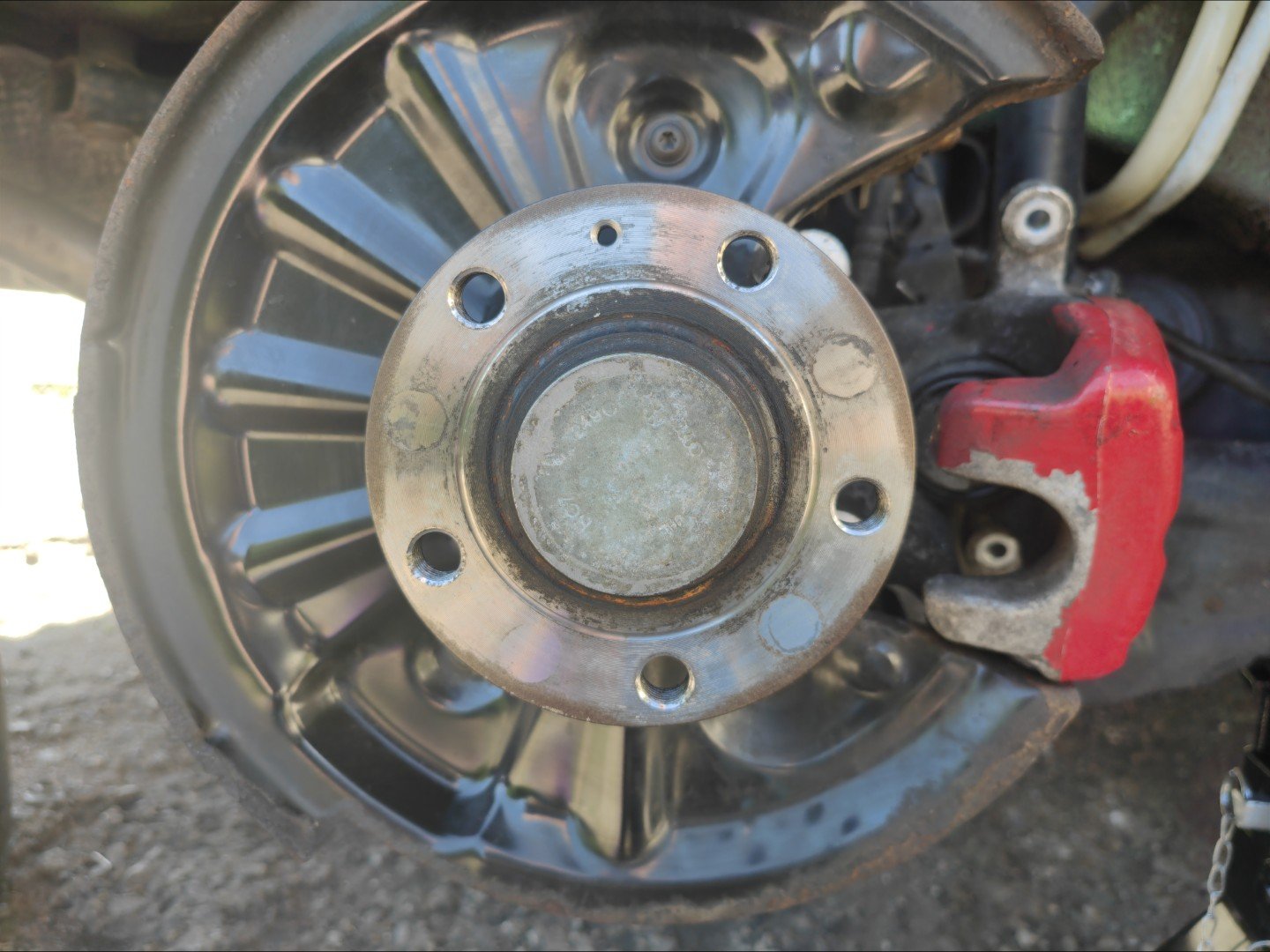

So I've been on a bit of a long winded journey with this and yet still I have more or less the same issue...

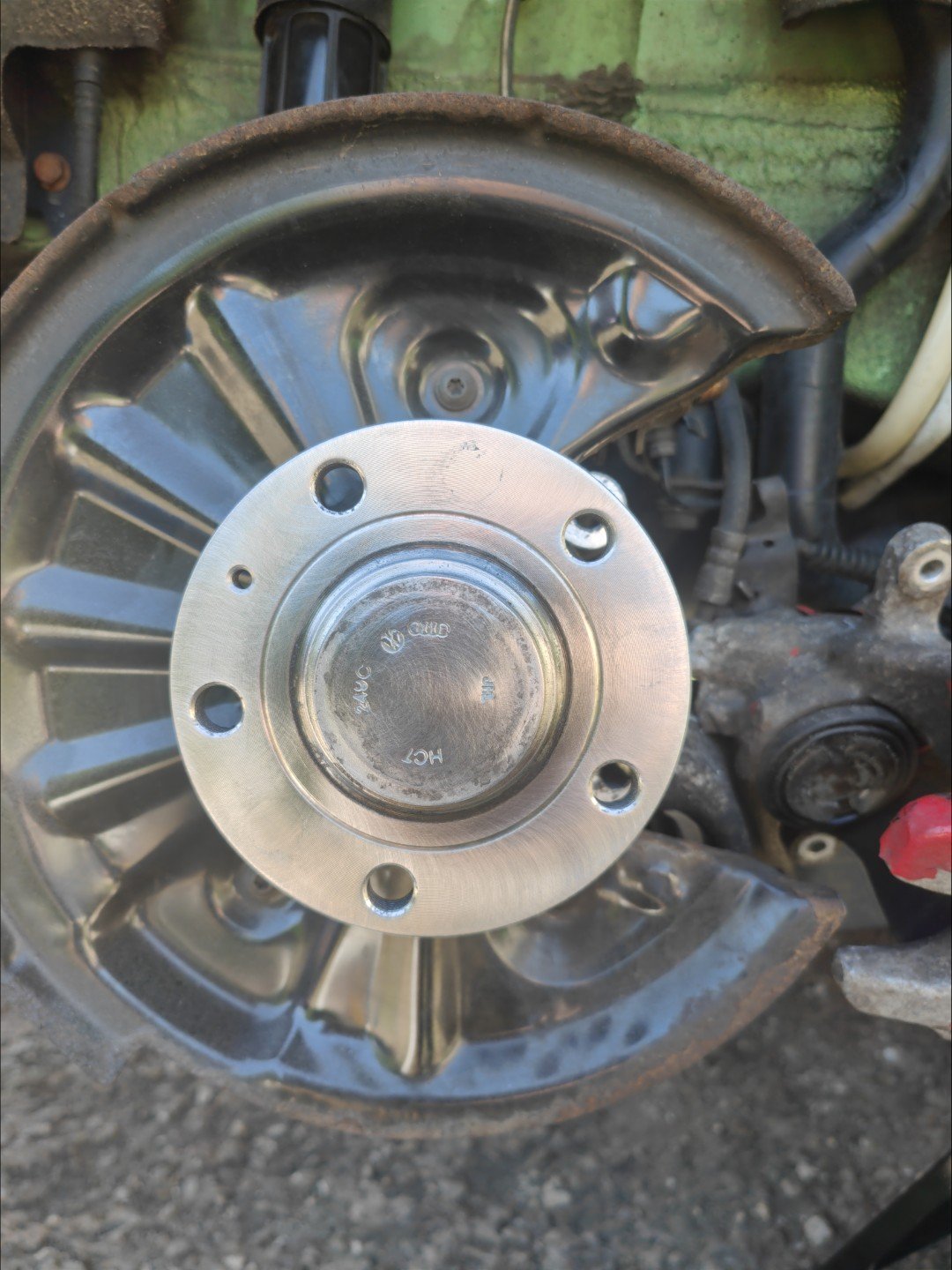

Since last time I commented on here I have had the backs off again, bought a proper drill cleaner and got the hubs up like new. Fitted the brake again still catching and making noise! (So the issue is not the hubs)

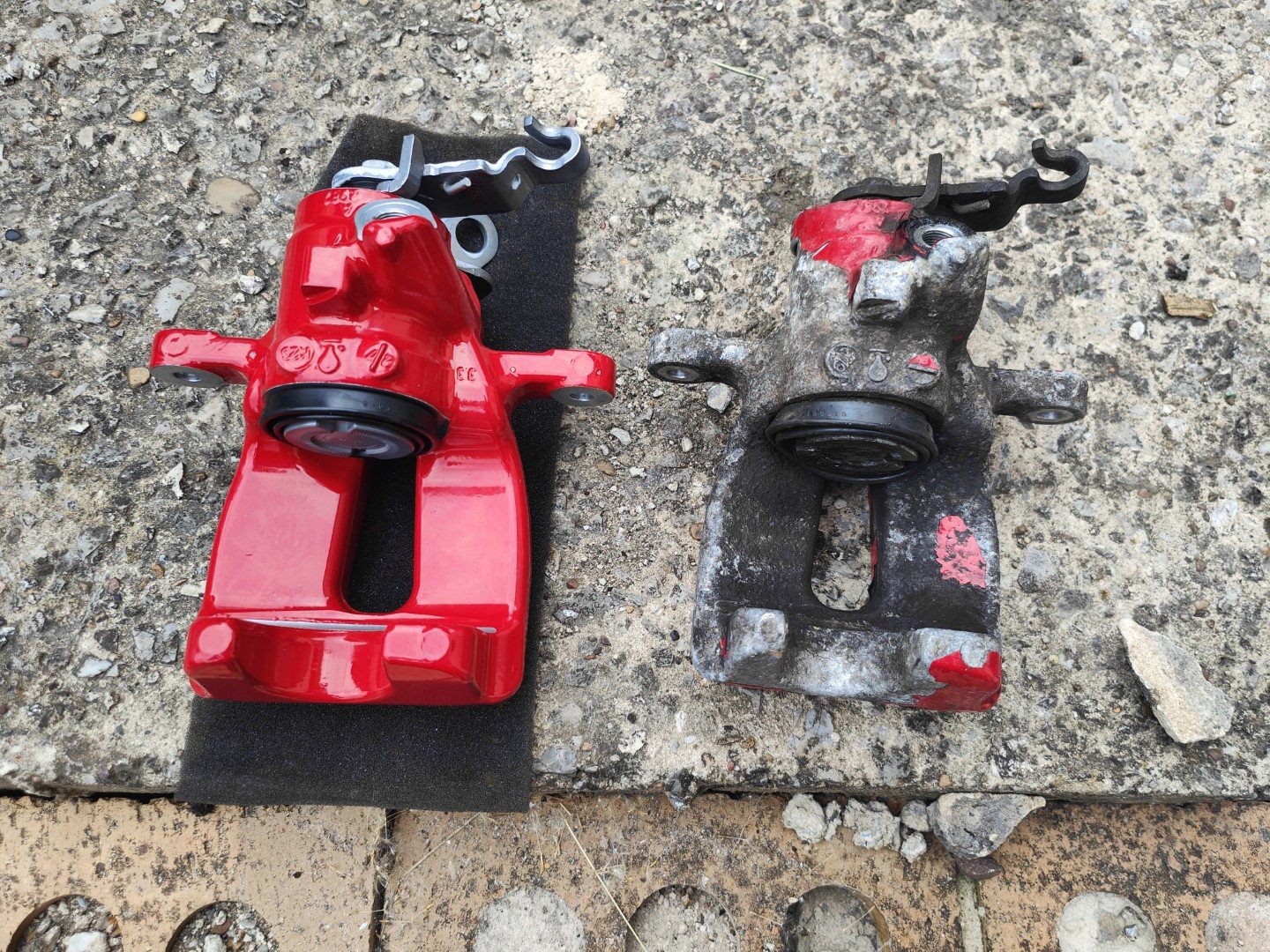

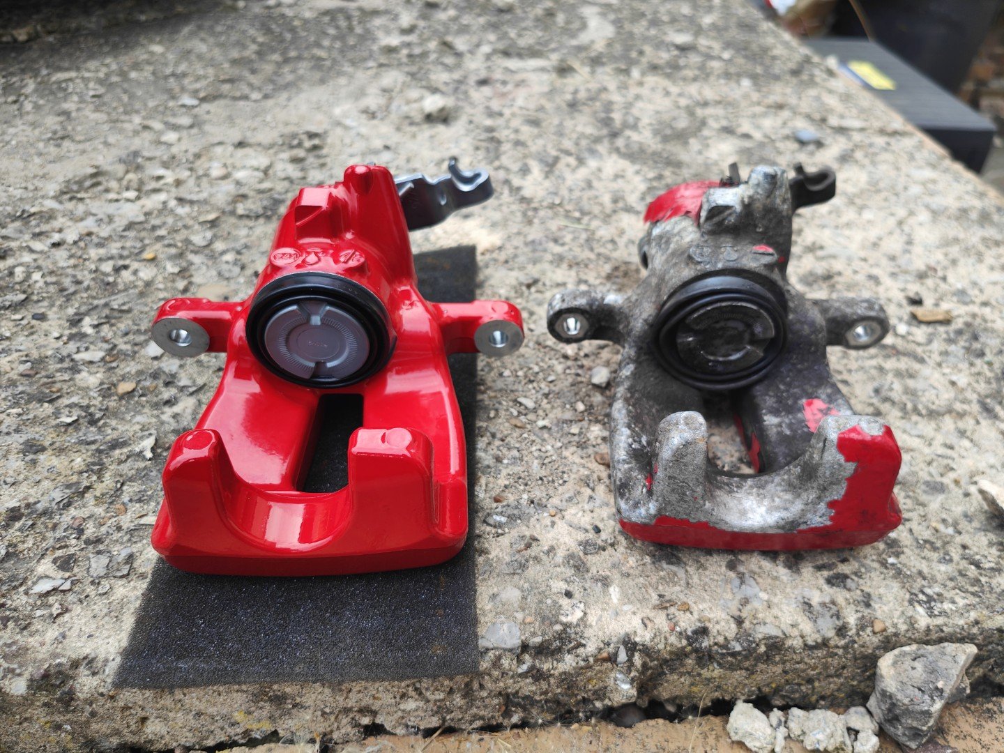

I took this as a push to just buy new callipers, which I did. Skoda dealership (Penistone Road Sheffield) wanted £390 for each rear calliper, even the guy on the parts desk was shocked. Shout out to him, I didn't catch his name but he was incredibly helpful and looked up the parts on online for me to find a better price, £250 each sounded a lot better. I bought all new bolts for the calliper carriers and callipers themselves while I was there.
So 500 odd quid later and a couple of weeks wait the parts finally arrived and I set to work replacing both rears, which went pretty smoothly for once. After installing I bled the system with a pressure bleeder and all seemed well, but the pedal was a little spongy compared to before. Decided to bleed again as it was 100%, I'm glad I did as second time round I got loads more air out of the system and the pedal feel is so much better.
So has all this blood, sweat, tears and a fair amount of cash solved my problem? No!
Don't get me wrong I'm glad I have replaced them as they were in bad shape and they look so much better visually, However, they are still catching and making noise and have even started squeaking on random occasions when driving at low speeds but not applying the brakes.
I am at a loss, I have literally tried everything I can think of, as well as everyone's suggestions. The car is due its MOT and service soon so while its at the garage I will get them to look at the brakes and see if there's anything they can do.
After hub clean, brakes not installed.
After calliper replacement.
Okay. Firstly, nice job on the hubs and replacement calipers. No job is wasted - it's just one more thing to rule out.
That being said, I think we have found your problem. In the first video, you get the issue with the caliper off. That sounds to me like it's the wheel bearing. Normally you get a grinding noise, but the squealing can be an early sign of it going.
If it was on the front then that's a different story, but IMO I would take a look at the bearing.

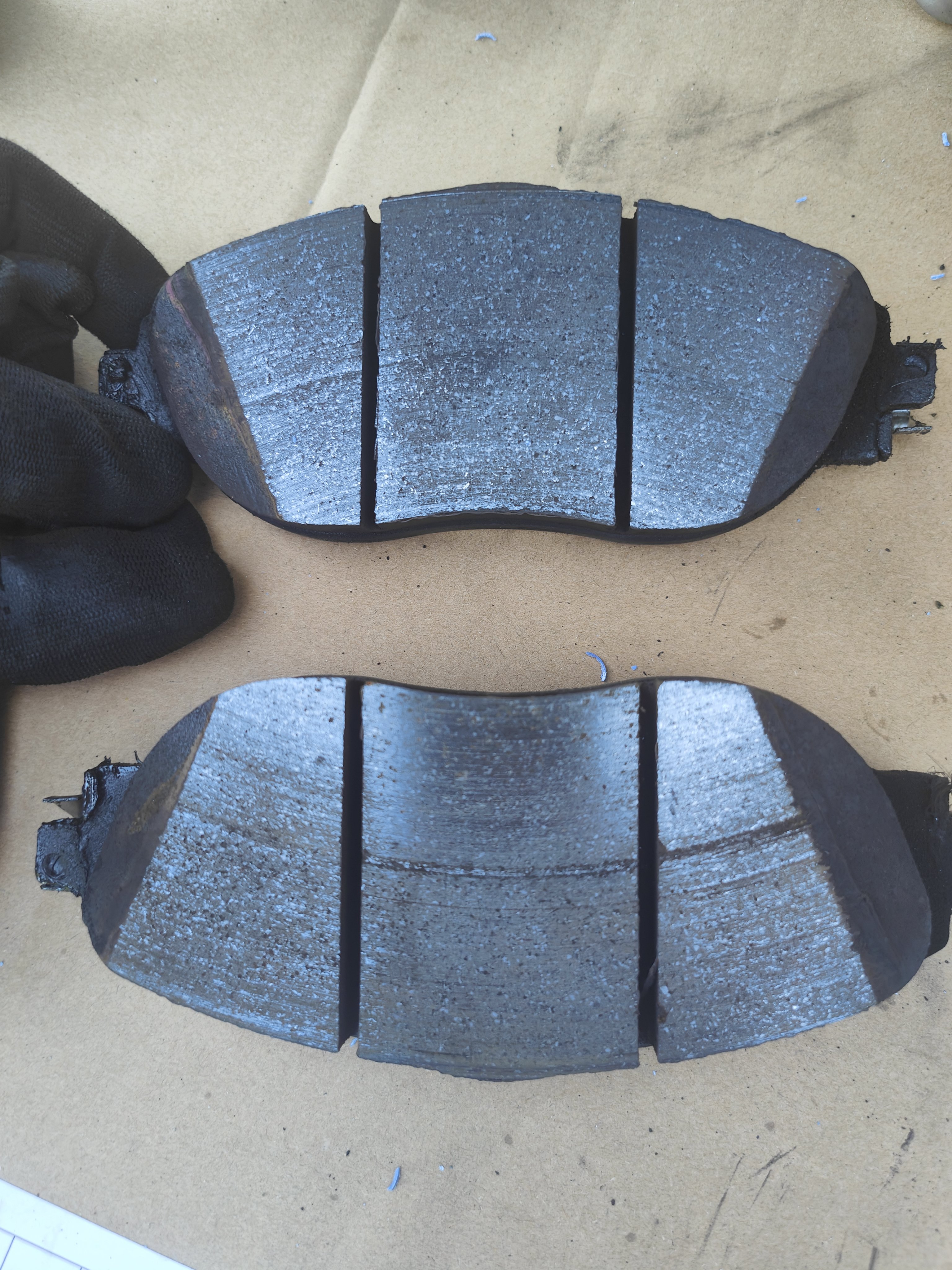

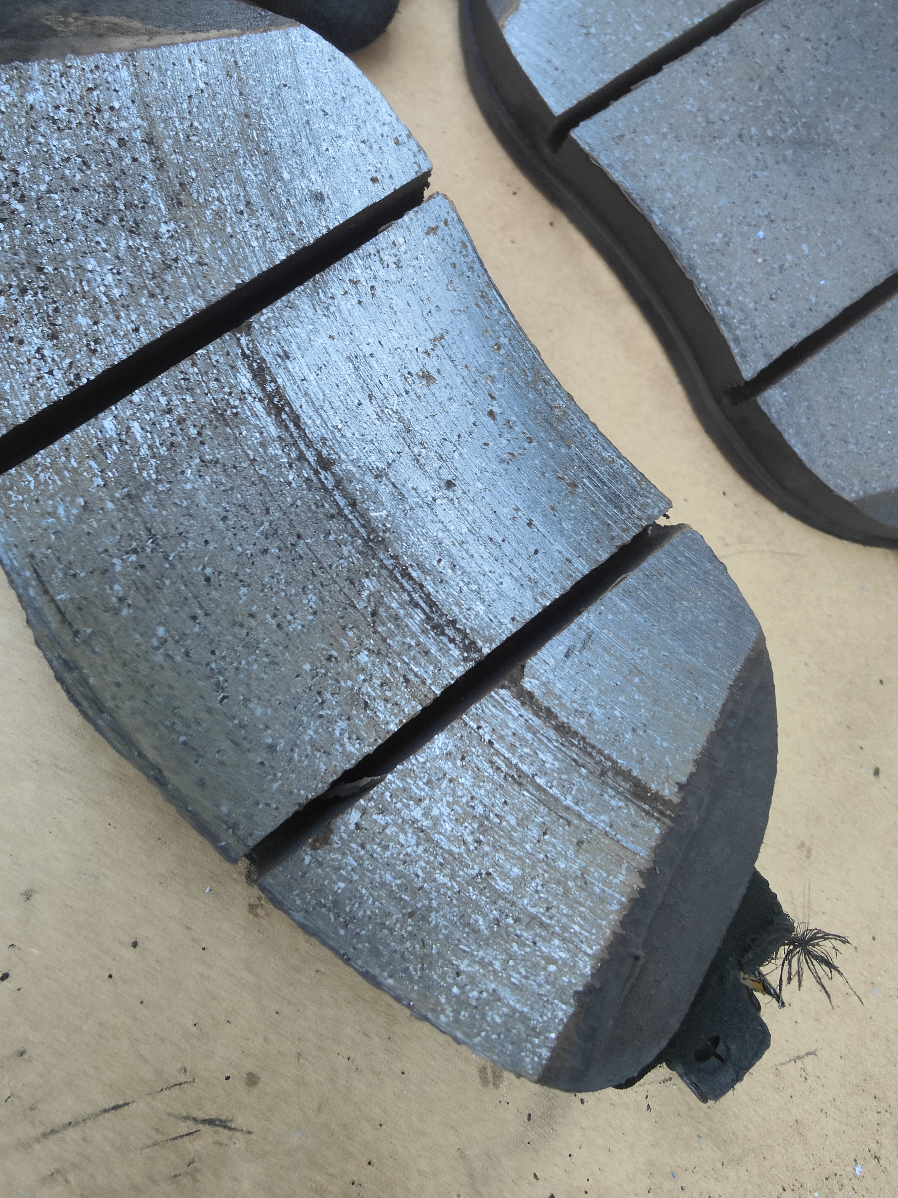

I currently have the front brakes off as I haven't revisited them yet since initially changing them. I think I have found a issue but not sure how or why it's happens.
The front left outer pad has a large score mark in the centre of the pad. I don't understand what could have caused it as I couldn't see any trapped between the discs and pad?
Probably a small stone or piece of grit that caused the groove. It will be long gone now. I doubt it will cause any problems with brakes and should wear out eventually.
